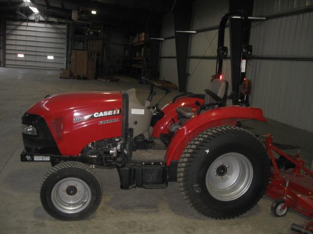

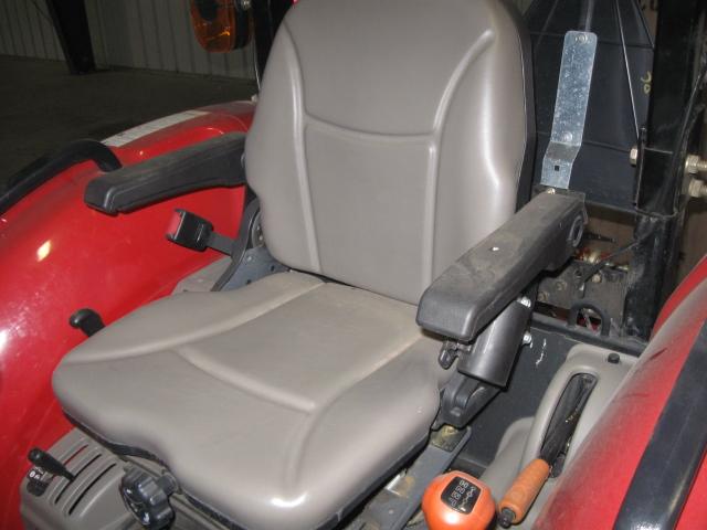

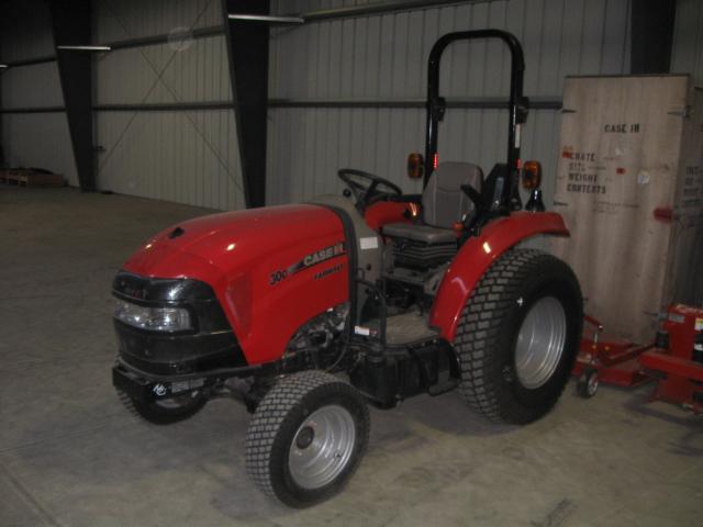

Here's the pictures of the Case I was sent from the seller. It's sitting in a warehouse in Minnesota:
fileHandlerServlet3TOUELAA.jpgfileHandlerServletUBEUT0BI.jpgfileHandlerServletZ1BD3NLF.jpg

The RFM is actually the Case 72" (the MW172S I believe) mower which may bring more appeal upon sale as both the RFM and the Farm King Y660 have less than 50 hours on them. Both were new units with the tractor. We'll see. I fear you're probably right though that I may get less than I hope for the attachments. I get my first view of the Case 30C and attachments on Monday or Tuesday. If it's not all it's described as, I'll go take another look at the 4210. Otherwise, I may just sit a be patient for a bit as the weather continues to cooperate. If I get something, I'll post pictures.
View attachment 449398View attachment 449399View attachment 449400
Generally speaking, RFMs that are labelled with brands like Case, NH, LS, Kioti, etc, are made by companies that supply identical units to lots of companies. Companies like Pittsburgh/Taylor specialize in this. I've seen the same RFM on the same trailer being delivered....some had blue paint and some had orange paint....they were getting LS and Kioti stickers. They're decent mowers, but don't demand premium prices. I did a quick Google search and only found one example of that mower for sale which means they aren't common.
If it was from one of the big implement companies like Land Pride, Woods, Sicma, Caroni, etc, you might get a few more bucks for it.
Similarly, with snow throwers you're looking for brands like MK Martin, Lorenz, Erskine, Pronovost, Lucknow, and Normand to command a premium.
That's not to say the RFM and snow thrower with the Case are bad, it's just they aren't as likely to get you the extra $ when you go to sell them.
Regardless of all that, the tractor certainly looks clean, so that's a good start. Since it doesn't have a loader many of the most common problems with used CUTs aren't likely a concern (front axle issues from improper FEL use). It would be pretty hard to do much damage to that machine with just an RFM and a snow thrower, so I'd put that down in the plus column.
