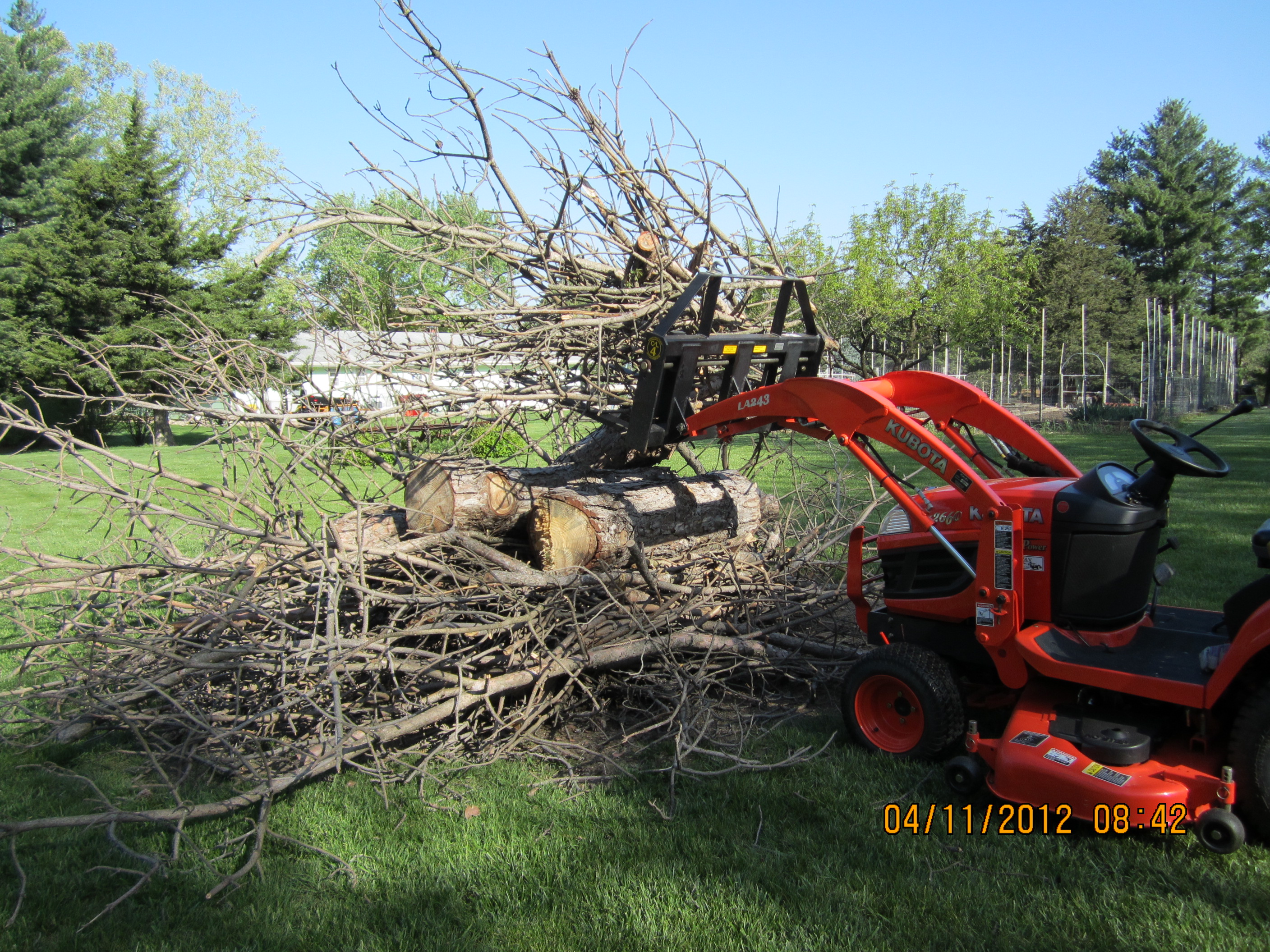

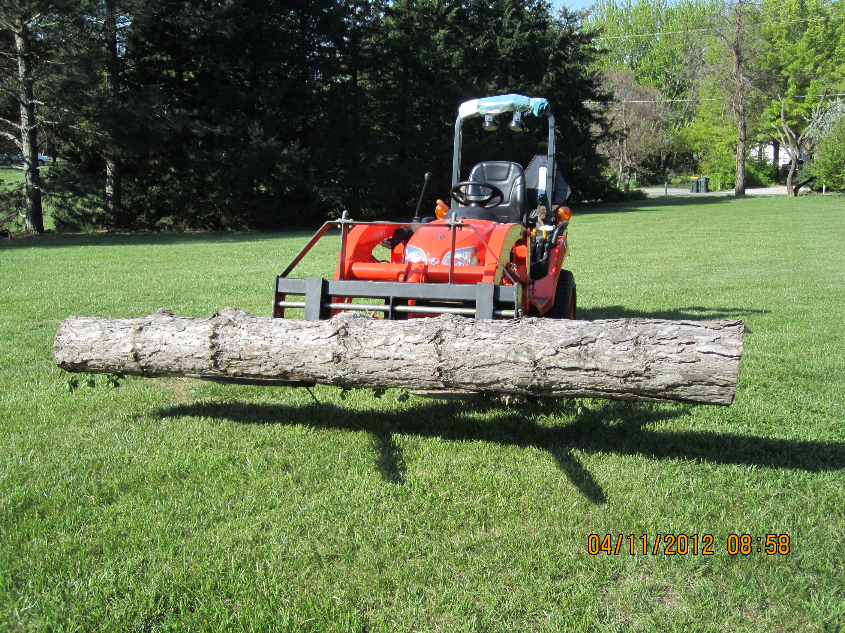

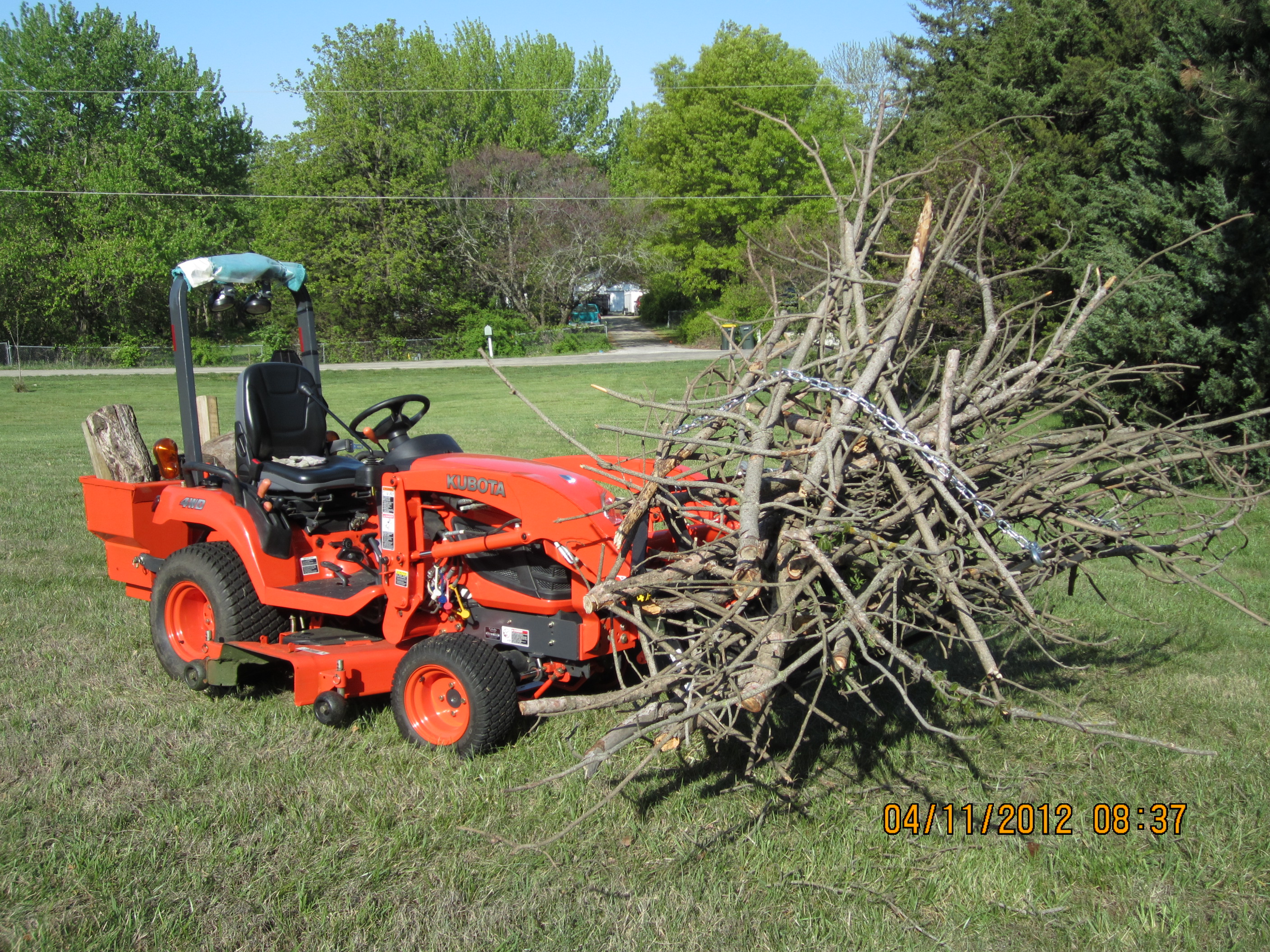

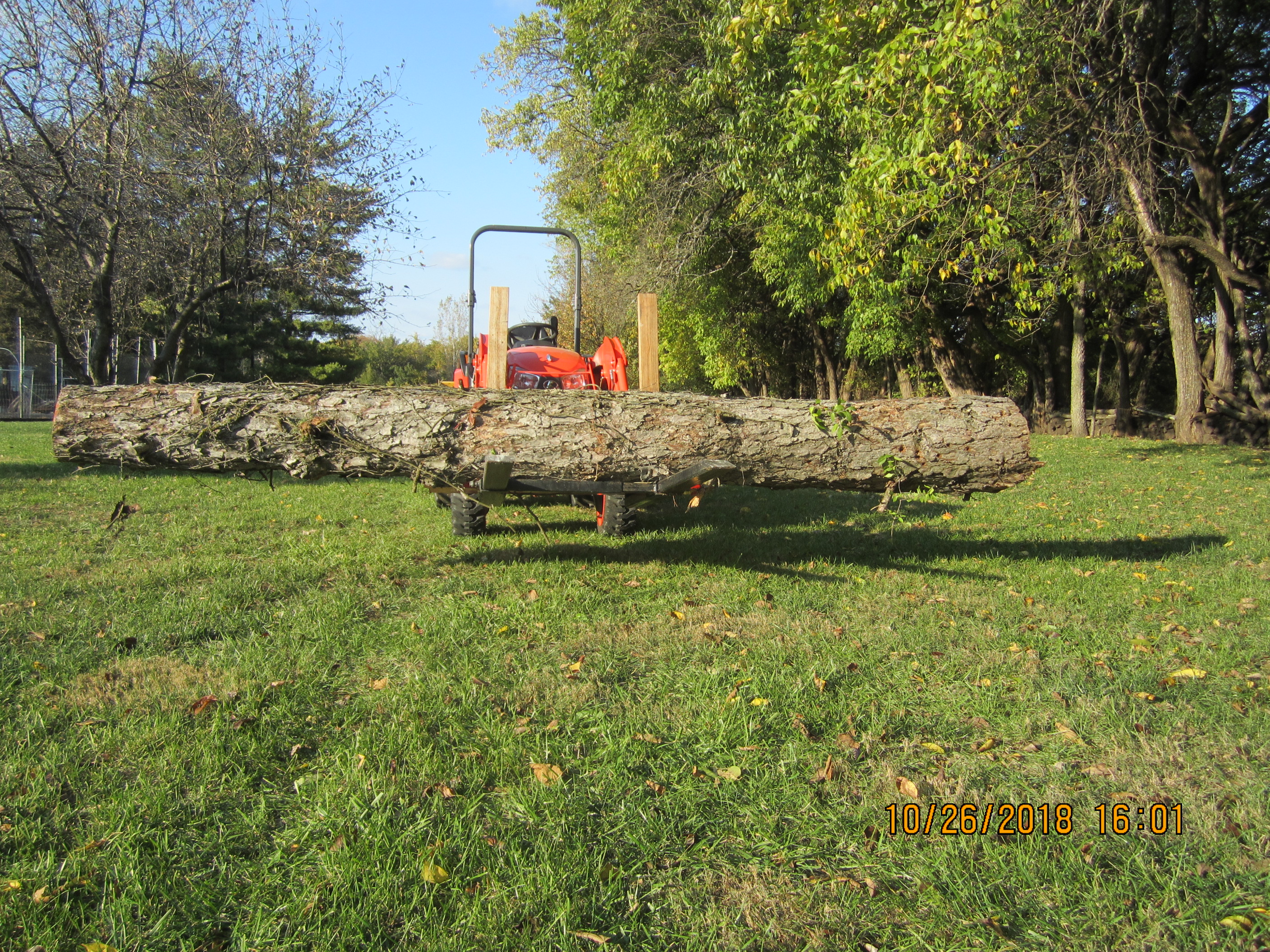

I've never owned a grapple and am not sold on its utility at my place. I'd say that using some model of a pin on fork is the best option. I say this because I really doubt that a grapple will pick up all the debris that I accumulate dropping dead pine trees. I really don't mind lifting my butt out of the seat to load the FEL/pin on forks. Even a dedicated Pallet Fork might even be better....viz..no third function hydraulics.
   / Buying my first Kubota - education needed! #30
See these pics of a Kubota "B" model and a "BX" model.View attachment 591593View attachment 591594
View attachment 591595View attachment 591597View attachment 591598
how do you attach the pallet forks on the tractor in the middle picture?
