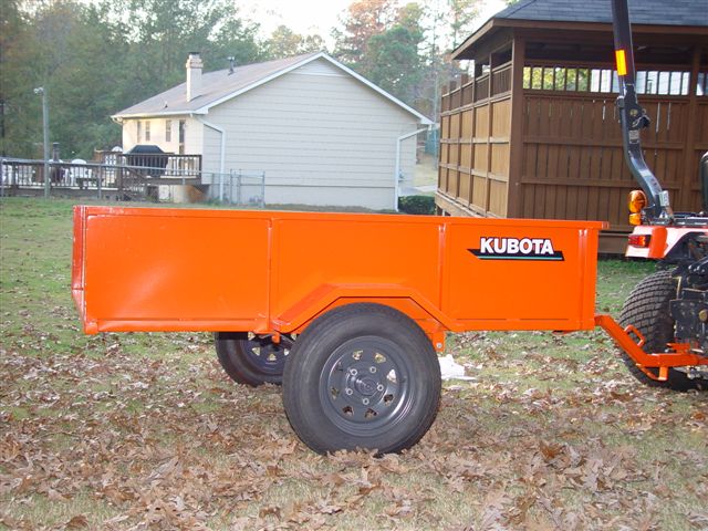

Completed BX Trailer
Here is a few pictures of the completed BX 22 trailer.
The internal dimensions of the bed is 4 Ft x 6 Ft.
Trailer sides and floor is made out of 1/8 steel plate. The side frame is made from 1 in square tube. And the trailer frame and Tongue is made from 2 in square tube.
The tailgate is removeable by sliding it up out of it's holding channel.
Please note the drop tongue, this allows for level towing.
The trailer axle is the leaf spring type, rated at 1100 pounds, the axle and tires are both highway speed rated. the trailer can also be used behind a small car for quick trips to pickup landscape materials.
I wish I could take credit for this superbly crafted poject, but the credit goes to my brother in law........an extremely talented if not gifted craftsman to whom I will always be thankfull.

Trailer decorated for Halloween
We all had a great time, I pulled at slow speeds, 5 adults and 4 children thru the area trick or treating.
The kids and adults all thought it was a great idea. We plan to make it part of every Halloween.

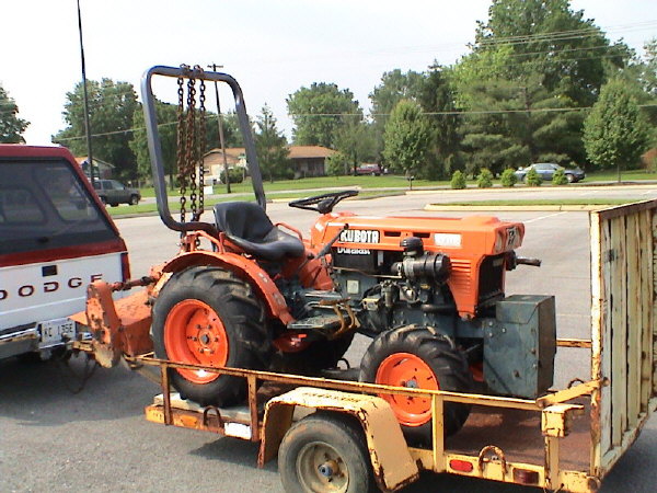

GregW,
I guess it depends upon what tasks you have in mind for the trailer. I would think that obstacles in the path of where you are planning to tow the trailer would determine the width.
I took the route of purchasing a road-worthy small trailer. It is small enough to use behind my tractors and yet can still be towed behind my car and/or truck if needed.
Attached is a photo of my trailer. It was an equipment trailer (2200 lb rating with a torsion axle) that a local rental company sold me for $225. The photo shows my old B7100 & tiller loaded onto the trailer (mid-mower removed). I'm pretty sure that a BX will fit on the trailer also with the mid-mower removed.
As I look at the photo I have no idea why the chain is hung over the ROPS.
Kelvin

Re: Completed BX Trailer
That is a beautiful little orange " Kubota " trailer. I like the
metal bottom and the metal sides. Your bother in law is a good welder and designer. I an still looking for a trailer for my kubota to haul and for a trailer to haul my Kubota. Thanks for sharing David

Trailer Construction
Yes, the trailer is very well built of quality materials. I plan on having it for at least 20 years. The leaf suspension really gives it a smooth ride for the kids, and the turn radius is as tight as you want to turn, all in all a really good design.
I'm fortunate to have a welder/designer in the family.
Greg

Re: Trailer Construction
Could you post some of the dimensions and construction details? thanks....
Yes,
I will take more photo's showing the construction in greater detail. I't dark already here, but I will try to get home earlier on Tuesday and get a few more pictures.
Greg
/ BX 22 Rear Trailer
#14
Hello,
Sorry for the long delay in getting the dimensions, but maybe you still will find then useful.
Outside dimensions
Length-73in
Width-50in
Trailer sides-16in tall
13in wheels
Tires-5.30-12 maybe I mis-measured the rims, they may be 12in as well.
Inside dimensions
Length-70 1/2in
Width-48in
Tongue-approx 36in long with 9 1/4in drop
constructed from 2x2in square tube. Tongue angled braces are 1 1/2x1/2in square tube.
Vertical side supports are 1x1in tube
Sides and floor are 1/8 metal.
Hope this is helpful
Greg
