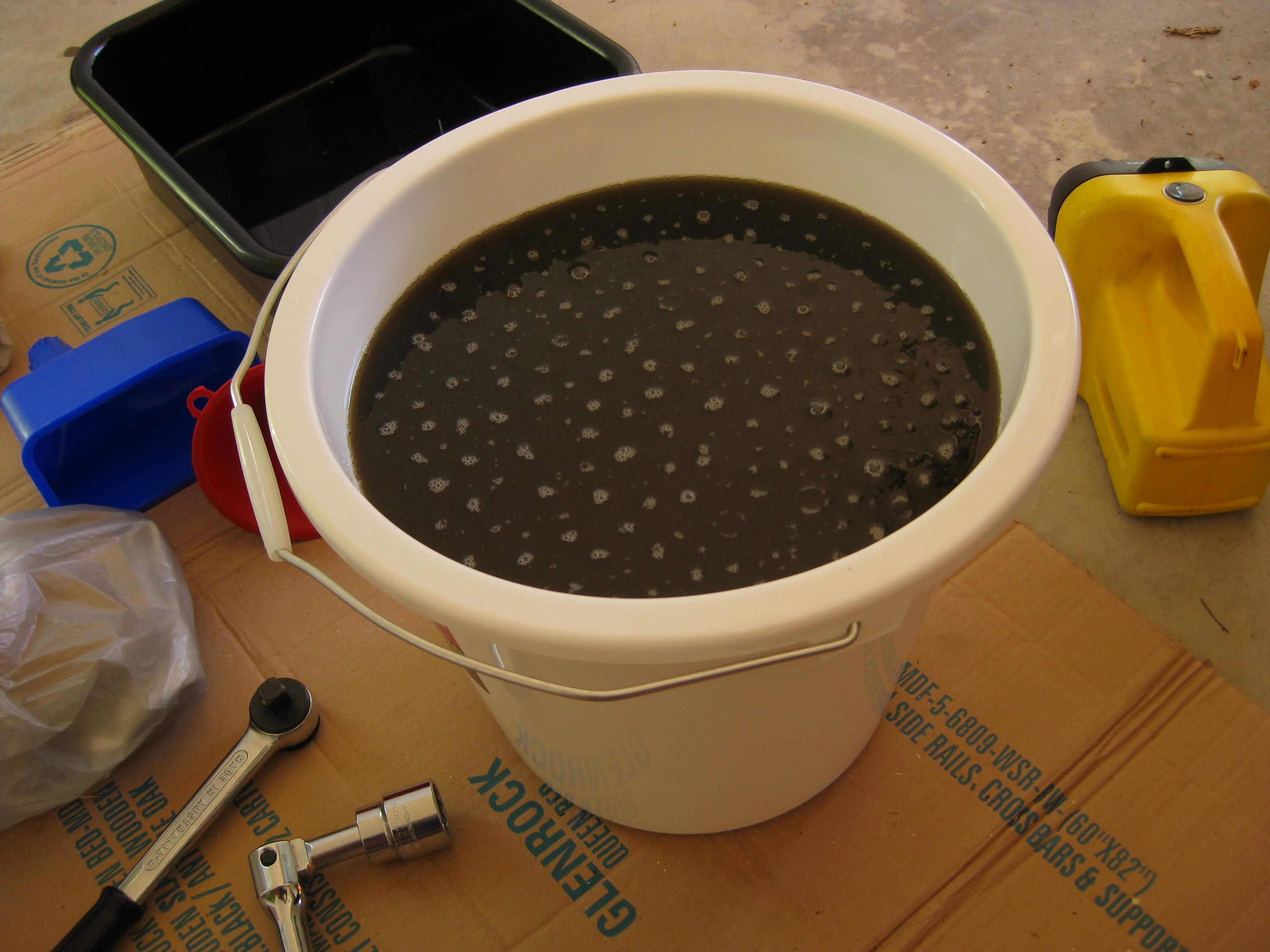

   / BX-24 brake adjustment #13
Al ,
The transmission filter is about 35 micron ( for high flow rate ) and
I don't honestly think it holds small particles . Below is my old
oil ( yuck ! ) and that was being pumped around and through
the filter . Engine oil filters are are about 8 micron ( low flow
rate ) and do have a benefit . Do bear in mind that trans oil
is also a moisture absorber too , and a couple of years is
enough IMO .......

@OrangeRidge: Is the photo UDT or engine oil? I'd be terrified if that came out of my transmission!
