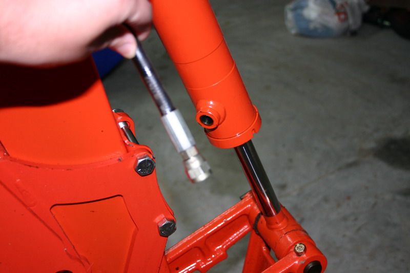

I don't quite get it. I have the same setup and havent seen the fitting of which you speak. Can someone post a pic?

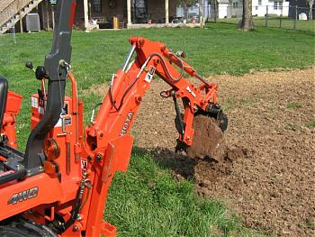

So far I've had no problems or issues with my Bro Tek thumb. It's been one of the handiest implements I"ve added to my BX23.

I'm at work so can't take a picture better than what I have here. I took this just the other day so that I have a record of things. The hose I'm holding normally has an elbow adapter, and this is what hits the thumb bracket that you see in the background. For me, this happens when I fully curl the bucket. From the natural geometry of how things move, the cylinder hugs in close to the dipperstick and crushes the elbow adapter. I ordered a dozen spares to have on hand as I figure out how to get around this. Maybe I'll take escavader's advice and use this as my excuse to get a welder. :D

It doesn't matter if the thumb is up or down. When you open/uncurl the bucket to its greatest point, the elbow connector is pushed into the bracket holding the thumb onto the boom. There is only a small area of play maybe 1/2" to 3/4" where it won't hit the elbow or bind at the lower edge. The best bet would be to weld it so it can't move. I got it in that spot but as soon as I put hard pressure on it it slid back up.
The BX 24 elbow on the cylinder is located closer to the boom than prior models, say 4:30 vs 3:00.
My dealer picked up my BX today. It looked like the cylinder threads were damaged by the break, I bought it with the thumb on it so I can let them deal with it. I felt fortunate they put it on.

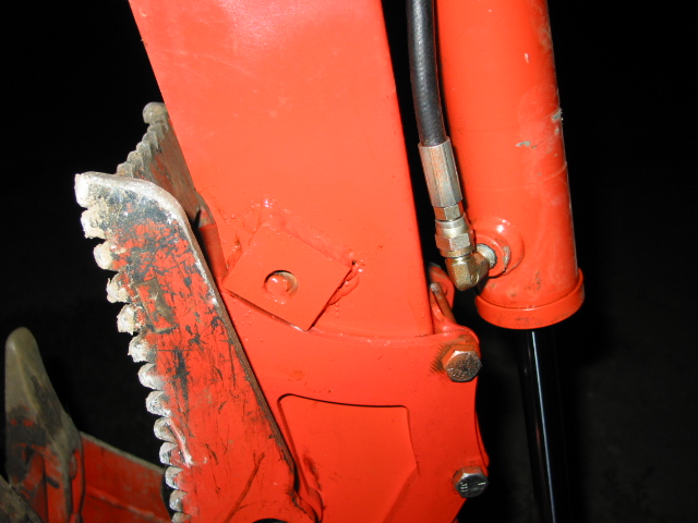

Went out and snapped a pick of the Bro Tek thumb mounted on my BX23's dipperstick and when compareing it against the pic by Rayco, one visably huge difference between the BX23 & BX24's dipperstick is in the position of where the fittings mount on the dipperstick's ram.
On the BX23 the fitting appears to protrude out from the ram at a 90 degree angle to the dipperstick whereas on the BX24 the fittings appear to be closer to a 45 to 60 degree angle which puts the fittings dangerouely closer to the thumbs mounting brackets. On the BX23 theres a couple inches of clearance.
A lesser appearant difference is how the Bro Tek thumb mounts to the dipperstick. The taper on both dipperstick's is such that it will not allow the Bro Tek thumb to slide any further back once it's fastened down. When the upper and lower bolts are fastened securely there will be no further movement of the thumb bracket due to their spacing.
There may be more differences but it's hard to tell. But from the pic's it seems the main difference is in the rams and at what angle the fittings fasten to them.

Prior to having the dealer pick it up for repair, I cranked the thumb bolts as tight as I could get them and it still slid back up. I had marked the safe spot on the boom, checked it, went to move 1 rock (probably a couple hundred pounds) and it slid up and I snapped another connector.
This was the dealers' fix for the sliding thumb. By putting the stops on it, both sides (as oppossed to welding the thumb itself) I can still remove the thumb but it doesn't slide up.
Worked it hard today and didn't have to worry!
So definitely weld.
I think if you drill a hole you would need to reinforce it or it would elongate with hard work. You may be able to see the wear spot in my boom about 1-1/2 inch above the thumb it is abot 1/4" deep from the thumb movement prior to the stops being added.
BTW- Dealer picked it up Wednesday, brought it back on Thursday. No charge!
