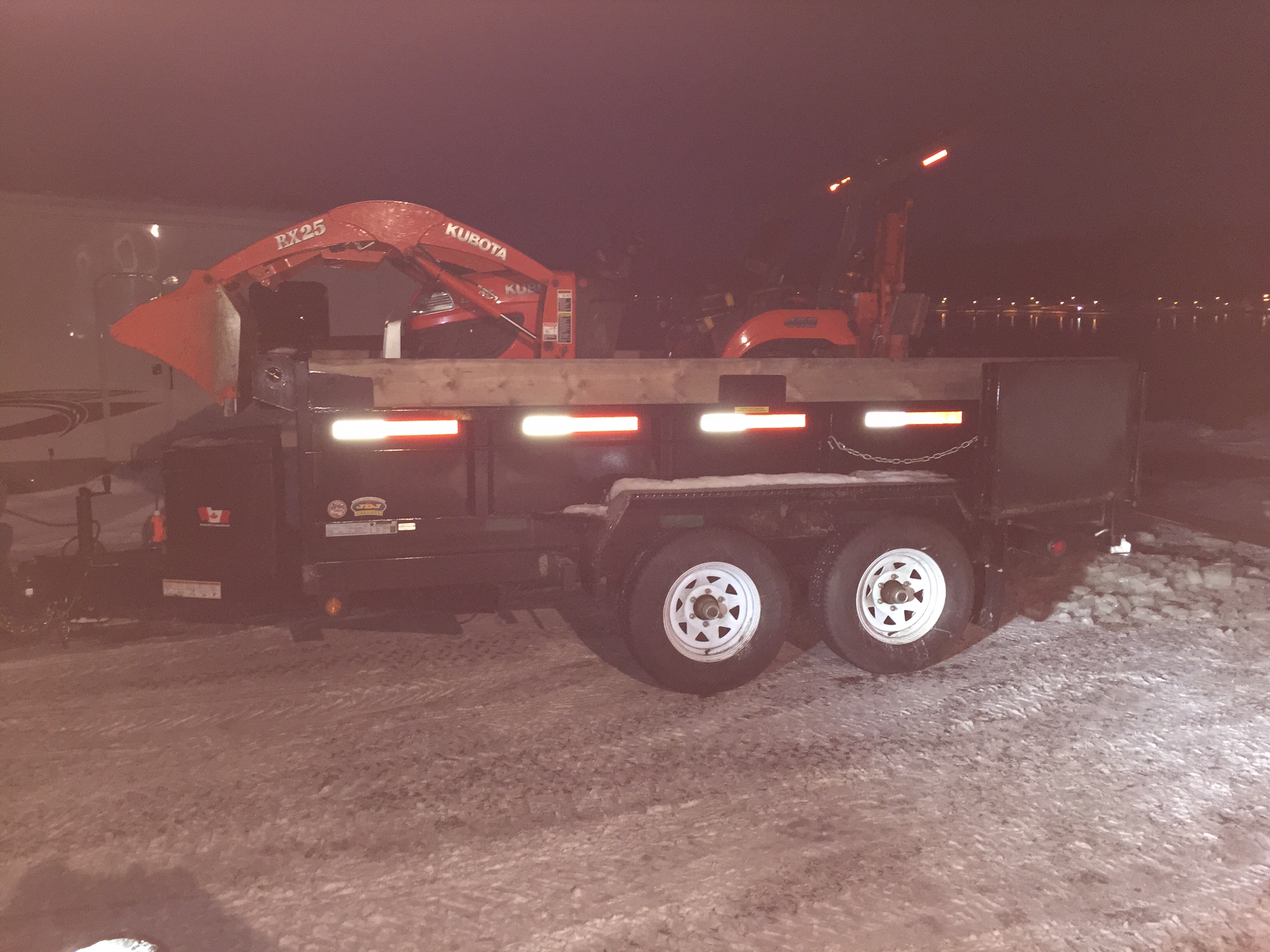

single axle and a hitch extension? Do you have a death wish!:stirthepot:

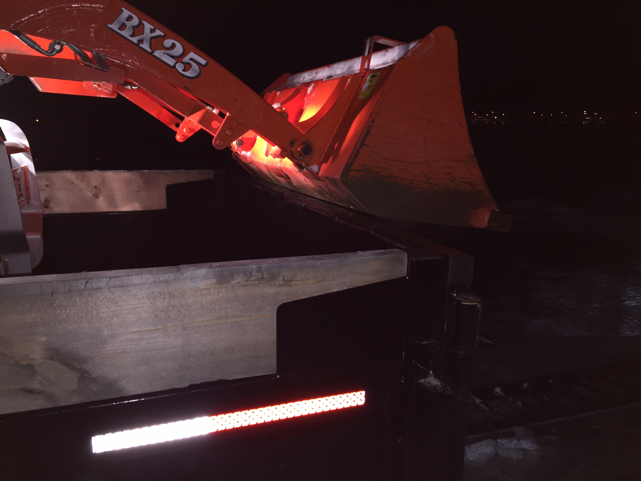

So the corners of the bucket don't dent the tailgate on corners? :D
Don't think you have to worry, it probably won't be still attached by then if you get the CG of the tractor forward enough. :)

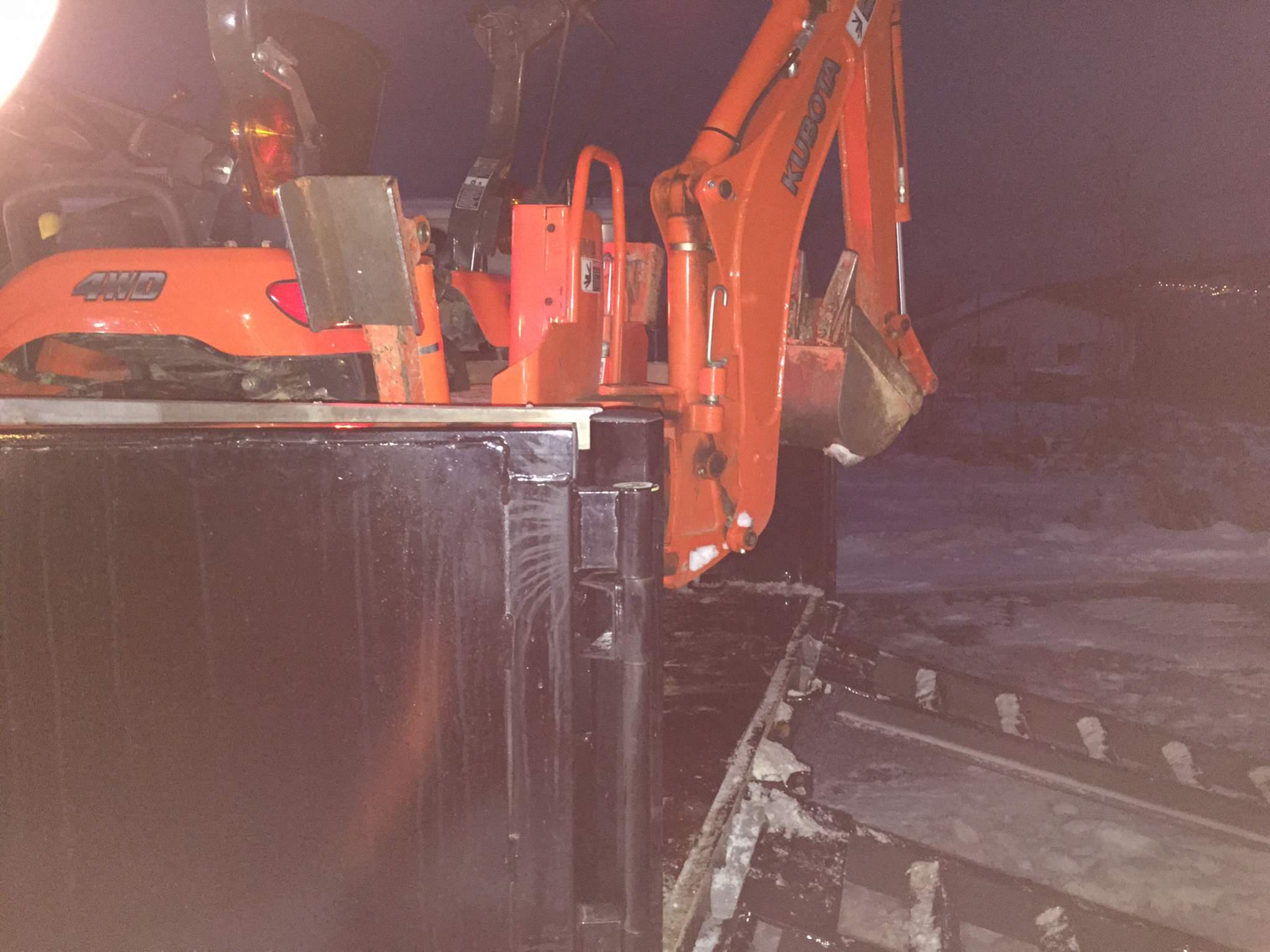

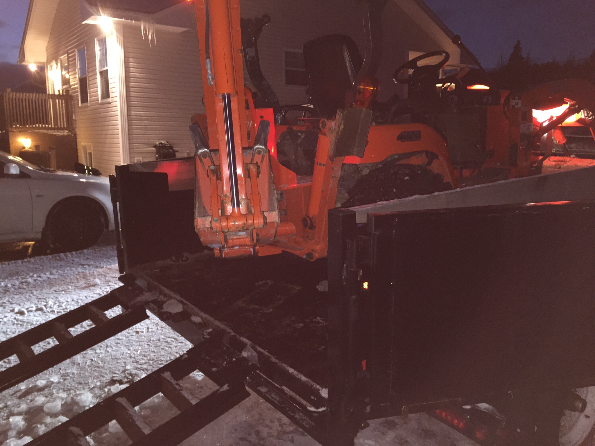

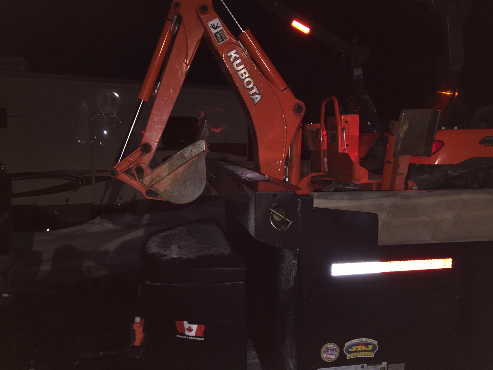

Man, you guys must have awfully wimpy steel out west if you can'd handle this load. On the other hand, it may be a Canadian thing. Everything is tougher up here than in the U.S. - like our hockey players!:laughing:

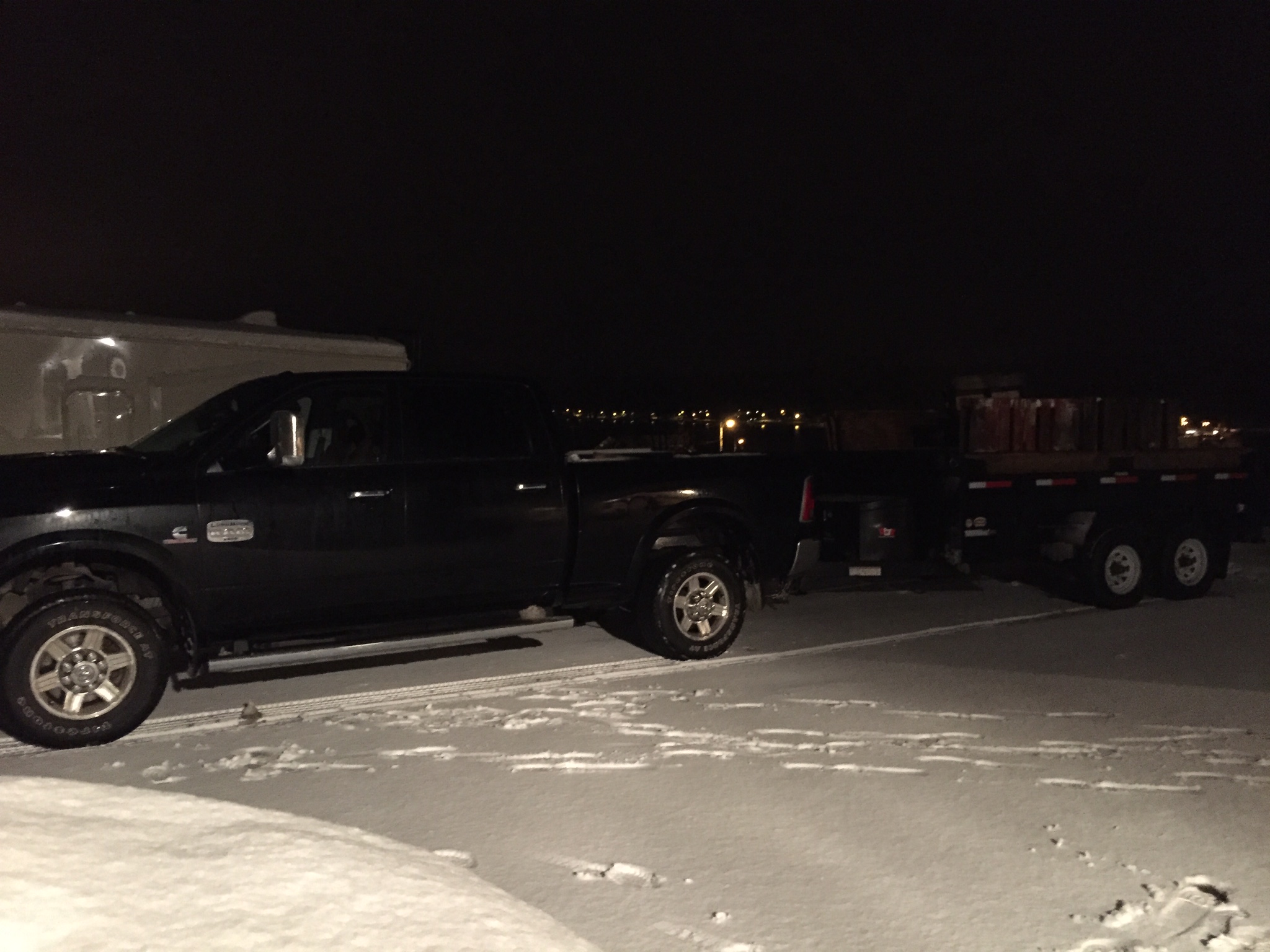

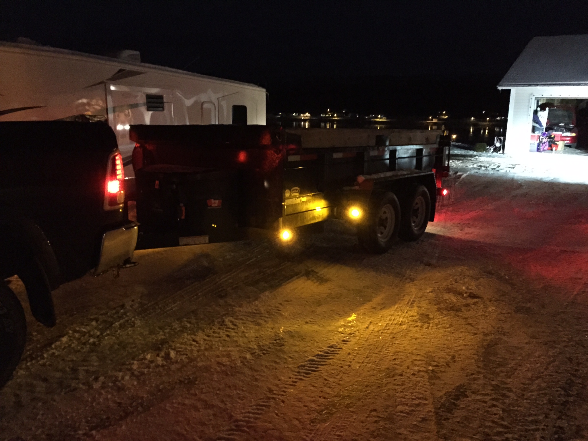

Nah... just giving him a hard time. But you have to say... the bending and/torque on the connection on the truck is not how you want to design it. Better to have a longer extension on the trailer side if you need to drop your tailgate when attached.

Actually, I wish the trailer front was a bit longer, as I cannot normally drop the tailgate down without it resting on the top of the trailer jack. A bit of a bad design.

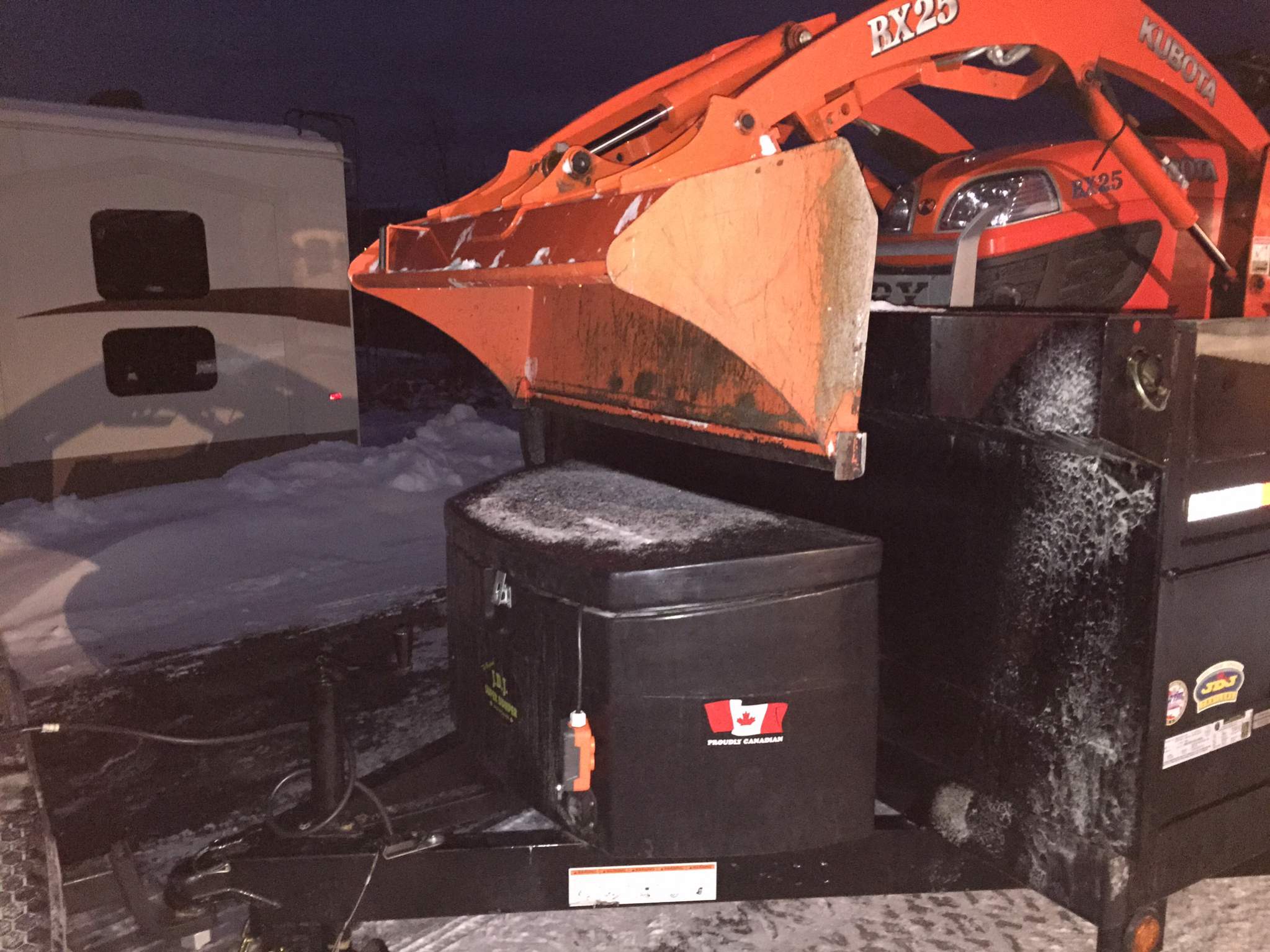

Anyway back on topic. In your picture, what to you rest the FEL on when travelling.....anything or just locked in place with hydraulic pressure. I am a little concerned about the FEL damaging the tarp kit with it stored like that. What are your thoughts, I would say its ok if you are using it like that. I was thinking maybe getting some sort of resting cradle made up that is welded to the from A arm of the trailer and lowering the FEL in it. Do you think this would be necessary.

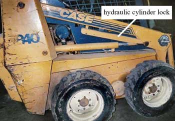

What you need is something like this to keep the loader from leaking down.
https://icontent.toro.com/smartmanuals/Dingo_525/Proc20124.htm
OMT166698 K0: 310G Backhoe Loader, Block File: CED_OUO1079_422_19_10JUL00.htm
There are also cylinder locks that slip over the rod end of the cylinder to hold the loader up on machines that do not have the built in boom lock.
