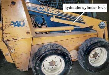

Anyway back on topic. In your picture, what to you rest the FEL on when travelling.....anything or just locked in place with hydraulic pressure. I am a little concerned about the FEL damaging the tarp kit with it stored like that. What are your thoughts, I would say its ok if you are using it like that. I was thinking maybe getting some sort of resting cradle made up that is welded to the from A arm of the trailer and lowering the FEL in it. Do you think this would be necessary.
What you need is something like this to keep the loader from leaking down.
https://icontent.toro.com/smartmanuals/Dingo_525/Proc20124.htm
OMT166698 K0: 310G Backhoe Loader, Block File: CED_OUO1079_422_19_10JUL00.htm
There are also cylinder locks that slip over the rod end of the cylinder to hold the loader up on machines that do not have the built in boom lock.
