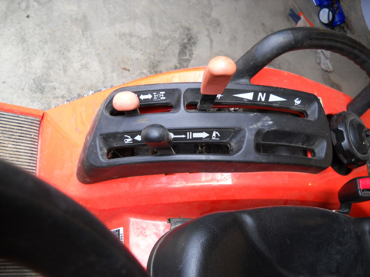

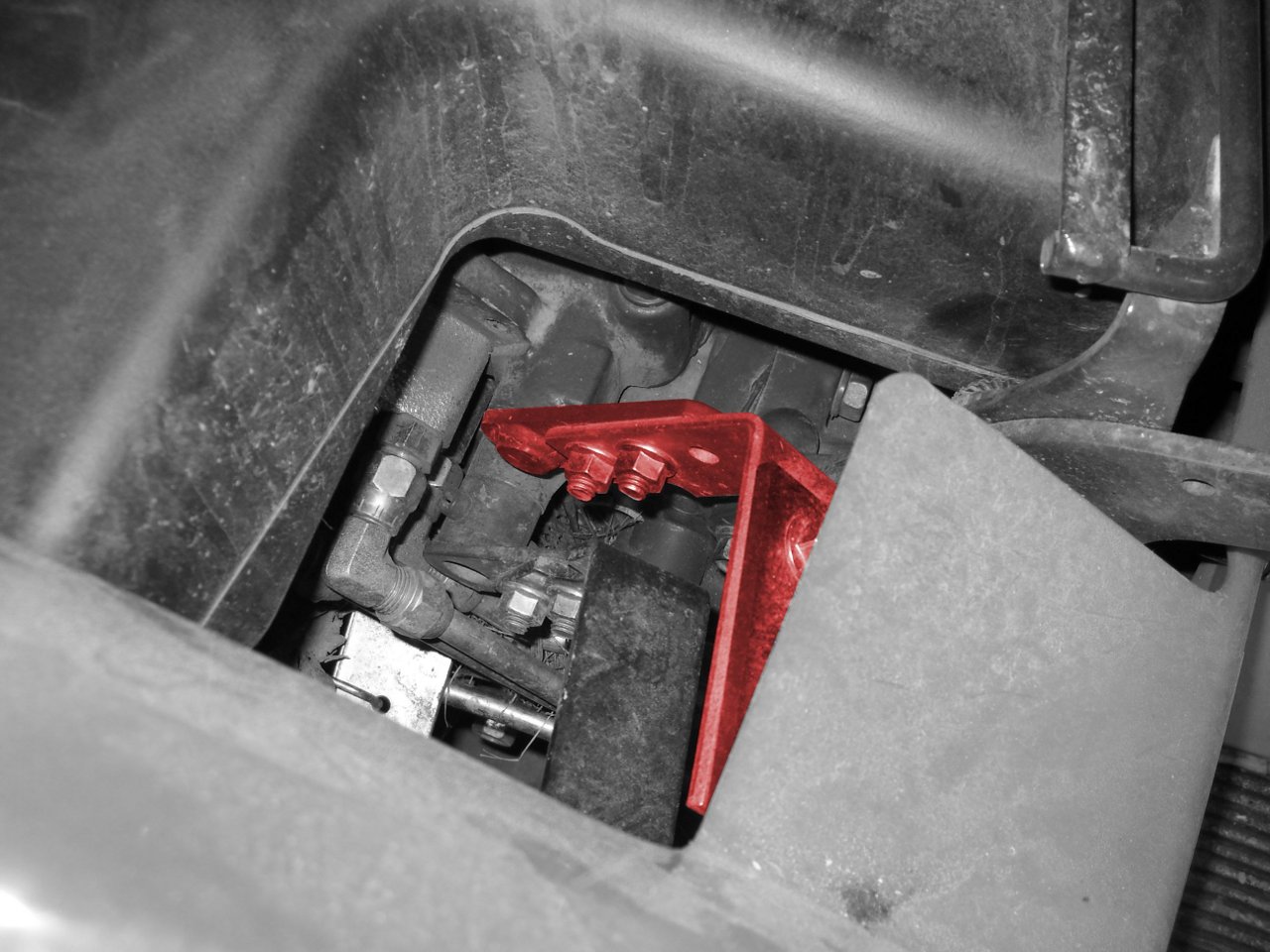

I think my BX may use a different system. Here's how my 3PH control lever works.
1. Above the right-side fender.
2. Under the right-side fender.
3. Control lever linkage connection at the transmission. I see no springs anywhere. Nothing is attached to the arm until it connects to the transmission.

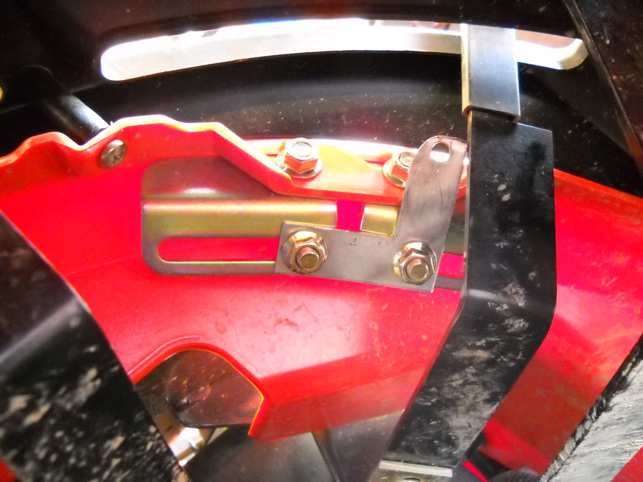

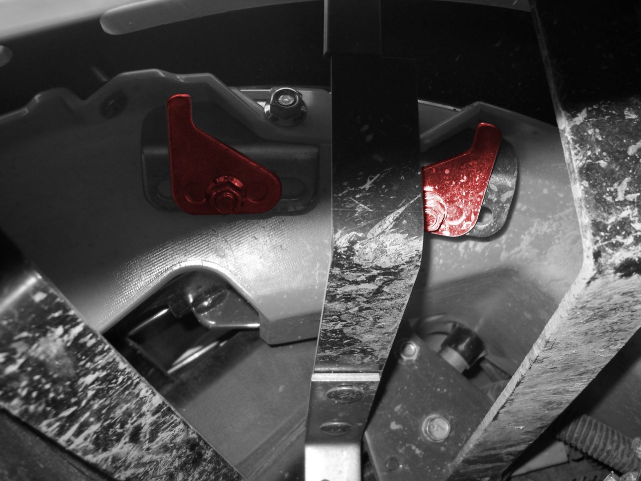

4. Here are some metal tabs that serve no apparent purpose. They sit just below the fender. It looks like I could swap the two tabs and pivot the front out a little. The play in the 3PH control lever (center in this shot) would be enough that I could hook it on the front tab and lock it forward. Then, with a nudge away from the seat, it would release.

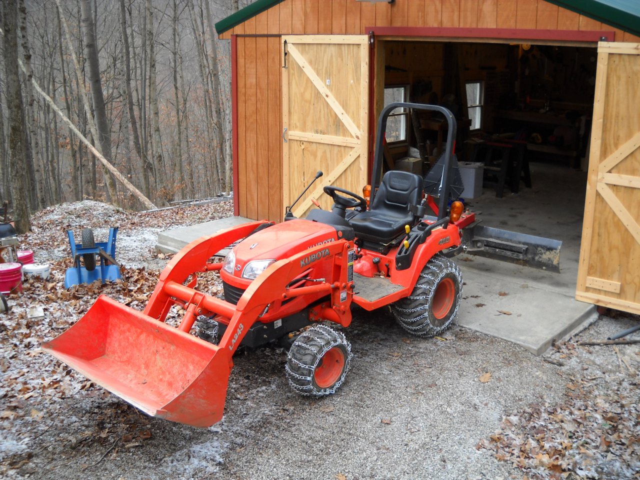

5. For good measure, here's the whole rig sporting its brand-spankin' new chains.

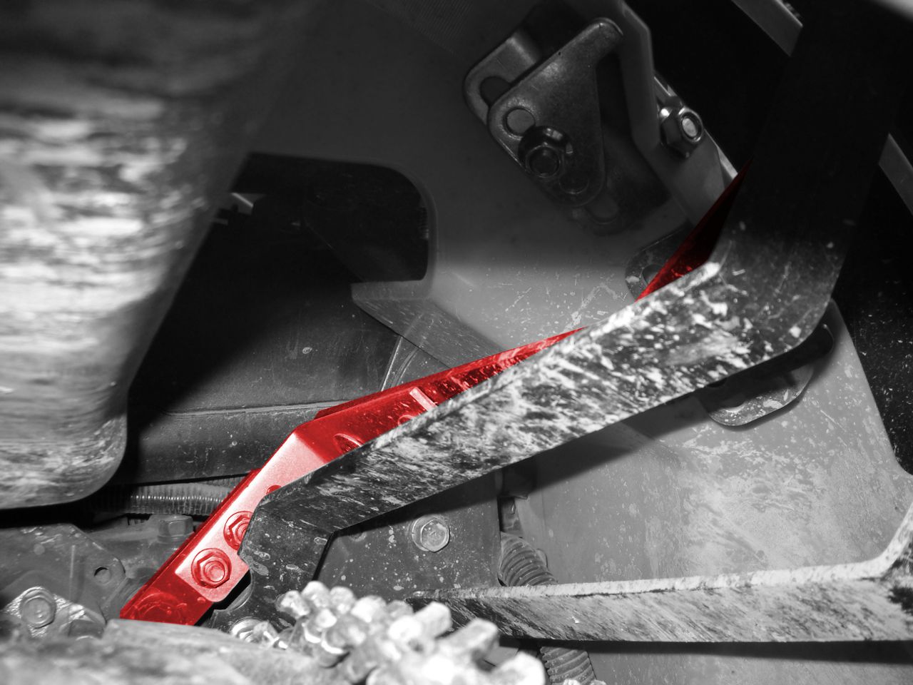

Dave if you have something similar to the part in the red circle, that's the adjustable linkage that has been referenced, that kicks the lift lever back to neutral, if you don't have that part, the newer models are different than my 2001.
The newer 50 and 60 series BXs (ie: BX2350, 2360, BX24, 25) have a different 3 pt than the earlier versions that Milkman illustrated. There is no linkage on the later versions.
The metal tabs mentioned above are components of the Quarter Inching system. The tabs limit the travel of the lever allowing a very small movement of the hitch. Pull the lever sideways in between the tabs, move it forward or backward to the stop and release. The hitch will move approximately 1/4".

milkman - I couldn't get a very wide shot because the blade was still attached. I didn't see anything like that. Thanks for the picture though.
Yes.. I turned that locking nut with a channel lock.
I always wondered what the "Quarter Inching system" was.
Doesn't that depend on the setting of the release valve? Anyway, I don't think I'm much interested in that feature. Those tabs are going to be re-purposed.

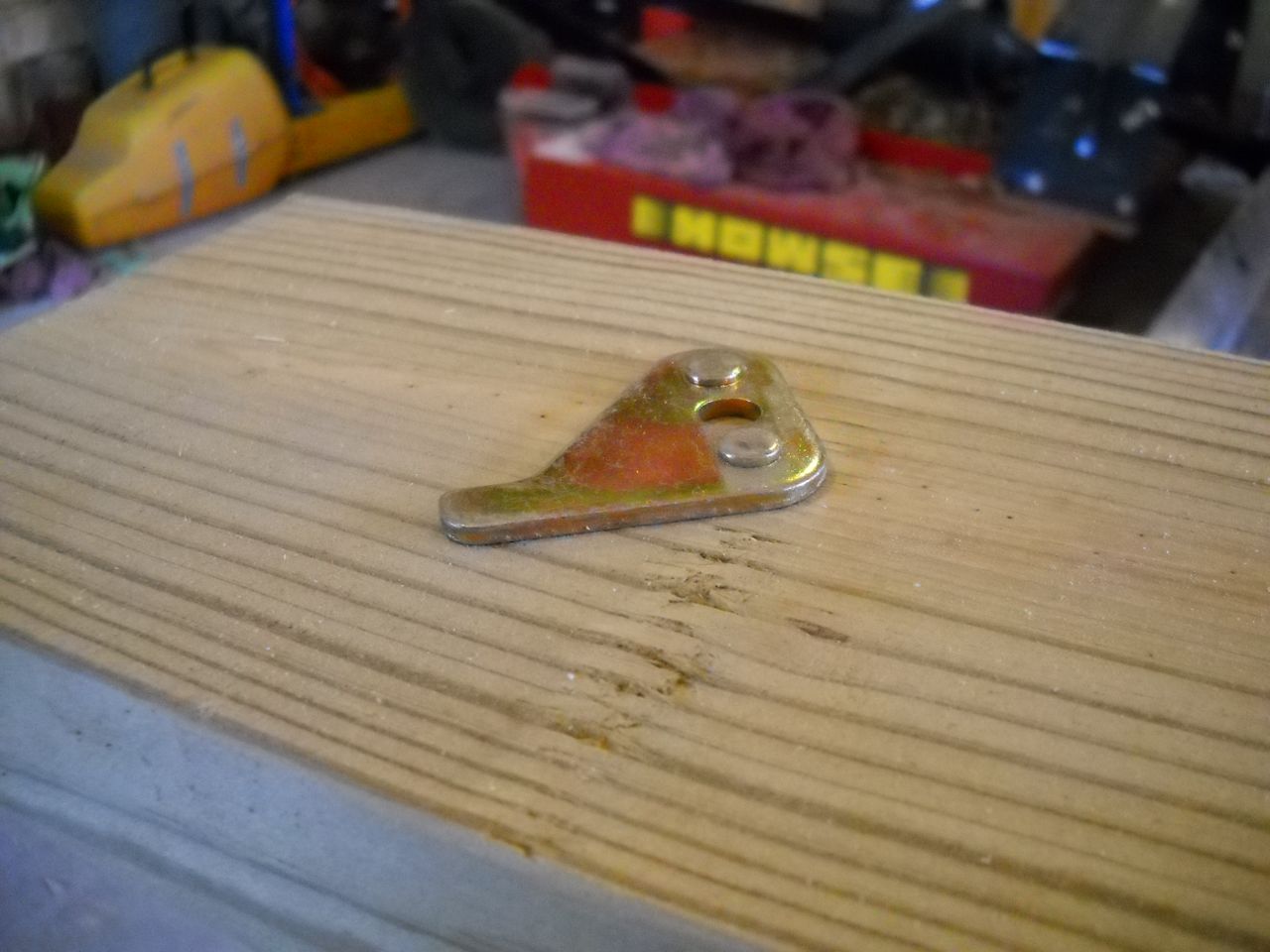

1. Here's one of the "Quarter Inching" tabs I had planned on using to create a locked-forward position for the control lever. It wasn't until I'd removed one that I realized the two circles surrounding the bolt hole weren't alternate bolt holes but rather partially punched cutouts designed to hold the tab at a right angle to its mounting bracket. Without those holes I couldn't get the tab to reach out far enough to catch the lever.

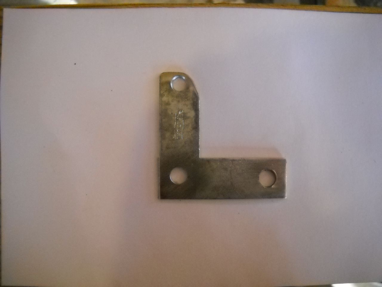

2. I cut and ground down a T bracket (didn't have an L) to make my own lock tab.
3. I removed both Quarter Inching tabs and used their bolts to mount my locking tab. Here it's holding the lever forward in the "down" position.
4. The view from above - holding the lever forward.
It works nicely. Pretty smooth operation although I don't know if it will pop out when the ride gets bumpy. The tab can be fine tuned by bending it up and down a little bit.
