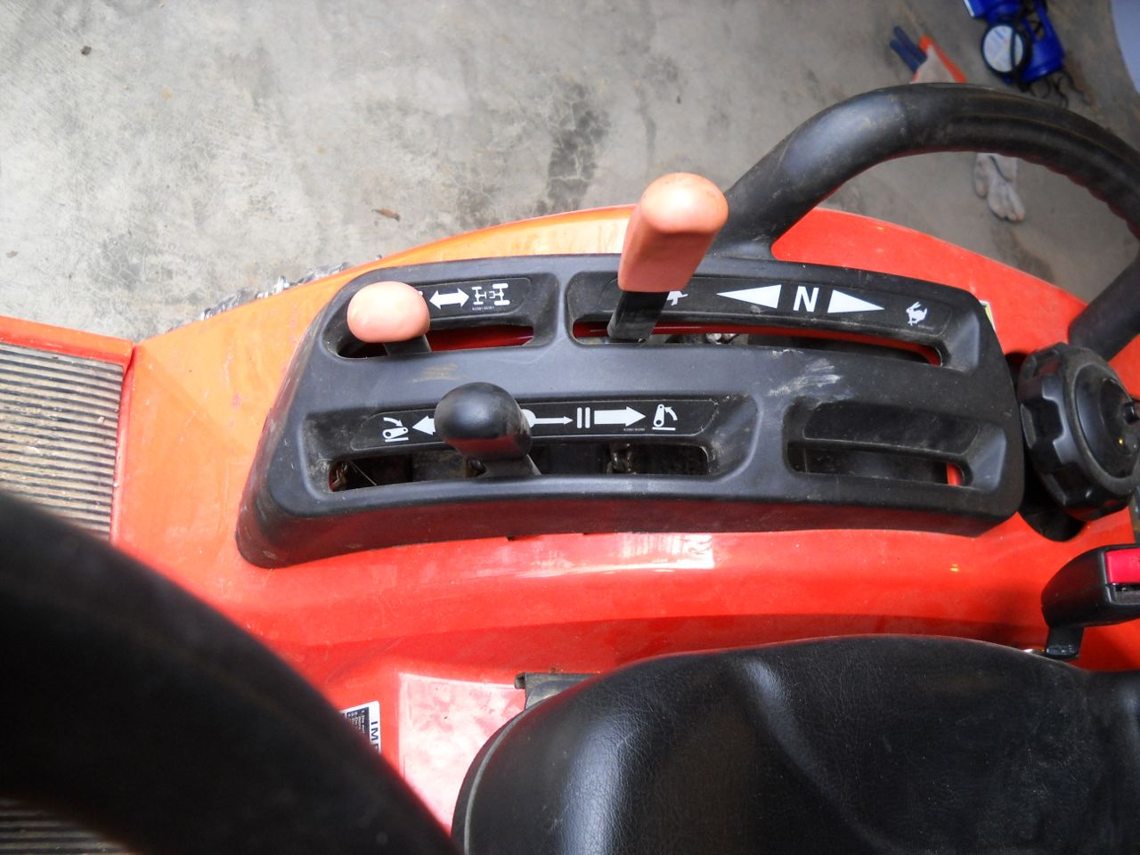

I think my BX may use a different system. Here's how my 3PH control lever works.
1. Above the right-side fender.

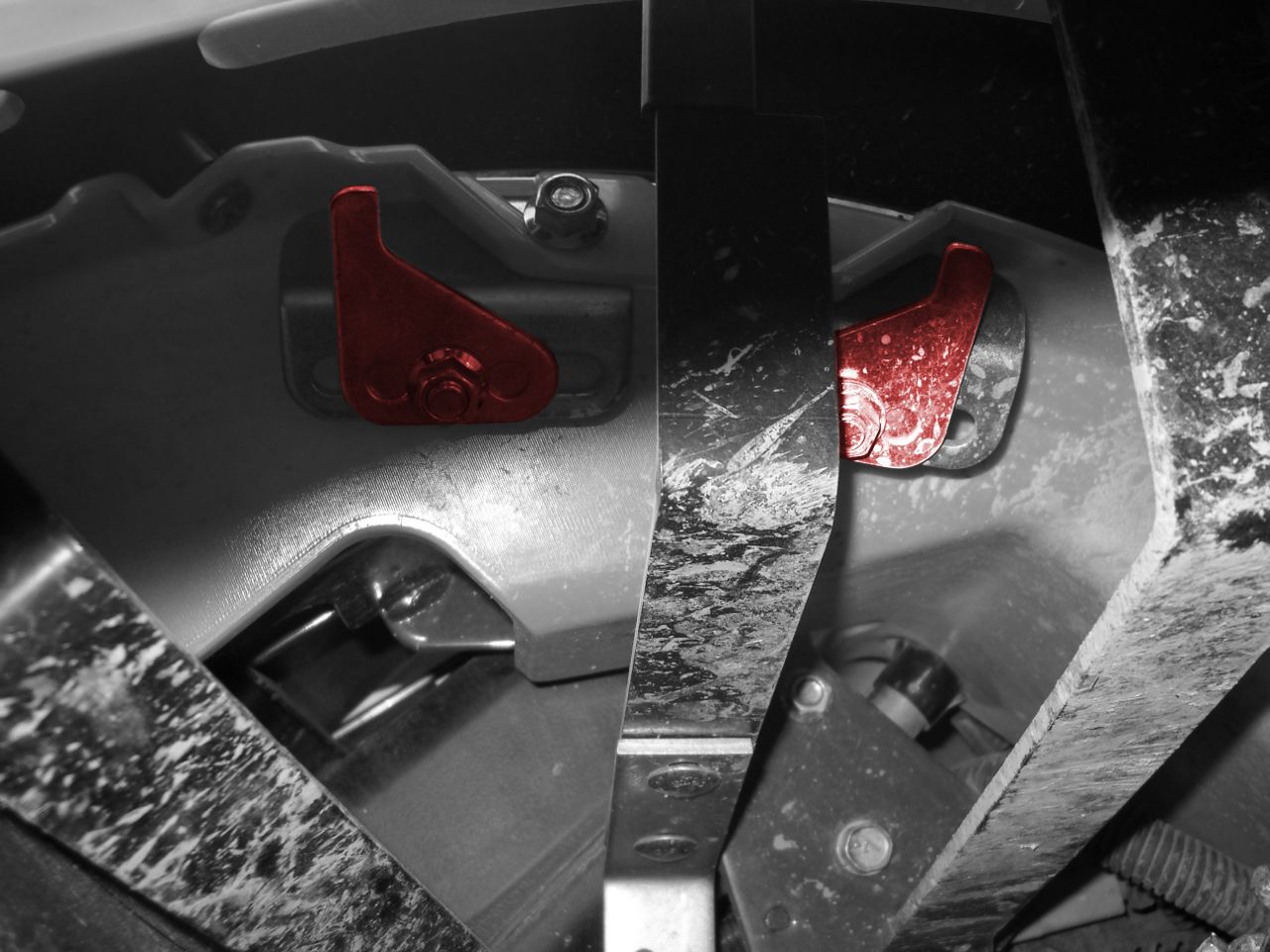

2. Under the right-side fender.

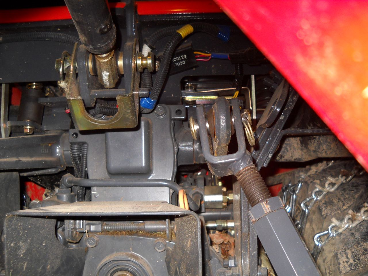

3. Control lever linkage connection at the transmission. I see no springs anywhere. Nothing is attached to the arm until it connects to the transmission.

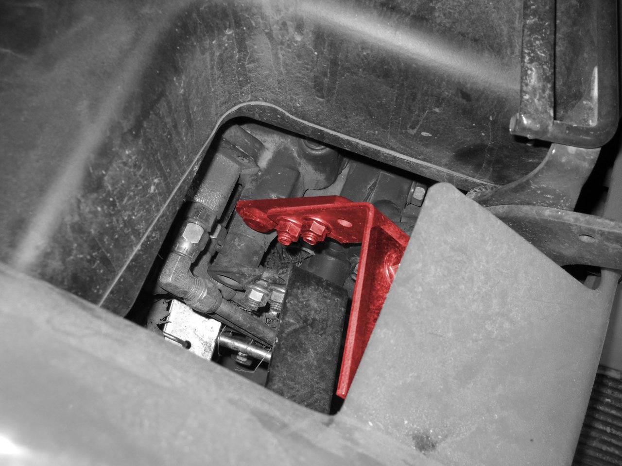

4. Here are some metal tabs that serve no apparent purpose. They sit just below the fender. It looks like I could swap the two tabs and pivot the front out a little. The play in the 3PH control lever (center in this shot) would be enough that I could hook it on the front tab and lock it forward. Then, with a nudge away from the seat, it would release.

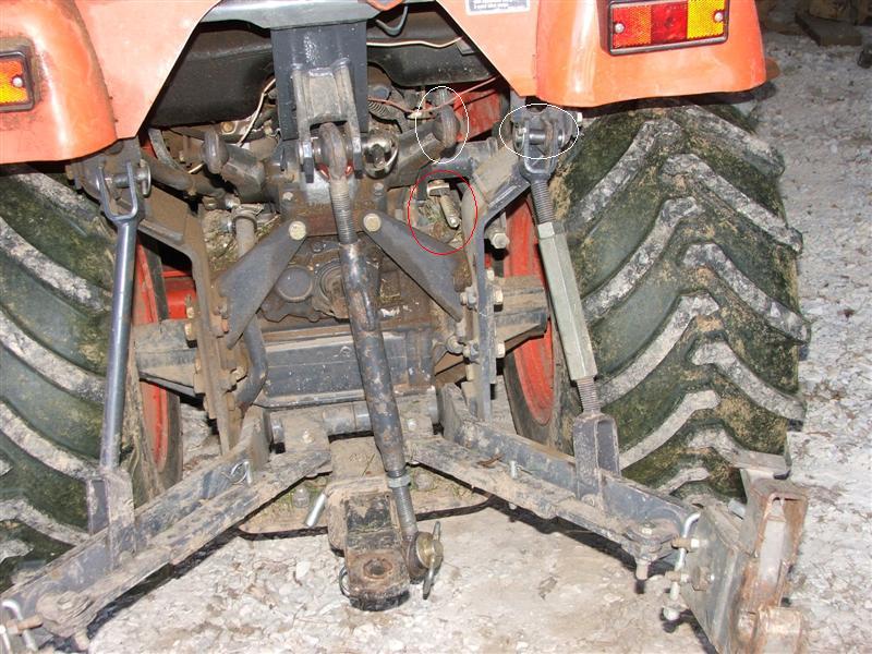

Dave if you have something similar to the part in the red circle, that's the adjustable linkage that has been referenced, that kicks the lift lever back to neutral, if you don't have that part, the newer models are different than my 2001.

The newer 50 and 60 series BXs (ie: BX2350, 2360, BX24, 25) have a different 3 pt than the earlier versions that Milkman illustrated. There is no linkage on the later versions.
The metal tabs mentioned above are components of the Quarter Inching system. The tabs limit the travel of the lever allowing a very small movement of the hitch. Pull the lever sideways in between the tabs, move it forward or backward to the stop and release. The hitch will move approximately 1/4".
I always wondered what the "Quarter Inching system" was.
Doesn't that depend on the setting of the release valve? Anyway, I don't think I'm much interested in that feature. Those tabs are going to be re-purposed.

I case anyone has a BX2200 with the same issue, here is a picture from above with the seat tilted forward. Gas tank on the right, 3PH arm just above the springs in the photo.
The front-most spring is the down return, the rear-most is the up return.
