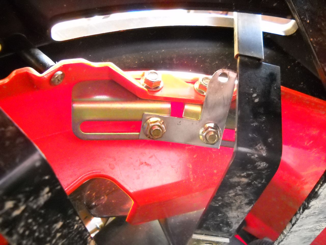

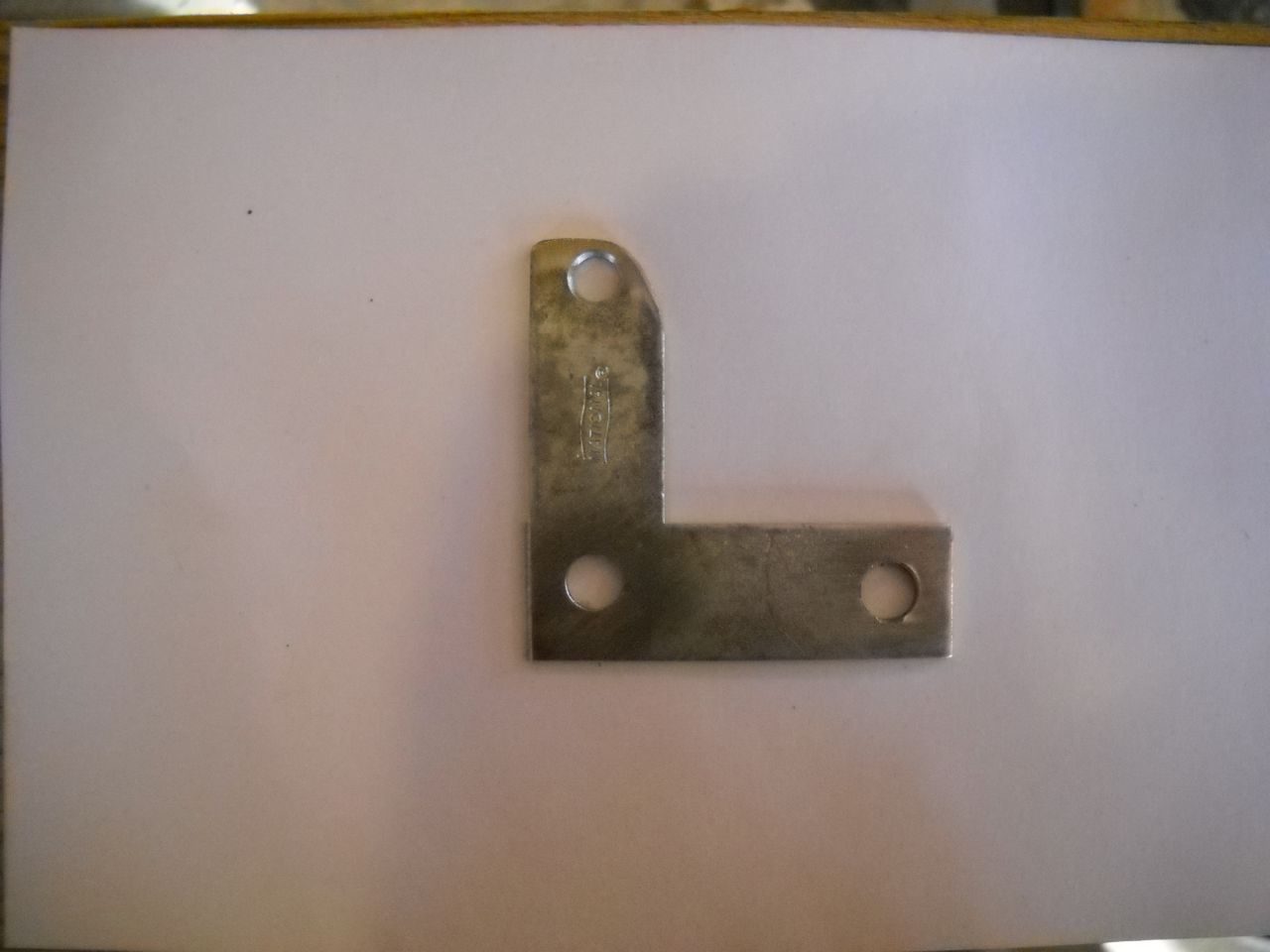

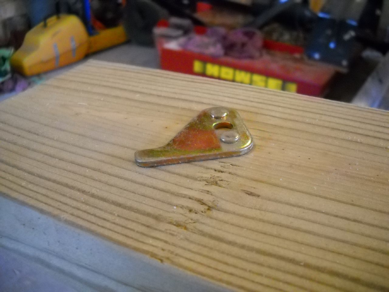

1. Here's one of the "Quarter Inching" tabs I had planned on using to create a locked-forward position for the control lever. It wasn't until I'd removed one that I realized the two circles surrounding the bolt hole weren't alternate bolt holes but rather partially punched cutouts designed to hold the tab at a right angle to its mounting bracket. Without those holes I couldn't get the tab to reach out far enough to catch the lever.
2. I cut and ground down a T bracket (didn't have an L) to make my own lock tab.

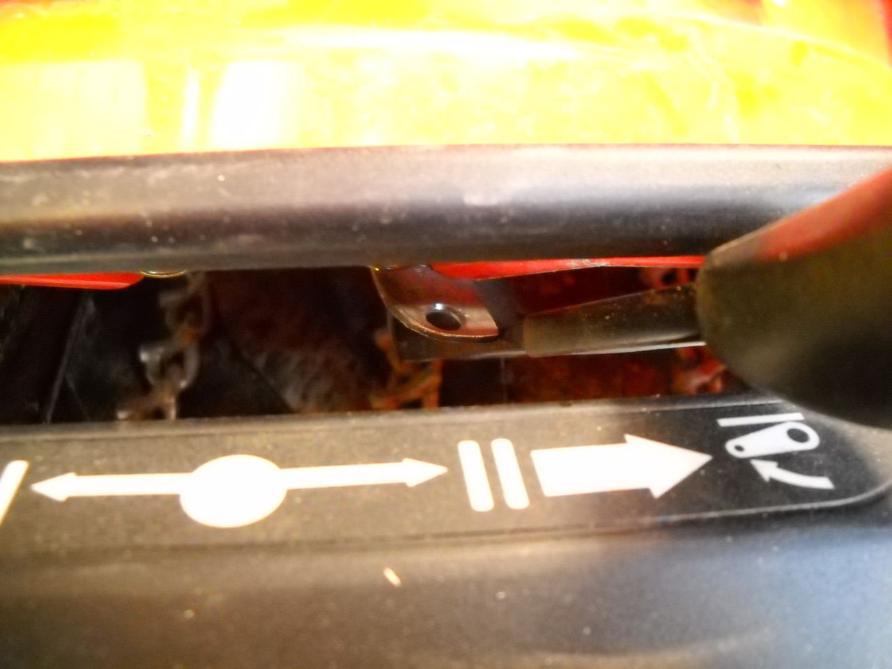

3. I removed both Quarter Inching tabs and used their bolts to mount my locking tab. Here it's holding the lever forward in the "down" position.
4. The view from above - holding the lever forward.
It works nicely. Pretty smooth operation although I don't know if it will pop out when the ride gets bumpy. The tab can be fine tuned by bending it up and down a little bit.

Can I just say, this has proven to be an awesome modification.
I use my 3PH for a rotary mower and a back blade. For both, I almost always operate with the implement completely lowered. I want no support from the hitch. It's so nice to be able to just throw the lever forward then let go secure in the knowledge that the implement is going to drop to the ground and stay there.
Particularly when blading, I previously ALWAYS kept my hand on the lever to be sure the blade didn't lift up when going over a bump.
The operation is smooth and reliable. Push forward and the lever locks and stays there regardless of how rough the ride. Give a little bump to the right and it releases. To control the height, just keep a little rightward pressure and it won't lock.
