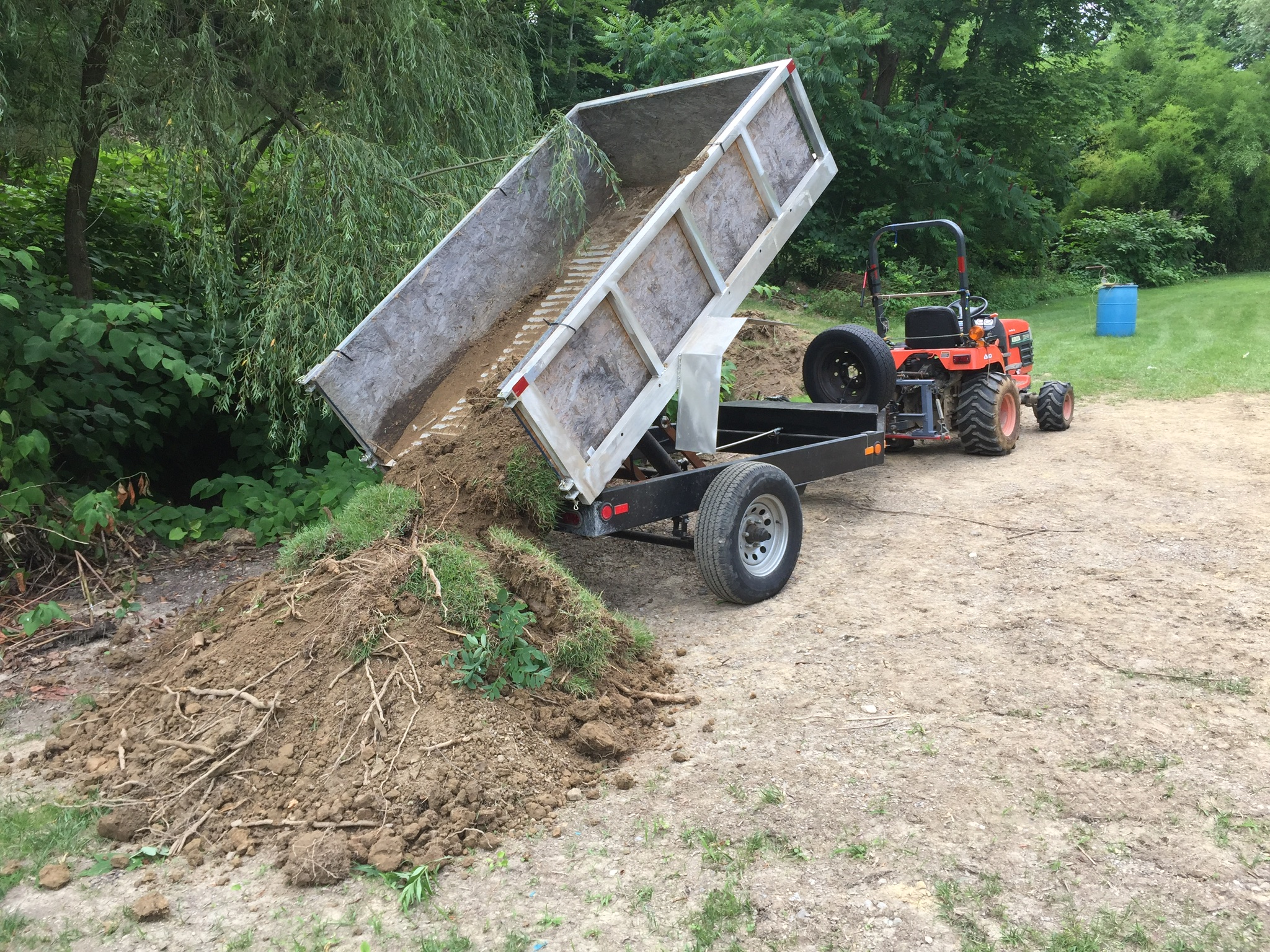

I am sure you are right that without the top link in the picture the BX front tires would stay on the ground. Still cannot imagine using a 5 foot cutter behind my BX though. Although I have pulled many loads of dirt in my 5x8 dump trailer with my BX, which is a lot more weight than the 5 foot cutter.

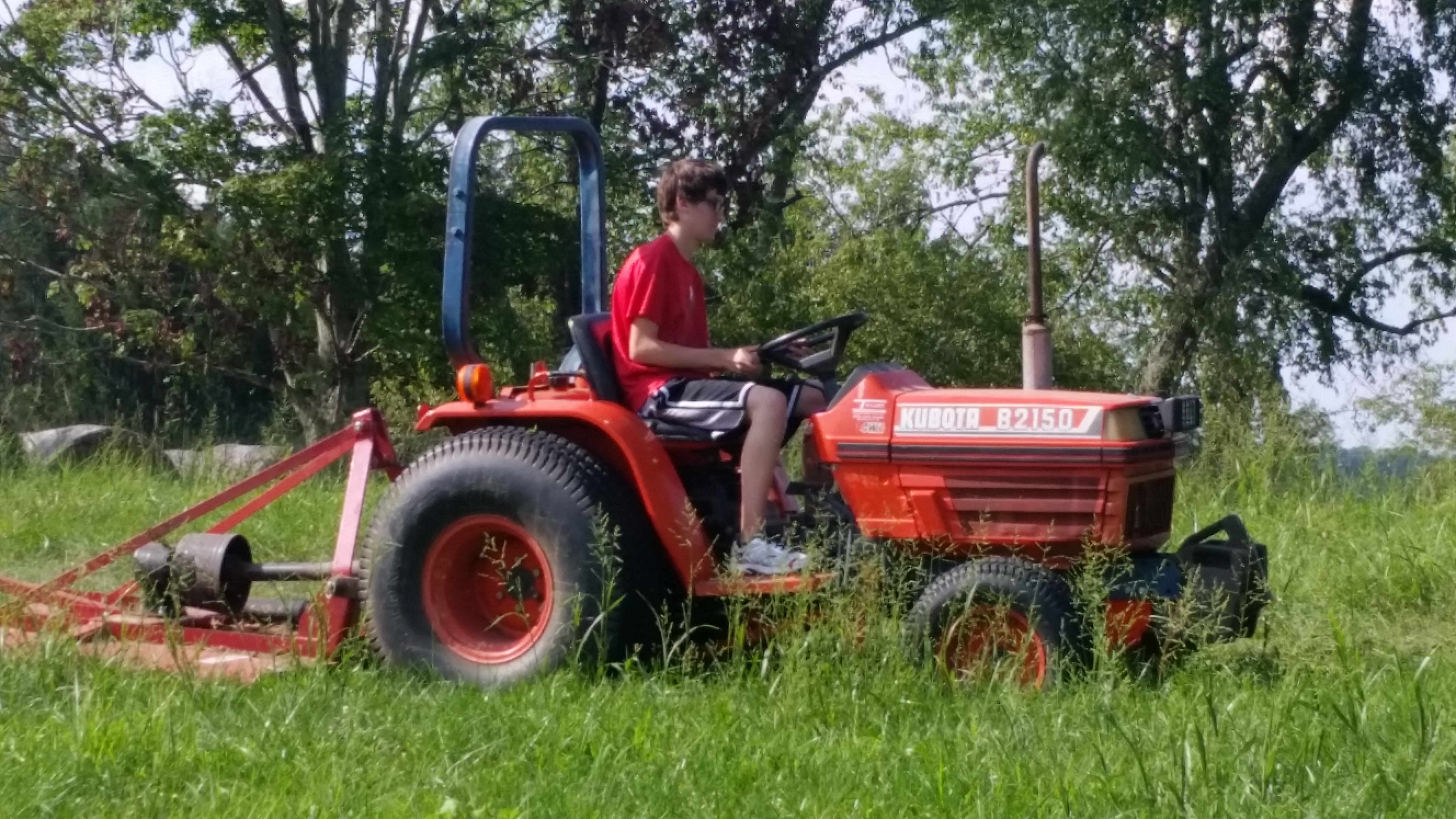

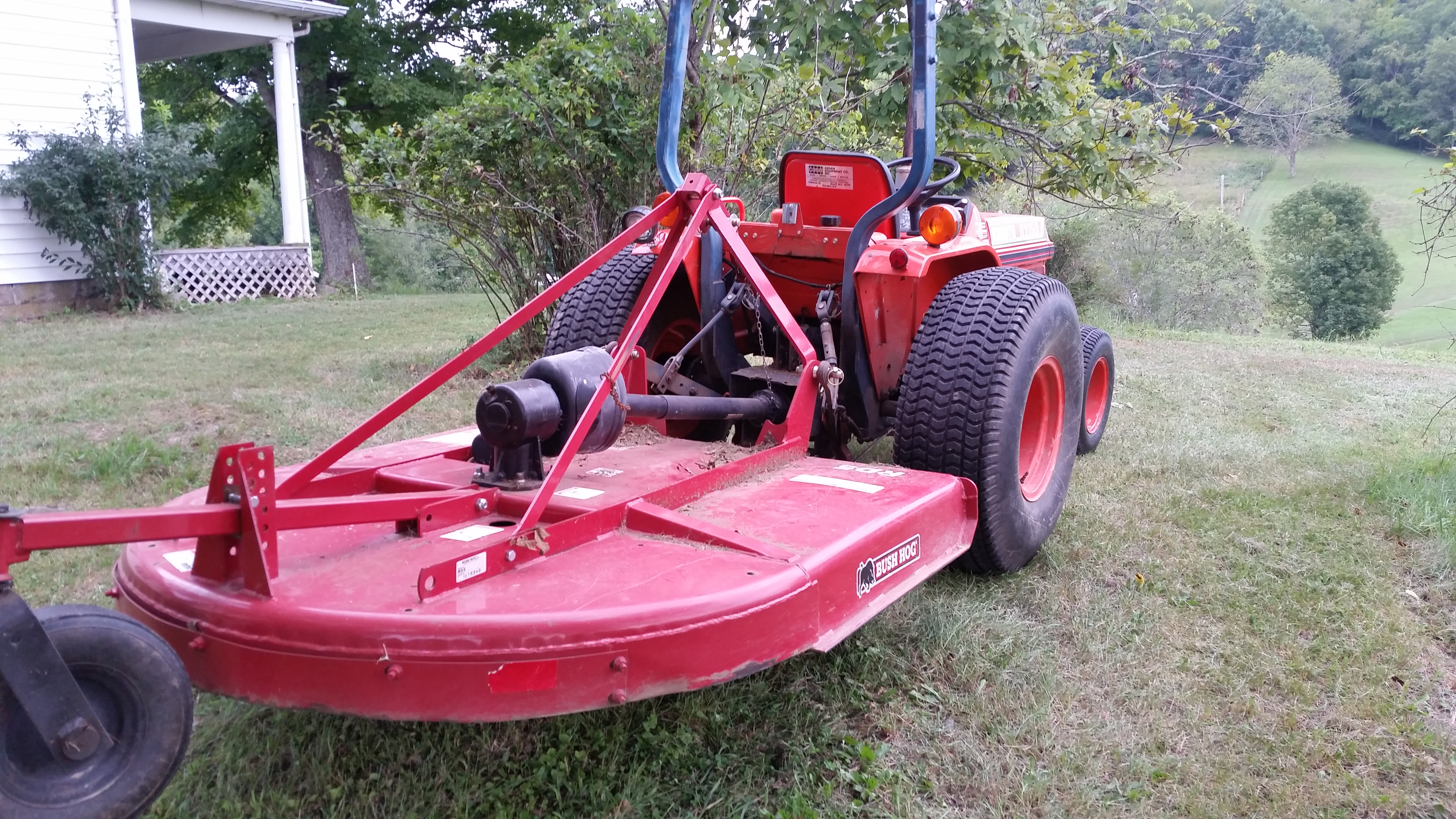

Almost: I run a 5ft Bush Hog brand cutter on a Kubota B2150 all the time. The weight of the B2150 is about the same as the BX25D. My front wheels stay down and I do not have a FEL on it. The PTO hp is a little more on my B2150 (20 vs 17.5) and my 4 cyl probably has more robust "real" hp than the newer specs. My std trans does not have the losses of your hydro. But I run the 5ft hog easily in rather heavy grass and (based on that post #26 picture) I say he should have no problem cutting it with the 5 ft hog. I just do not see a problem. Sure,protect the plastic fan underneath. I think you can mow the 10 acres in one good day's work.
And for Pete sake forget the MMM !
