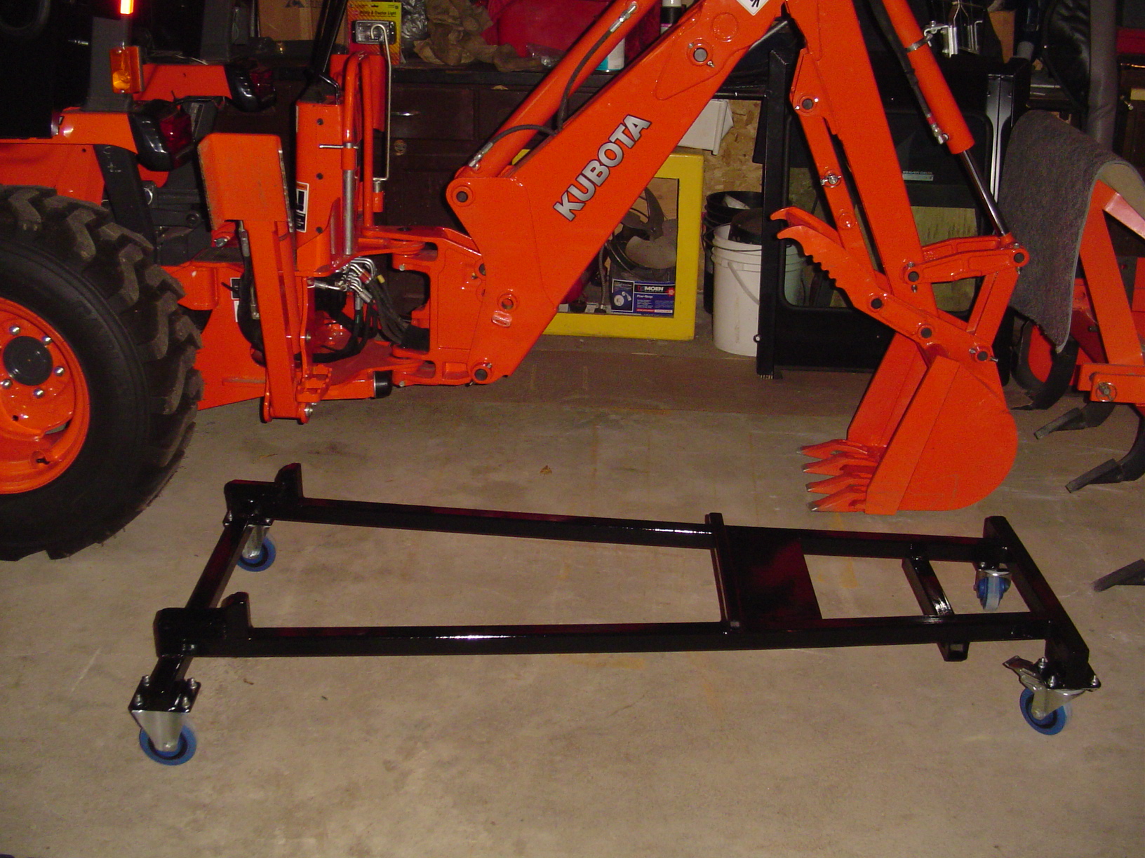

   / BX BH dolly project. #37
Here's a picture of my doly for my BH65, a friend of mine built it for me.
