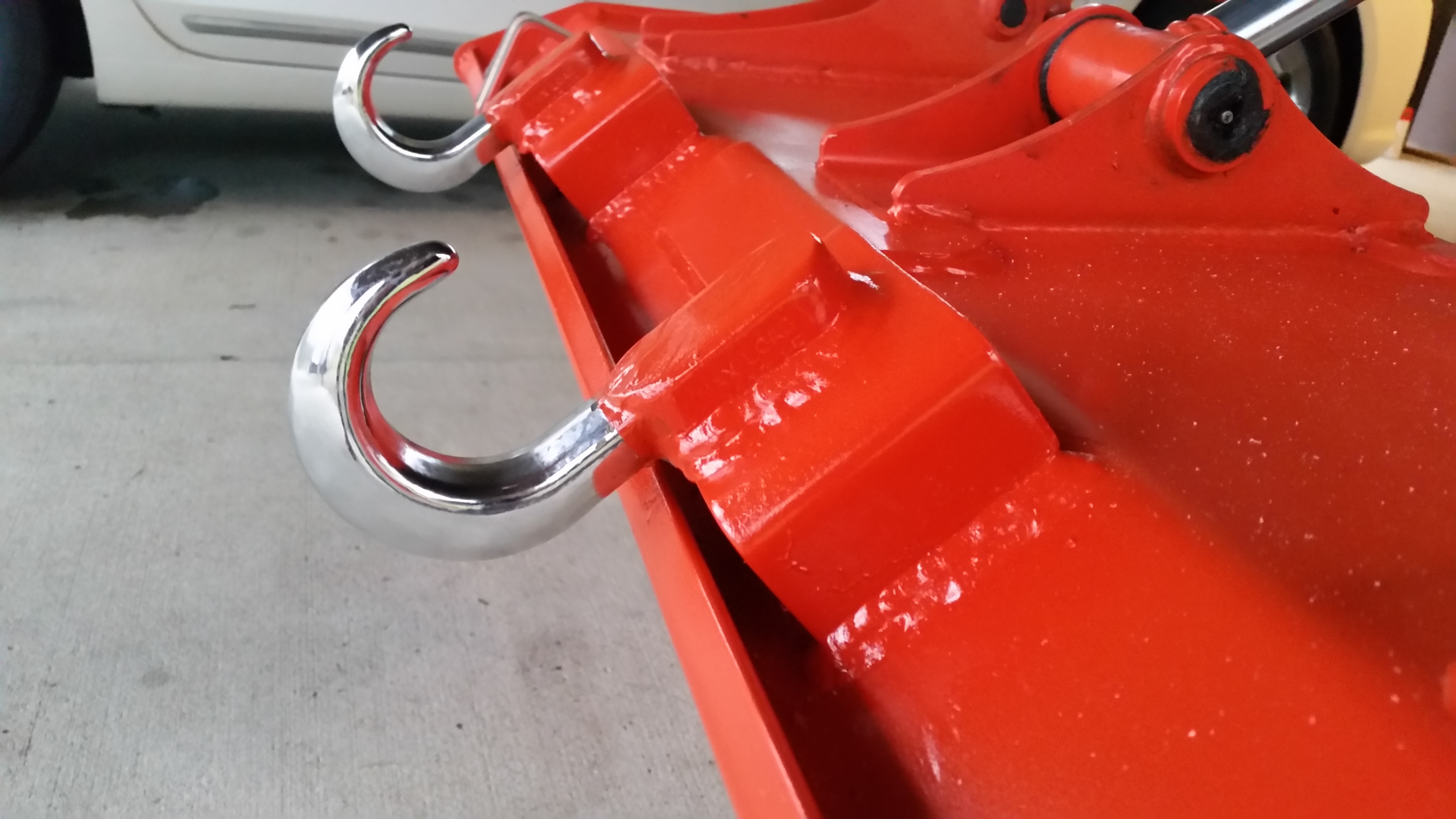

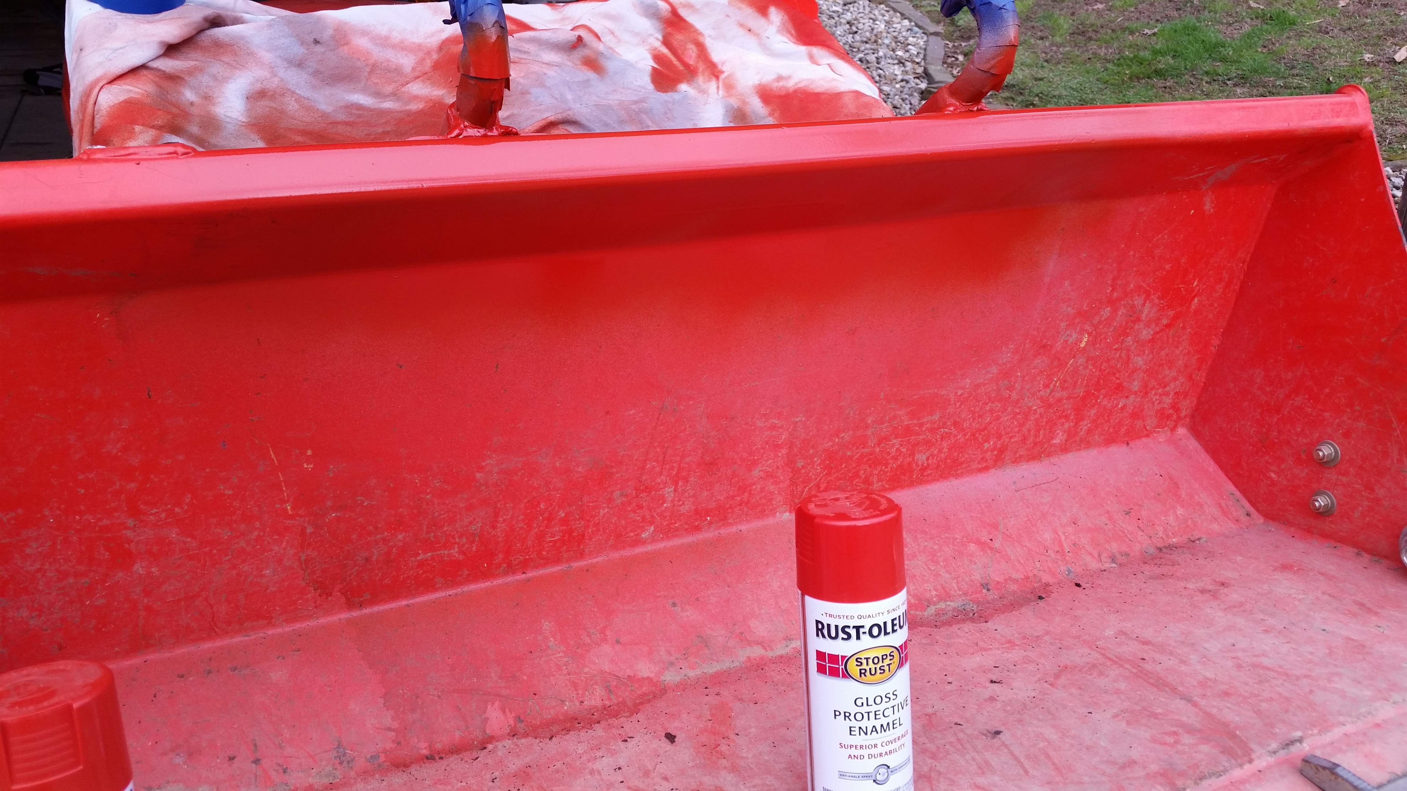

Took advantage of having my son in for Thanksgiving (he's a welder) and mounted a couple of bucket hooks on my BX. A pretty simple modification, but I sure appreciate when folks on this forum post step-by-step instructions so I hope this might be helpful to others.
My favorite part of the modification? Spending some time on a project with my son and having him be the guy who knows what he's doing! With it being Thanksgiving, my antennae are up concerning things for which I am thankful. The older I get, the more I appreciate the blessing of kids and thank God (literally) that they are young people who have married well, have good work ethics, and are intentional about their Christian faith.

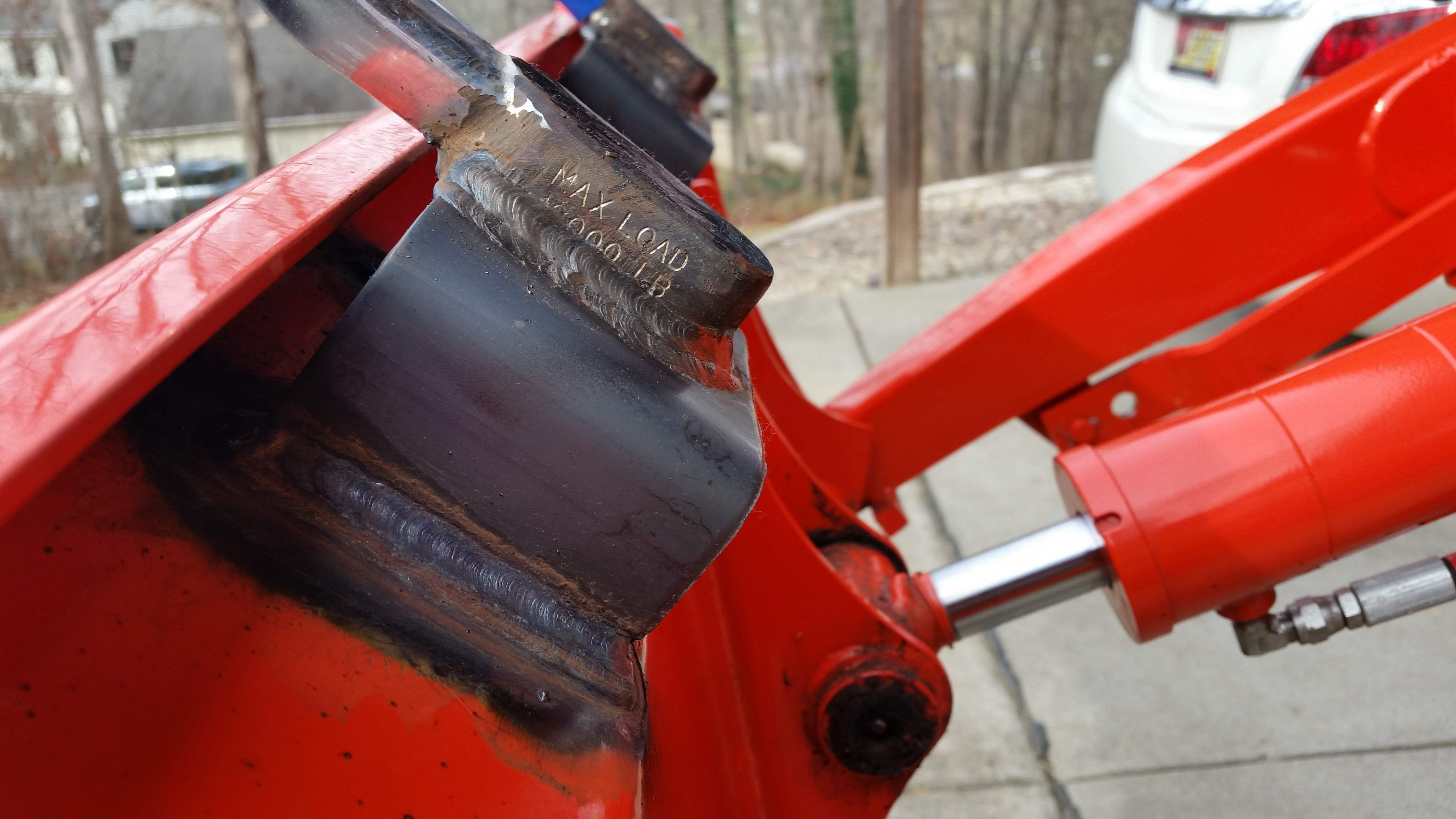

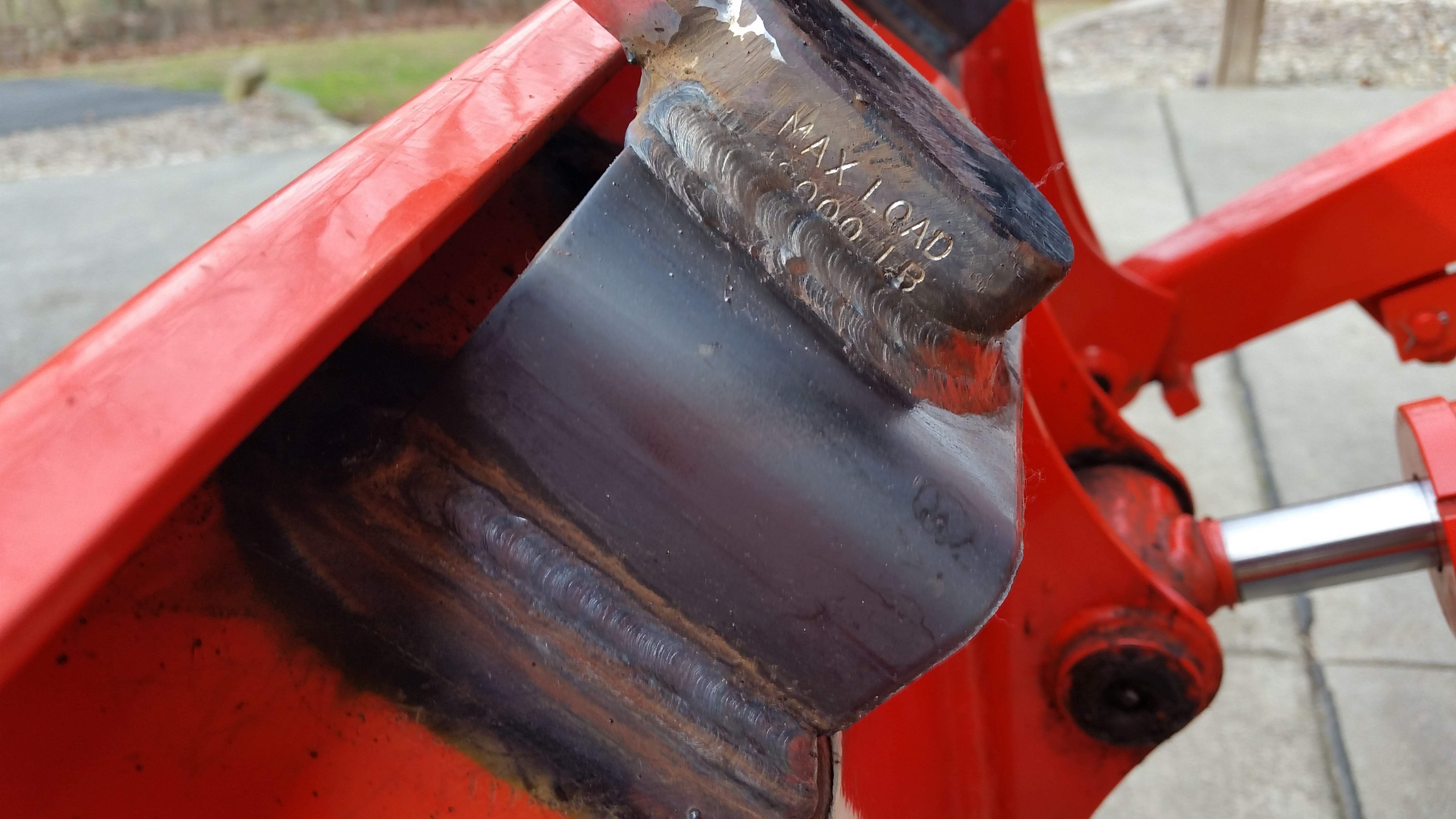

Ordered chrome "tow hooks" from Amazon for $5 each. Also ordered a couple of "weld on anchors" from Amazon ($6.64 each) that were just right for mounting high enough to rise above the bucket lip.

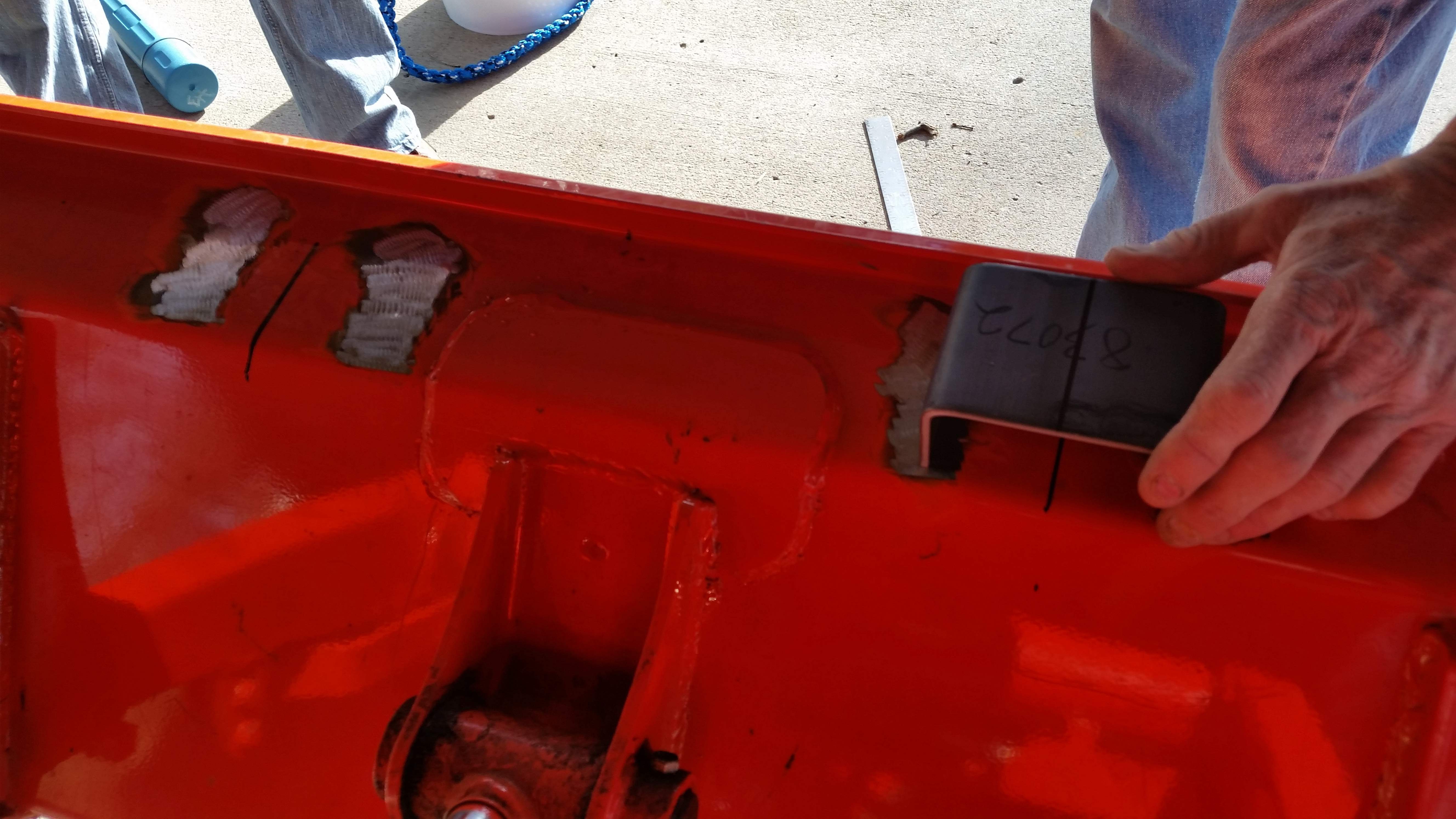

Used angle grinder to remove paint in areas to be welded.

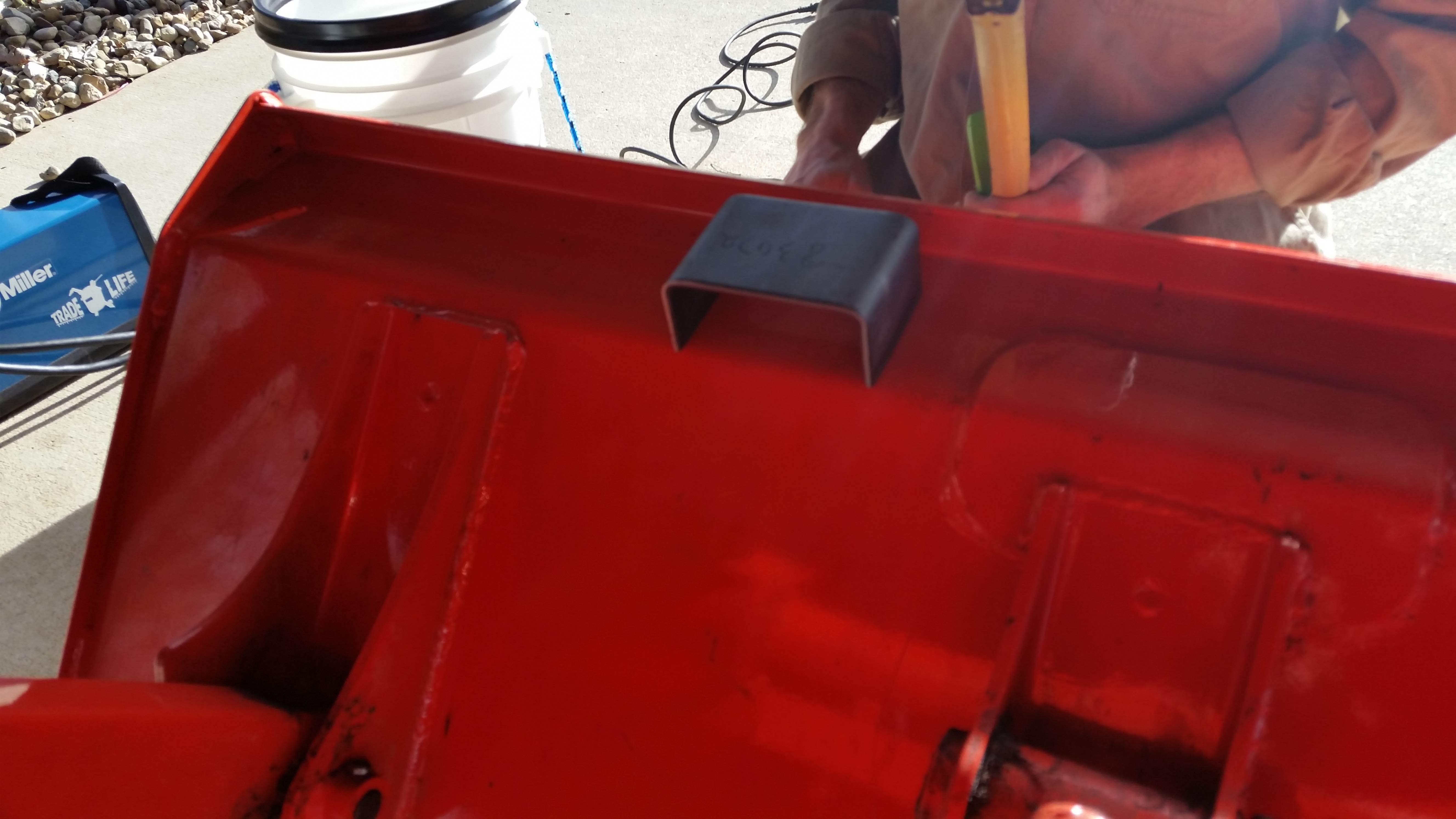

Centered mounts between bucket arms and center cylinder, making sure there would be no obstruction with range of motion.

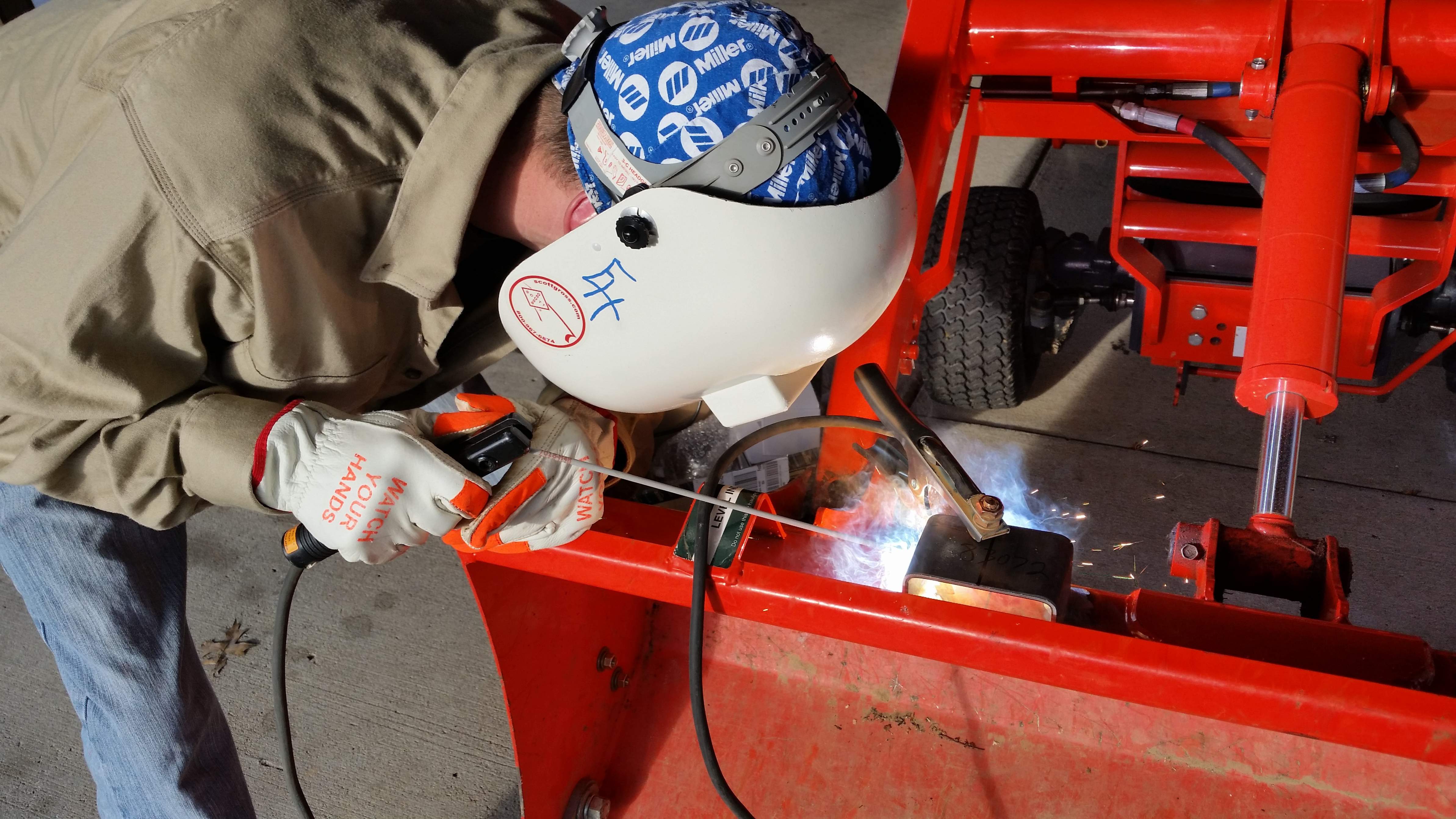

Welded mounts to bucket.

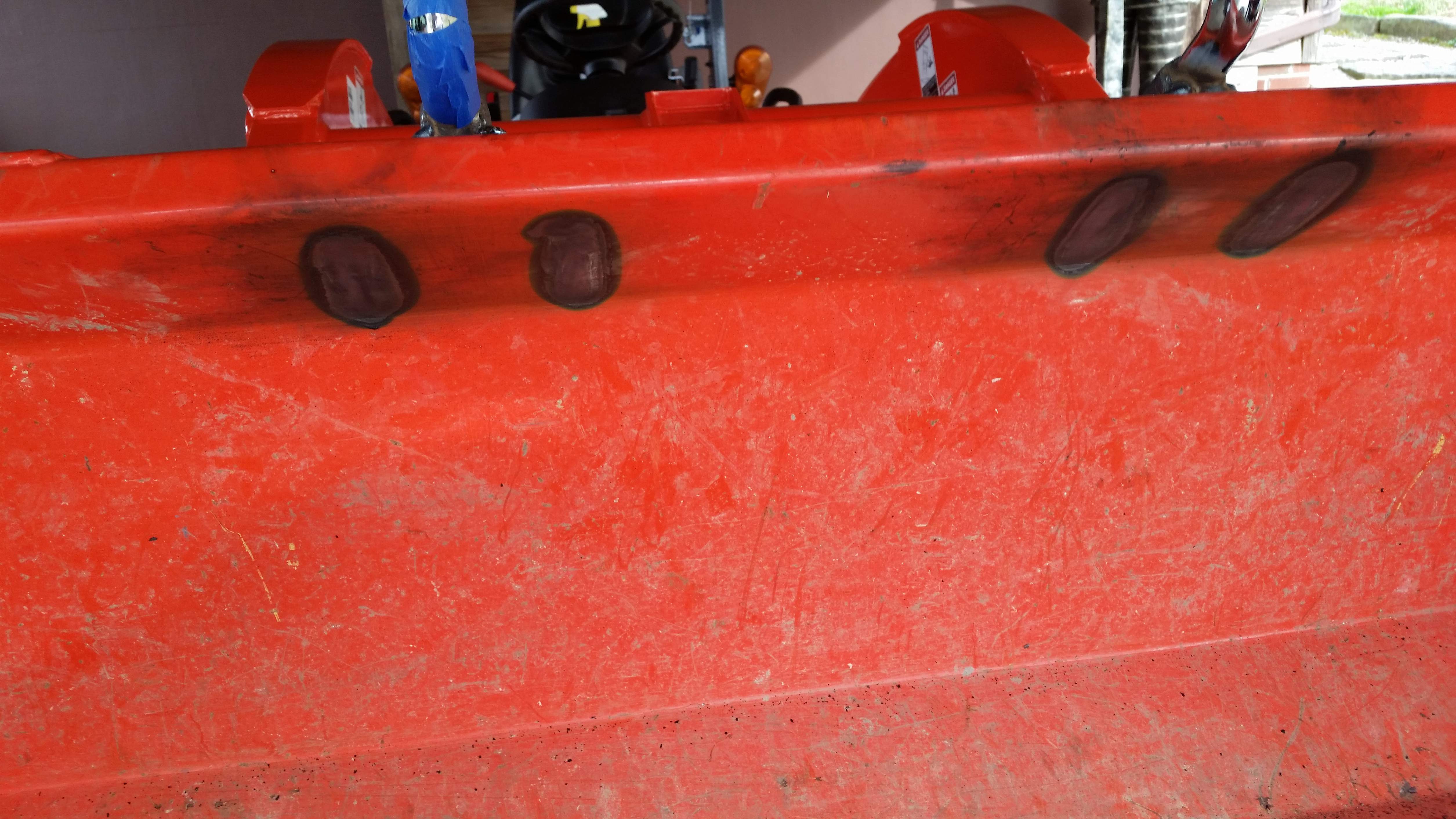

Welding "burned" paint off inside of bucket.
Hooks were bolt-on so ground chrome finish off areas to be welded. "Plug welded" the bolt holes and welded to mounts. Welds wouldn't have been nearly as nice if I was the welder!

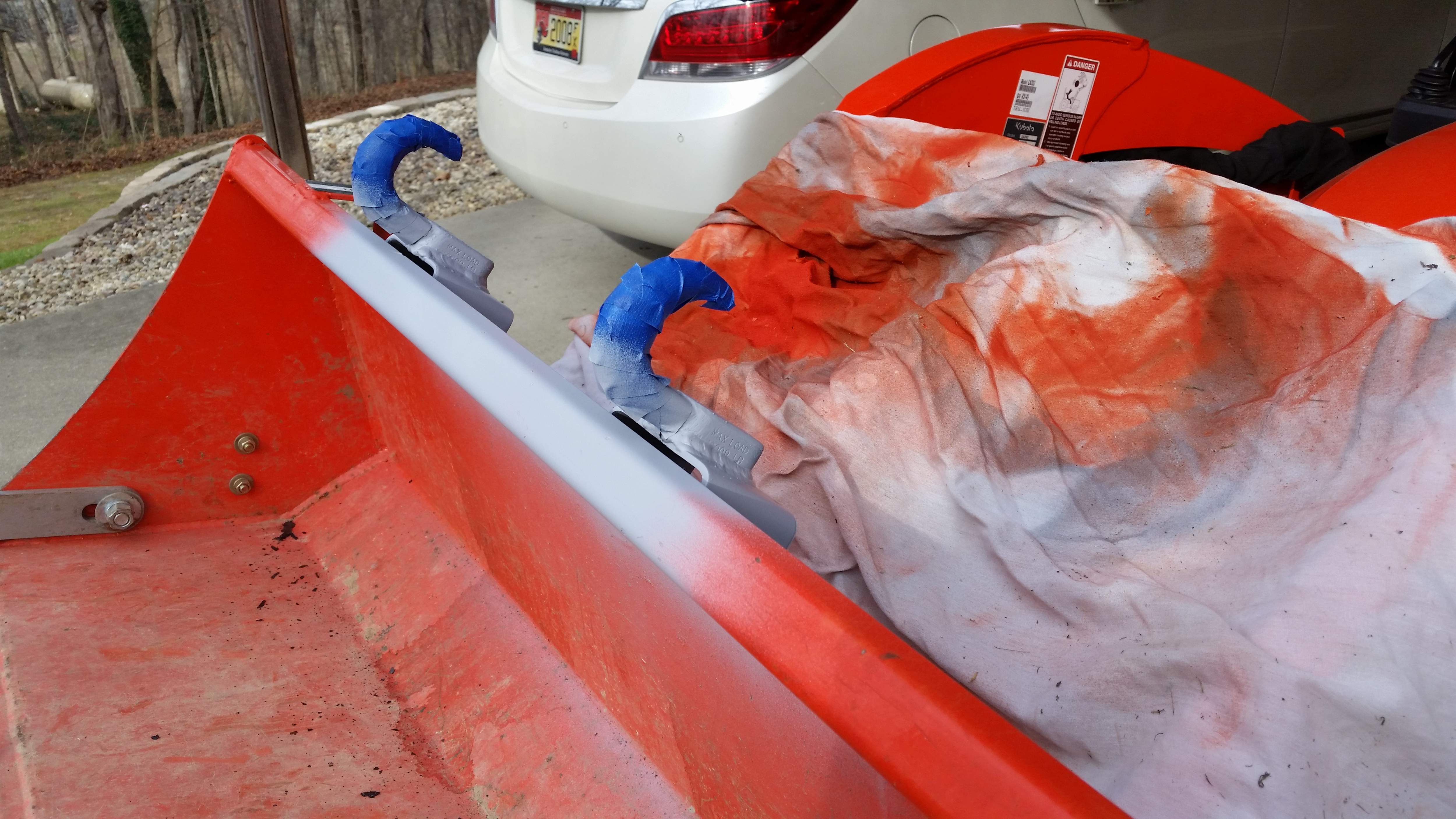

Primed, then painted with Rustoleum "Lobster Red" spray paint. Very pleased with the match. You can tell where new paint is applied, especially inside of bucket where original paint is more damaged, but it's about as close as you can get to factory paint without going to the dealer.

Nice, Fancy chrome hooks :) You may kick your self later for not installing chain hooks... my 2cts...
/ BX Bucket Hooks Install - PICS
Thanks, Firefighter. I almost installed chain hooks but settled on the tow hooks because, for me, they were more versatile. I don't do any serious tractor work, just work around the home. Most of my lifting and pulling is with rope or tow straps. If I ever need a chain hook, I'll mount one in the center.

Just a couple of additional ideas:
1. Welding a section of 1/2" pipe under the lip of the bucket really increases its strength. It looks like it still could be done. (It may be 3/4" pipe instead...can't recall.)
2. Another good spot for a hook is on the back of the bucket. Then heavier loads can be lifted closer to the fulcrum of the FEL without as much ballast.
Kudos for not putting hooks on the outside edges of the bucket. Those are a tip-over waiting to happen. Many folks make that mistake.
Nice welds as you pointed out.

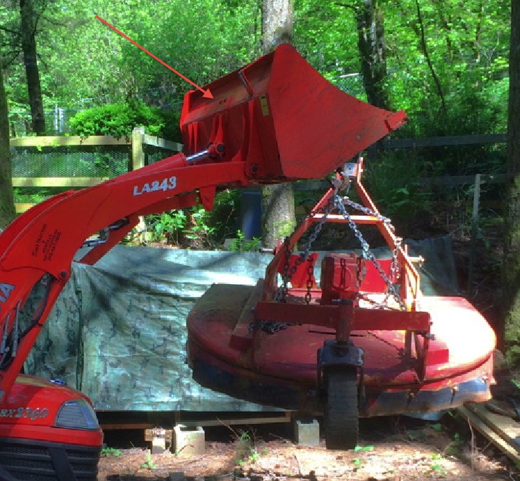

Thanks, gwdixon. I can see how a pipe welded to inside top of bucket would add a lot of strength. I also like the idea of a lower rear mounted hook for lifting the heaviest loads. As I mentioned previously, I don't do much in the way of real tractor work; however, I do enjoy tinkering around on this little tractor and always like to have a project or two in the hopper.
You're right, too, about having to be careful of tip over. I haven't tipped sideways, but did tip forward once while loading a riding mower in my pickup bed. I got off the BX to position the mower as it dangled above the truck bed and as soon as I got off the machine - down it went! Luckily only a few inches until the mower hit the truck bed, but it definitely got my attention! I have a ballast box but wasn't using it. Lucky I didn't experience more pain than a bruised ego.

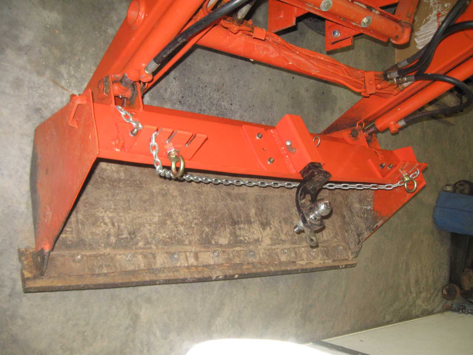

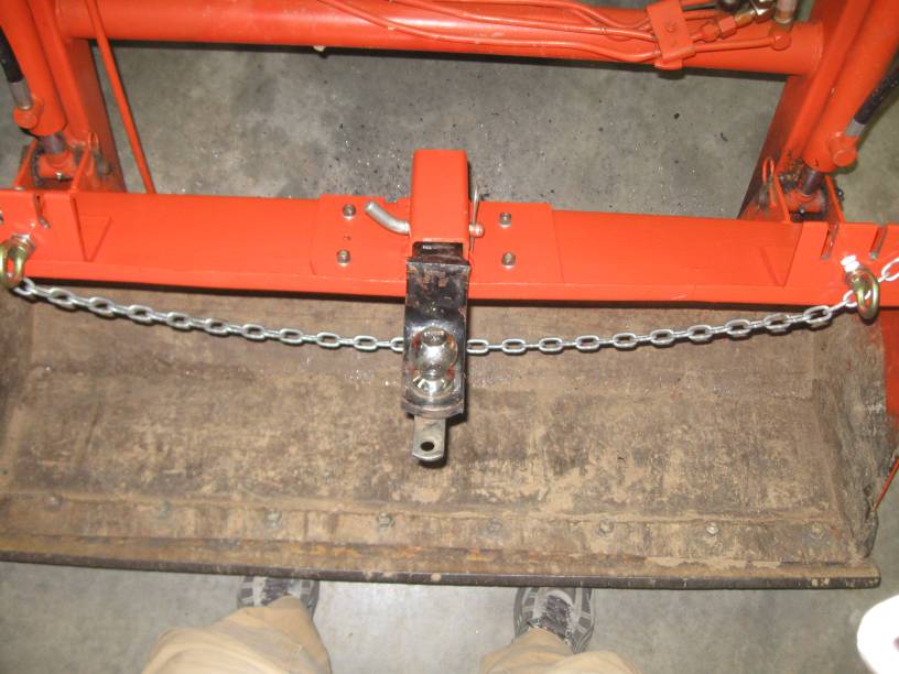

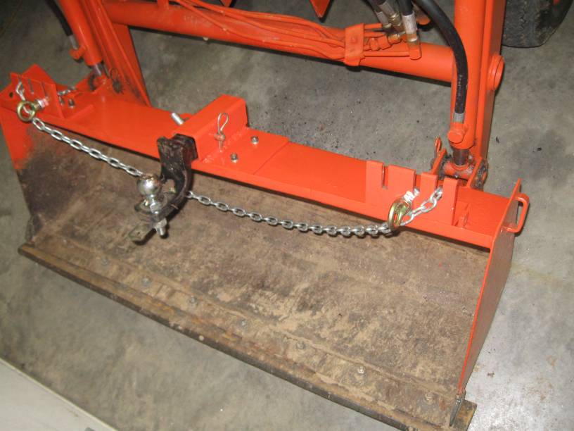

Here is what I did for hooks. But my tractor will only lift about 1000 lbs.

Man, BMWMIKE, that's one versatile setup! Looks like you're set for any towing/tugging/lifting/moving need. Nicely done.

Another nice thing about it , I made a 2 inch insert with a hook welded to it and I can put it in the receiver hitch from the back , then I have a hook on the back side of the bucket for lifting heavy loads.

Here is what I did for hooks. But my tractor will only lift about 1000 lbs. <img src="http://www.tractorbynet.com/forums/files/kubota-owning-operating/450479-bx-bucket-hooks-install-pics-08-jpg"/> <img src="http://www.tractorbynet.com/forums/files/kubota-owning-operating/450480-bx-bucket-hooks-install-pics-09-jpg"/> <img src="http://www.tractorbynet.com/forums/files/kubota-owning-operating/450481-bx-bucket-hooks-install-pics-10-jpg"/>
Outstanding job BMWMIKE. I think that is how I will set mine up. What are the handles on the side of the bucket for? (40 years as a marine Chief Engineer, and this is my first foray into the world of little tractors , so I may have some annoying questions for. awhile.
