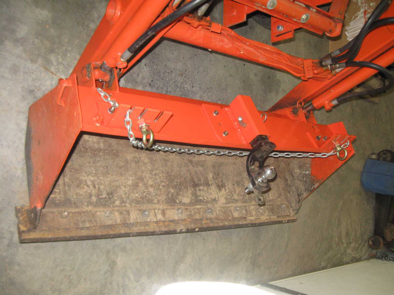

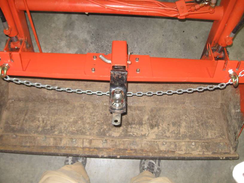

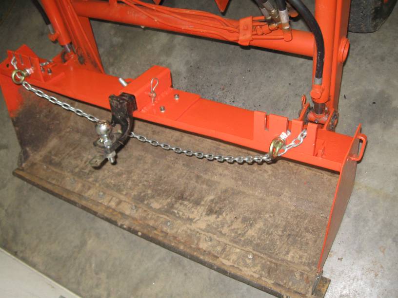

Here is what I did for hooks. But my tractor will only lift about 1000 lbs.
   / BX Bucket Hooks Install - PICS
#15
Man, BMWMIKE, that's one versatile setup! Looks like you're set for any towing/tugging/lifting/moving need. Nicely done.
Jeff
   / BX Bucket Hooks Install - PICS #16
Another nice thing about it , I made a 2 inch insert with a hook welded to it and I can put it in the receiver hitch from the back , then I have a hook on the back side of the bucket for lifting heavy loads.
mike

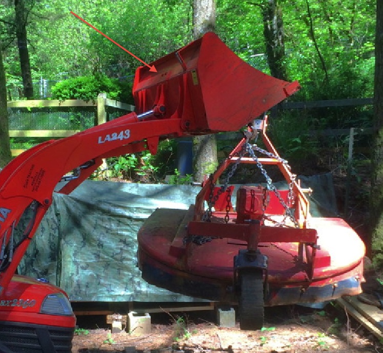

Here is what I did for hooks. But my tractor will only lift about 1000 lbs. <img src="http://www.tractorbynet.com/forums/files/kubota-owning-operating/450479-bx-bucket-hooks-install-pics-08-jpg"/> <img src="http://www.tractorbynet.com/forums/files/kubota-owning-operating/450480-bx-bucket-hooks-install-pics-09-jpg"/> <img src="http://www.tractorbynet.com/forums/files/kubota-owning-operating/450481-bx-bucket-hooks-install-pics-10-jpg"/>
Outstanding job BMWMIKE. I think that is how I will set mine up. What are the handles on the side of the bucket for? (40 years as a marine Chief Engineer, and this is my first foray into the world of little tractors , so I may have some annoying questions for. awhile.
