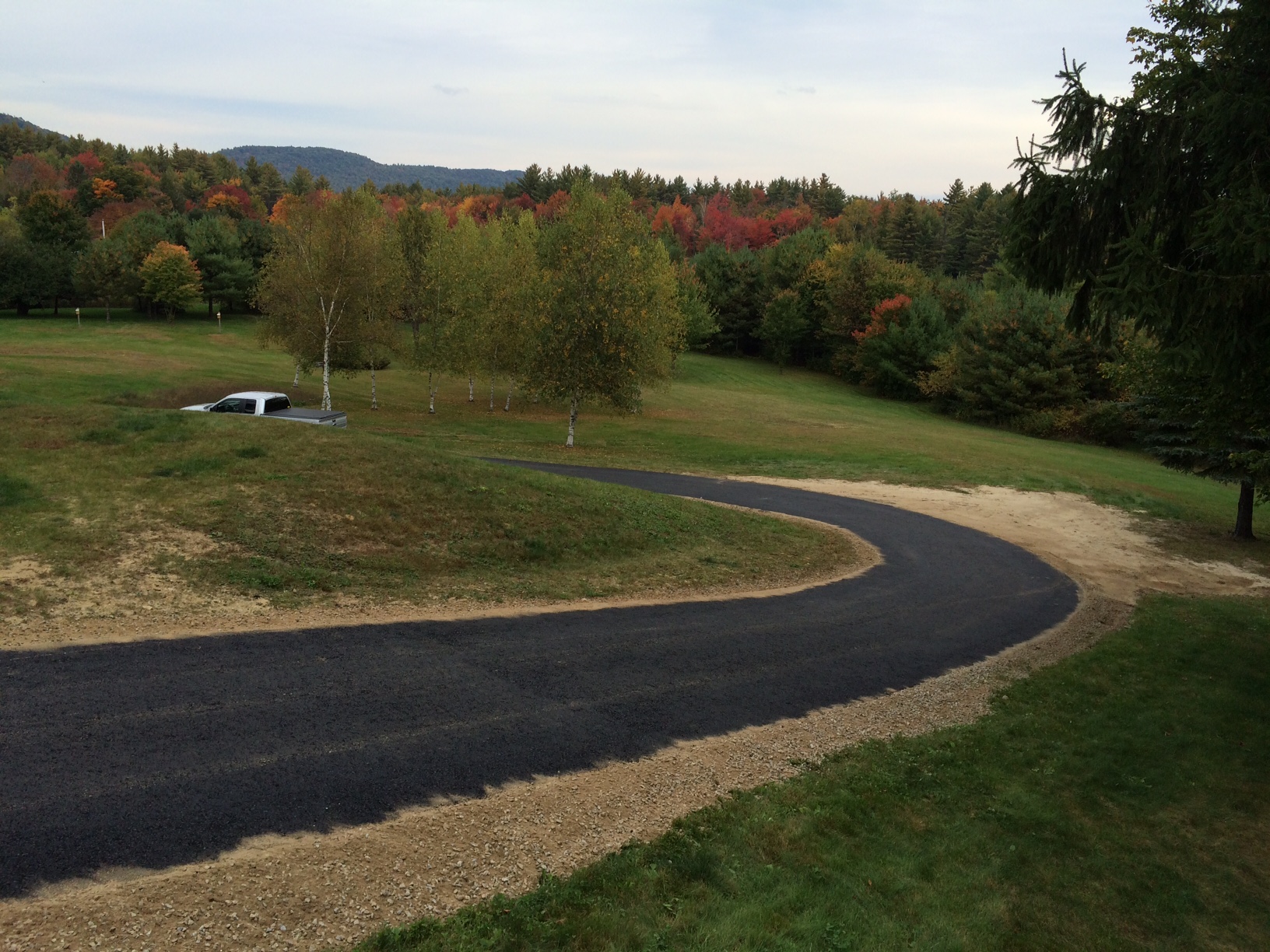

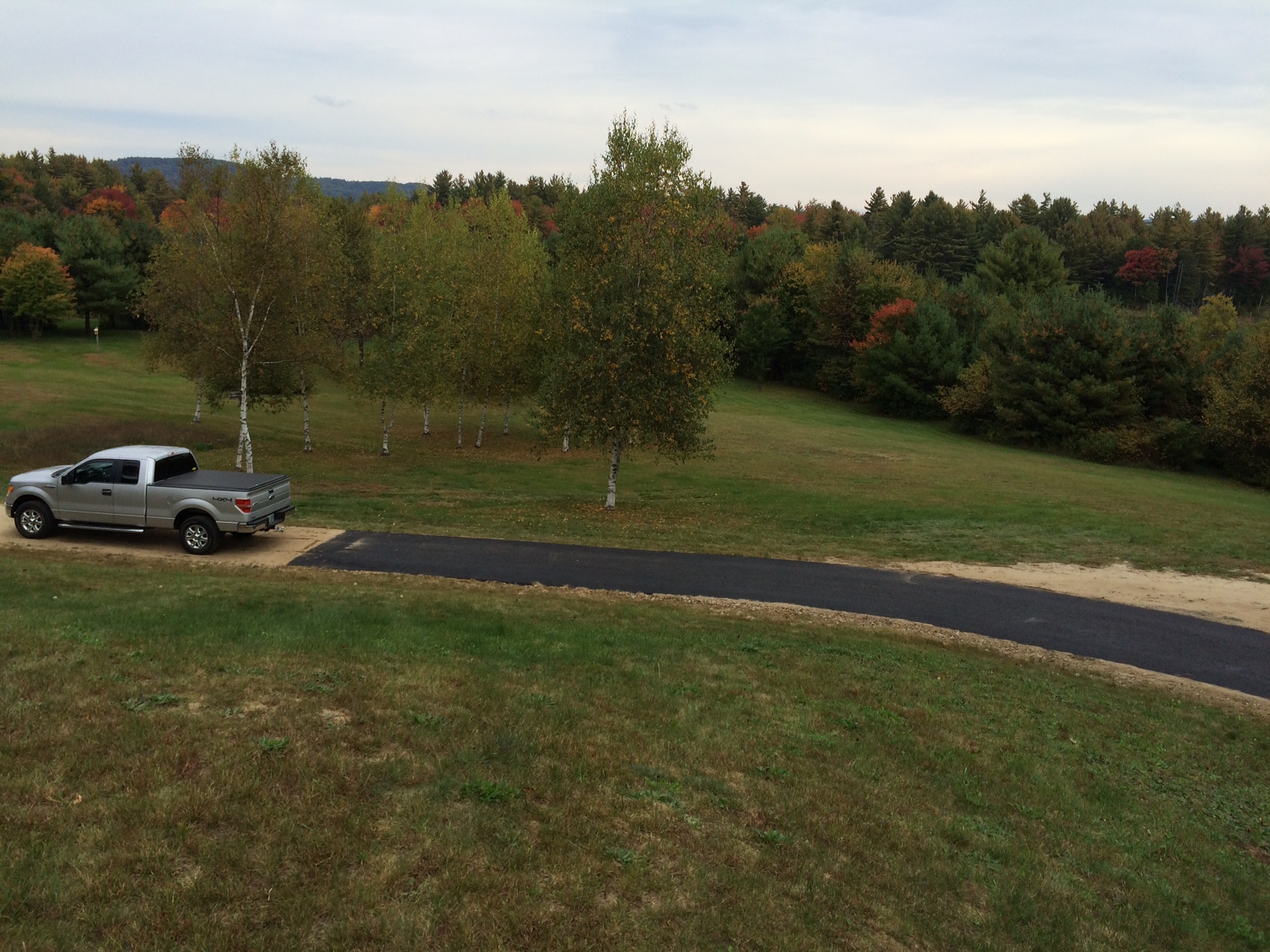

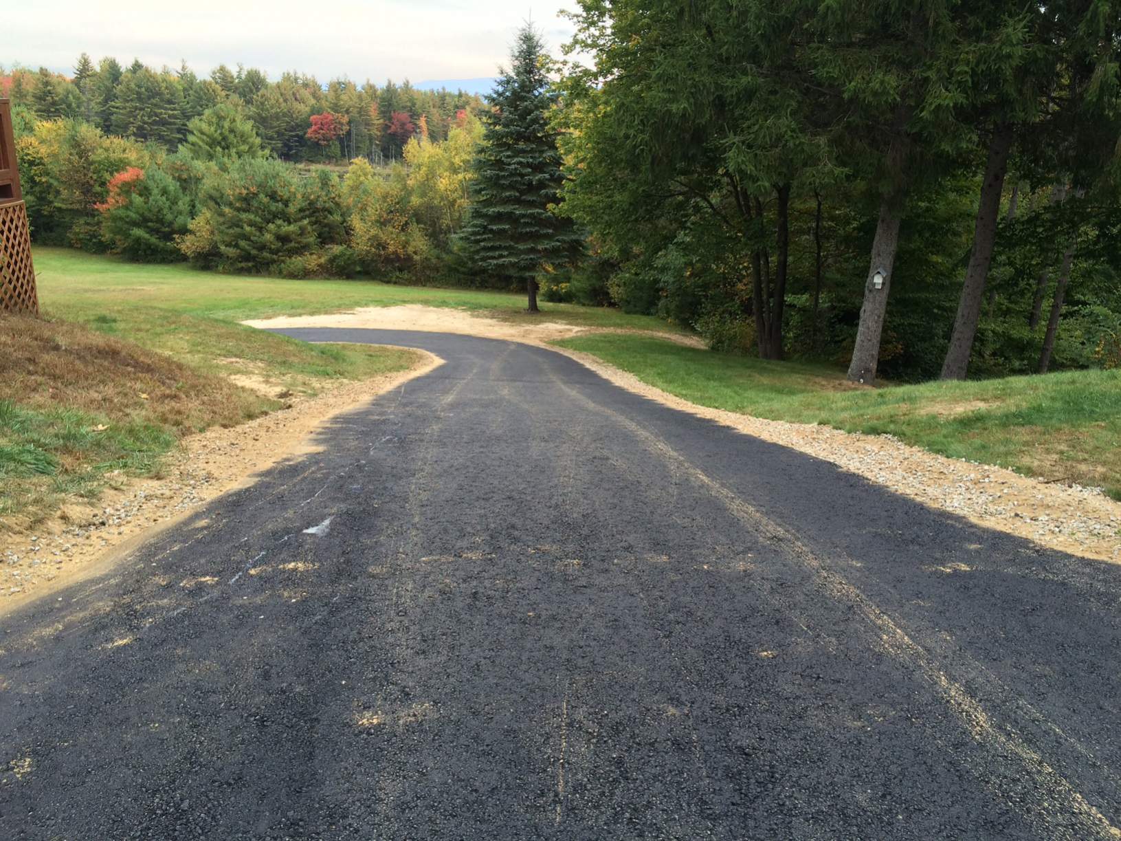

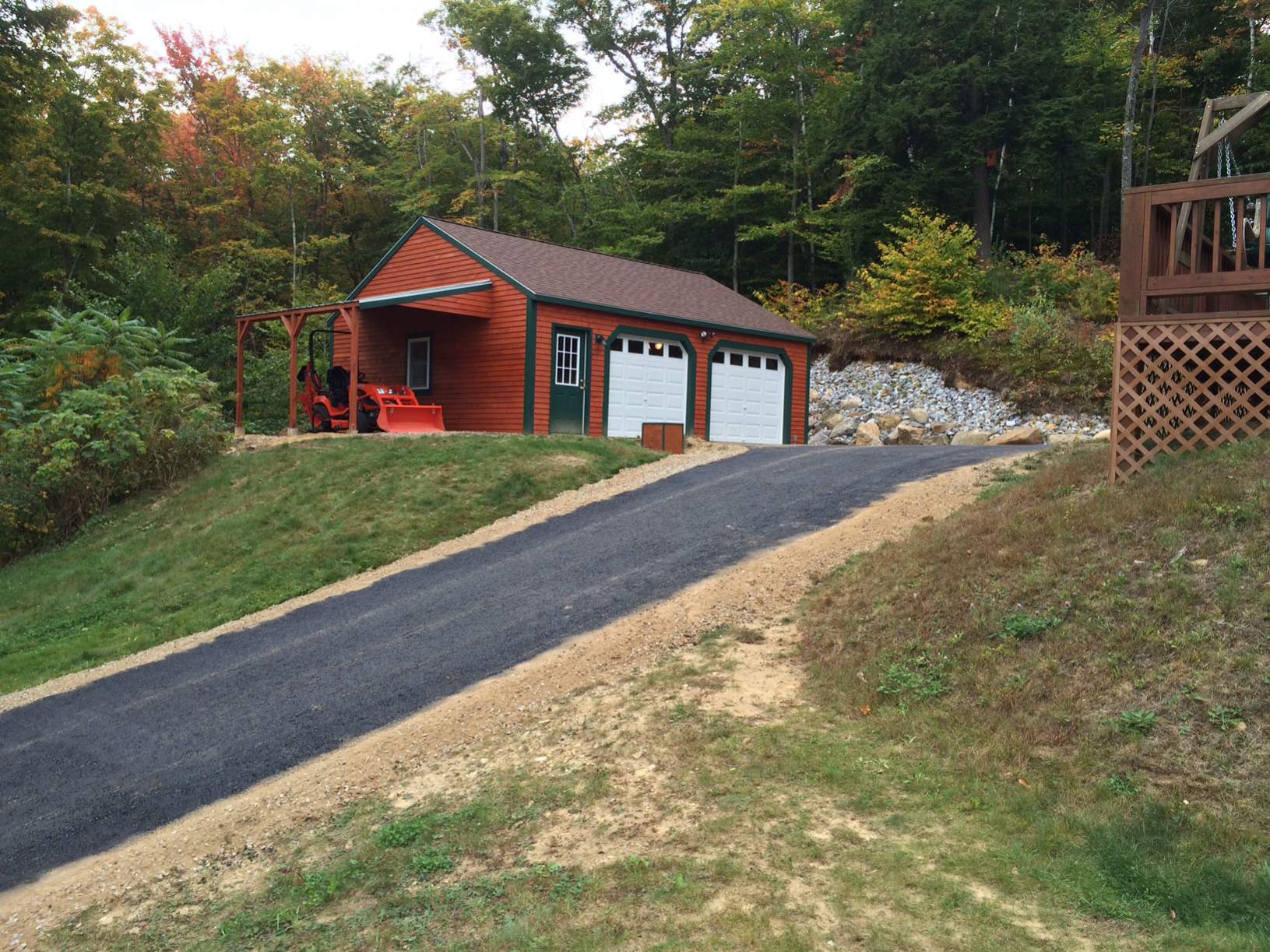

Well...let me clarify! Only one third of my 500 ft driveway is paved...the worst part is the last 200 feet to a 90 degree turn up a steep grade, then up the the landing at the house level. The lower 300 ft is gravel which is in need of some material and the first storm of the year (Thanksgiving eve) my gravel was not frozen either...what a mess! I plow the gravel with a 4 wheeler and it was digging in and spraying gravel everywhere.
