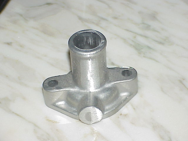

You should never run the engine without coolent. That is one of the fastest methods to ruin an engine. If you need to flush the engine, you should remove the thermostat first and then fill with cleaning solution. The thermostat top housing is pictured below. Two bolts hold it to the engine. You will need a new gasket also. Check with your local town for instructions for proper disposal of the anti freeze. Some towns have a recycling program for anti freeze. DO NOT dump it into your septic system!! Also, don't dump it into the public sewage system unless your town tells you that it is ok.
Dusty
