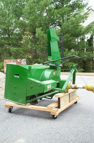

I took an old desk top, 11/2 inch of solid oak, put 4-2 ½ wheels on it and store the loader on that. When it is time to take the loader off for summer grass cutting, I just take it off and put it on the dolly. When I need it, I just push the dolly to the tractor, hook up the hoses, move the FEL into the brackets, and away I go. Takes a few minutes. Storing the FEL easy to, I can move it around the shed to get to other things. I have dollies made out of 2 by 4 and wheels for all my attachments. Taking them on and off very easy and to move them around to get the 3 pt pins into place. /forums/images/graemlins/grin.gif

Here is a picture of the one I made for the snowblower

Tom,
I am brand new at this stuff, but I gotta say I really like that idea. I think I will have to build one or two of those as well.
