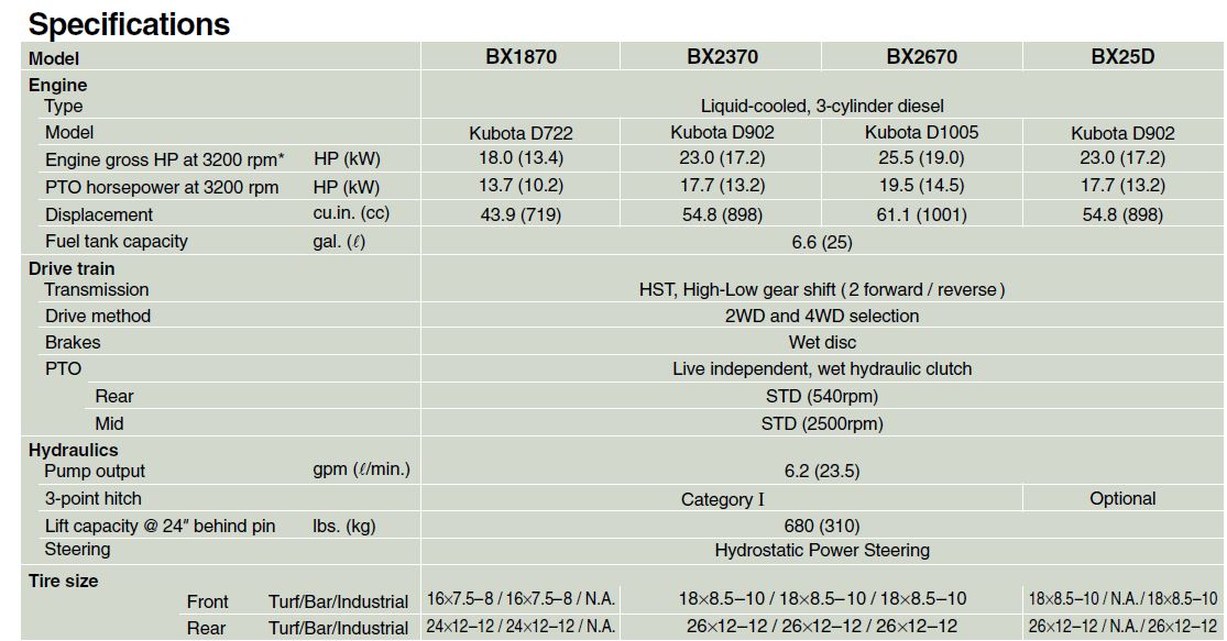

Just a few simple questions. Will the 8" front wheels from a BX1870 fit on a BX2670? Concerned about clearance around the gear housing, etc. If so, is there a width or offset difference?

According to kubota.com, the 1870 has one size of tires/wheels and the 2370, 2670 and 25D have another size. Meaning, the 2370, 2670 and 25D all have the same size (in their respective tire type), however the 1870 is smaller.
Whether or not the wheels from a 2370, 2670 or 25D would actually physically bolt on, I don't know. But due to the size difference, you would not want to do this.

Now that I checked, how did you find an 8" rim with an 18" tire from a BX1870?
According to Kubota specs, the BX1870 only came with a 16" front tire while the BX23 and up came with 18" tires.
