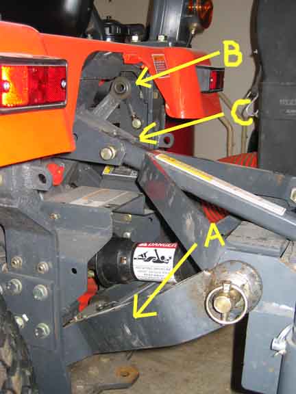

I was a little dismayed that you need to take the lift brackets off the 3pt lift arms, but when you think about it, since the mower and the 3pt mechanism use the same lift hydro there really isn’t another way to do it. Wait, before I get flames on that I do recall someone on TBN that built a really slick quick hitch type mechanism for their BX bagger. Getting the thing on is a bear, I wrestled with it a while before I came to the (erroneous) conclusion that something was not sized right. I called Russ and he sent out his head mechanic the next day to have a look see. Tractor newbe that I was, his mechanic explained that 3pt hitch implements are not the micro tolerance machines that I might think they are. They often take a mallet whack, drift pin, and foul language to get on. Using all three, he and I were able to wrestle the thing on.
Now that I have practice and know what to expect it is decidedly much easier, although I do use my floor jack to hoist the thing up while I get the top link in place. That’s right, you don’t use the top link itself, instead the bagger has its own “top link” built in that you wrestle into the top link bracket. My apologies to 3pt nomenclature “purists”, after three years of TBN benefiting from the experience of tractor masters, I fear I am still a newbe, so I’m calling the 3pt parts what I THINK they are called, not necessarily WHAT they are called. It probably takes me 10 minutes to put on and 5 to take off. Most of that time is spent removing and attaching the 3pt lift brackets. Kubota does give you some “key ring” pin restrainers to replace the cotters in the pins that have them so this task is not really that difficult.

No. You remove the lift arm levelers (I called them lift brackets in my last post, but I think this is what they are really called, they are the things that connect the lift arms to the hydro servo "ears"). This way the lift arms flop down. When you attach the bagger and tilt it up to connect the "top link" it rocks agains the lift arms and they lift up. If my description is still not clear and surfran doesn't have time to snap a picture I'll do so when I put it on in a week or two.

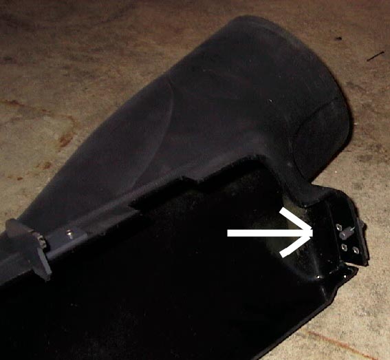

> Do you have to drill the deck, what holds the grass chute open on the deck
The boot attachment for a 60" and 54" deck are different. I'll post the instructions for drilling in a later post. There is a metal "ear" on the boot assembly that holds the chute deflector open. See the attached picture.

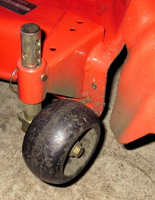

Hmm... can't get the scan size right for the 54" and 60" boot installation instructions. On the 54" (which I have) you need to drill one hole (see attachment) for the boot pin, and widen the other hole for the bungee cord that holds the boot on (see previous picture). For the 60" deck you need to drill two .390" holes on the top of the deck spaced 3 3/4" apart 5 1/4" from the edge of the deck where the chute deflector spring is. Not sure how the boot connects.
In my previous answers I mentioned that there are no zirks. While I still beleive this to be true there is a gearbox that is going to eventually want an oil change and a PTO shaft and 3pt pins that would like a little grease from time to time.

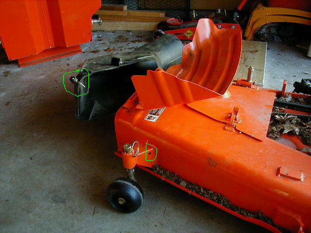

You guys with the 60" decks must have that hole near the back part of the chute already if it indeed mounts with a pin like the 54" deck (see picture for pin location on boot (all these pictures are from my old post)). The two holes that the instructions tell you to drill (Rogue, try a little WD-40 on the bit when you're drilling) for the 60" deck must be to hold the boot on instead of the bungee set up like I have.
I don't really mind the bungee as it is one of the heavy rubber kinds and I can take the boot on and off in around 5 seconds.

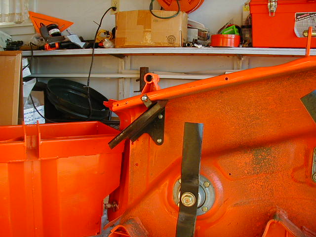

Here is my latest round of pictures. Rock, the two holes are for a deflection chute that you install on the deck. The 60" boot attaches the same as the 54" except the bungee hooks to the side hole on the deck anti-scalp wheel mounts.
Tonight I sheered the pin on the drive shaft, or it fell out. I am not sure, as I don't recall any loud noises, but suddenly it wasn't picking up leaves very well. /forums/images/graemlins/confused.gif Luckily I was pretty much done. I did hit some sticks during the endeavor, but don't recall any at that time.
Anyhow, Rock where do you get new pins? Can I get them at Tractor Supply Co? or do I need to get from Kubota? I think I will want several on hand if this is going to be a normal occurance (which I hope it isn't). /forums/images/graemlins/frown.gif

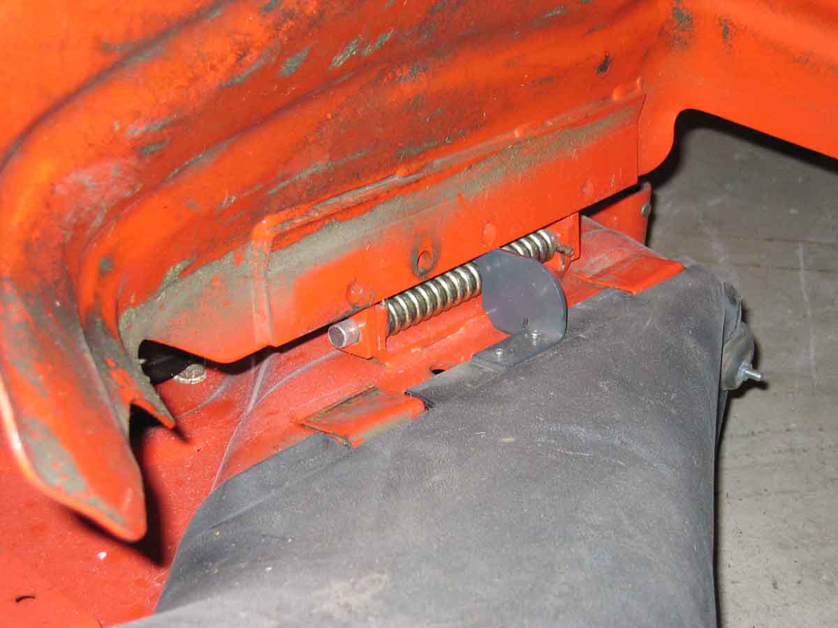

Here is the deflector shield attached.
