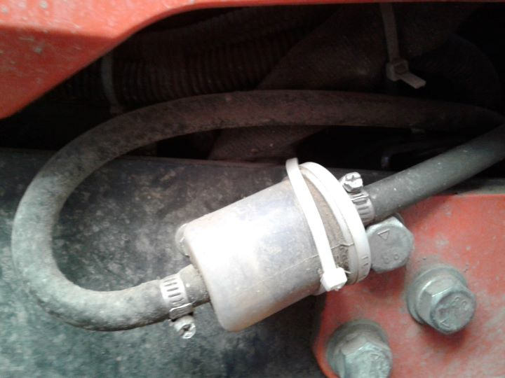

I have searched and haven't found anything on this. Lots of posts, maybe I missed it. I have changed my underbody fuel filter several times and I am sick of doing it. Usually because it clogs in the winter.
Is there any problem with just moving the underbody fuel filter under the hood? Has anyone done this? Just running two hoses from underneath and putting a stock or similar filter on the hoses, and strap it down under the hood. Seems to be plenty of places to strap it on. Thanks in advance.

Only concern it that that filter is before your lift pump under the tractor. If you relocate it there will be no filter keeping trash out of the lift pump.

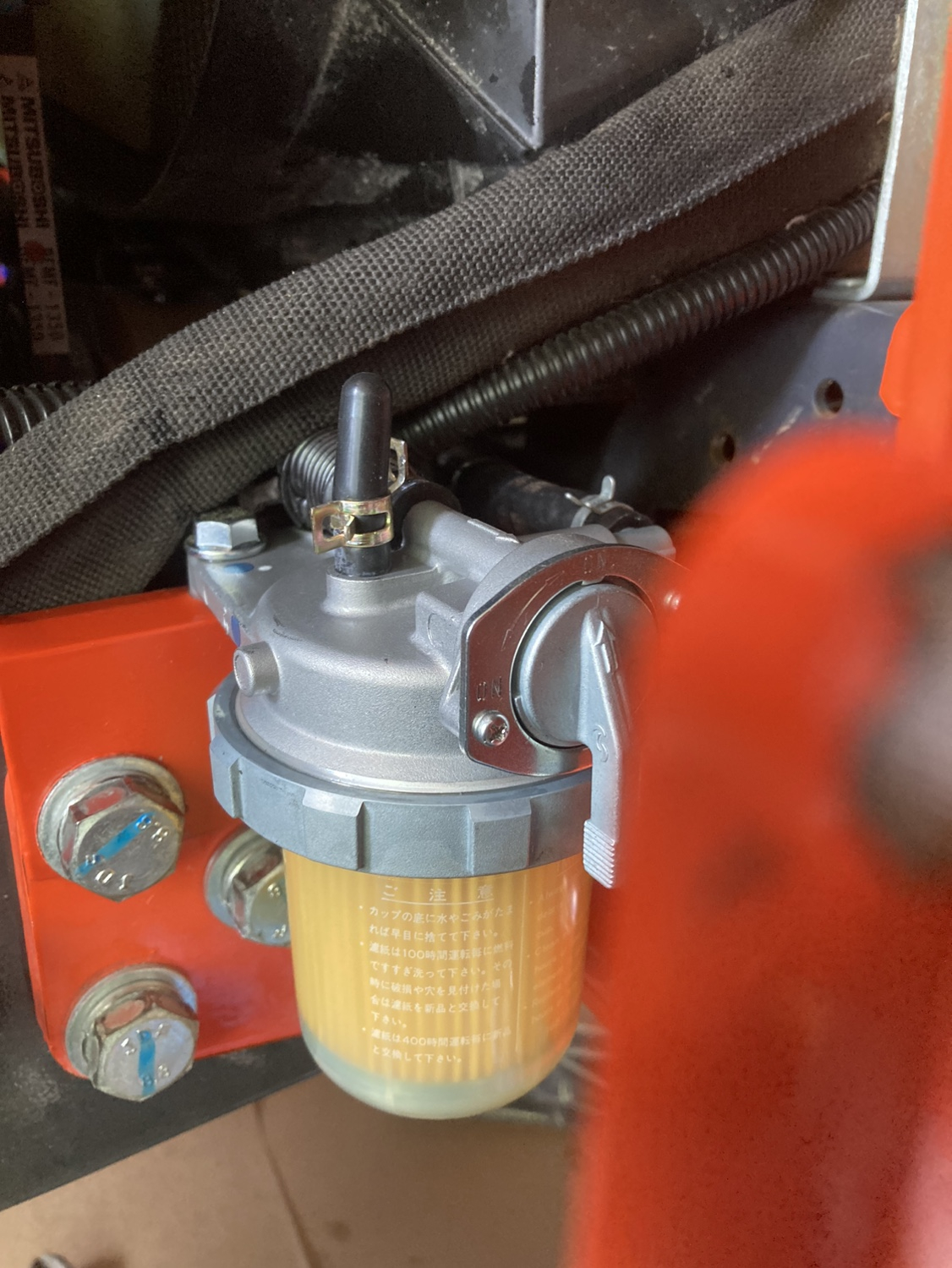

   / BX Move the fuel filter without a kit? #6
Interestingly, both of my Kubota's have factory welded tabs on the right loader upright to relocate the fuel filters (which I have never done anyway). Instead a installed a Racor in line filter before the OEM filters and I've since never fiddled with them Just change the spin on Racor filter which has a see through bottom bowl so I canh see how much contaminates are present.

That shouldn't be an issue as long as the filters position in the fuel system is not changed. If I remember correctly, the BX fuel system is the same as on my ZD326 and previous ZD331 mower : Tank > Filter 1 > Electric Lift Pump > Filter 2 > Injection Pump.
I replaced the first inline filter on my ZD mowers (not the current ZD1211 though) with a large 2 micron cartridge filter. I've never had to bother with the second inline filter since.

This picture is what I did with mine. There is a fuel line running to the tank from this new filter and then back again to the fuel pump. I can’t think of a reason you couldn’t just use a factory filter in this spot instead of the Racor unit I used. Sorry, forgot the picture.

You need about 7' of fuel line, splice and some decent clamps. keep relocated filter low - it' gravity feed from the tank.

i moved the filter and fuel pump up under my hood. Removed the oem filter before injector pump and added a filter with sight glass bowl and shut off . Ever thing all in one small spot.

Yes, the filter physical location shouldn't matter, as long as the hose arrangement keeps the filter in line upstream from the fuel pump. I bought a kit with a spin on filter, but there's no reason you couldn't just relocate the original one yo make changing it easier.

I made my own setup after seeing someone charge $200+ for it, mounted it on outside of left loader saddle.I bought all materials for about $150(bought a 6’ piece of 2-1/2” aluminum angle ($30)and 25’ of fuel line off eBay(around $20)The oem Kubota filter housing was $80, the 5/16” hose splice about $5 from Napa, some black plastic wire protector (1/2” I think) from Harbor Freight for around $5 to protect line from rub spots, some spring hose clamps for around $5, and some zip ties. I made one for my BX1870, then another one for the BX2380( had the angle and fuel line already from first one). Custom made the mount bracket for fitment from aluminum angle. Where filter is underneath is where you put the hose splice, then run the line to the outside mount, then I ran a line back to the inline electric pump. Only thing I don't like about the Kubota housing over the Racor is that it doesn't have a drain on bottom of bowl...
