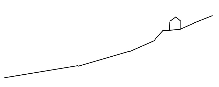

I bought a BX for the lower center of gravity. Five acres on a sidehill was a strong point in its favor. A B probably would have rolled once or twice by now, as I have had the BX close.
If I had flat land, I would have a B.
