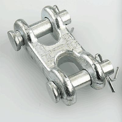

You're right. I came to this same conclusion after I thought about it some more. Looking closely at Walt's setup, he actually made "keyholes" in the ends of the flat pieces to allow the use of what looks like the original clevis. Quick links like you use to connect chain might work as well.

I don't know why, but I was always afraid to use the quick links except in light load applications. For the stabilizers, I guess they'd be more than adequate.
Yep, I like Walt's installation!
