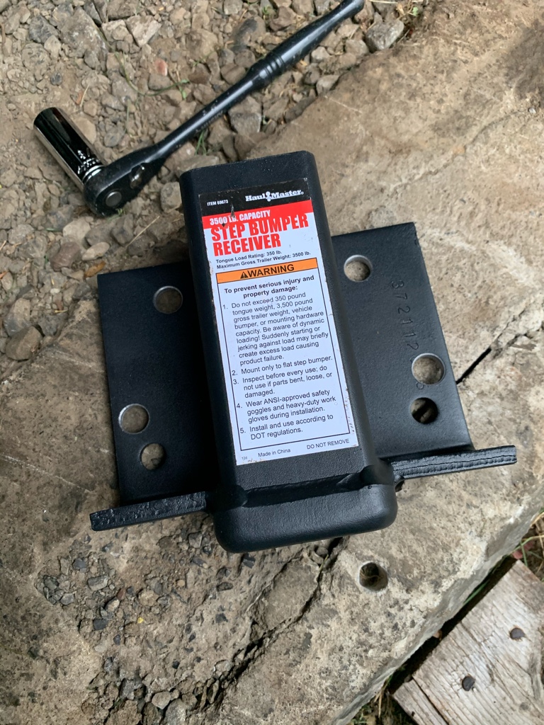

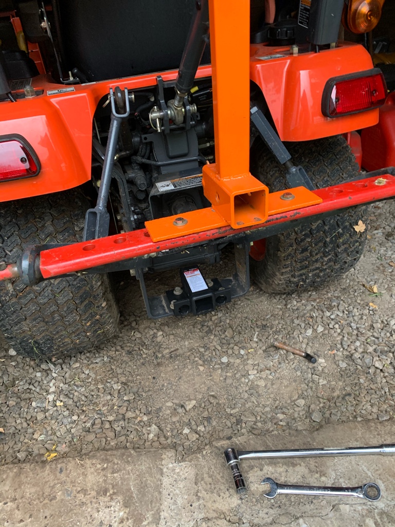

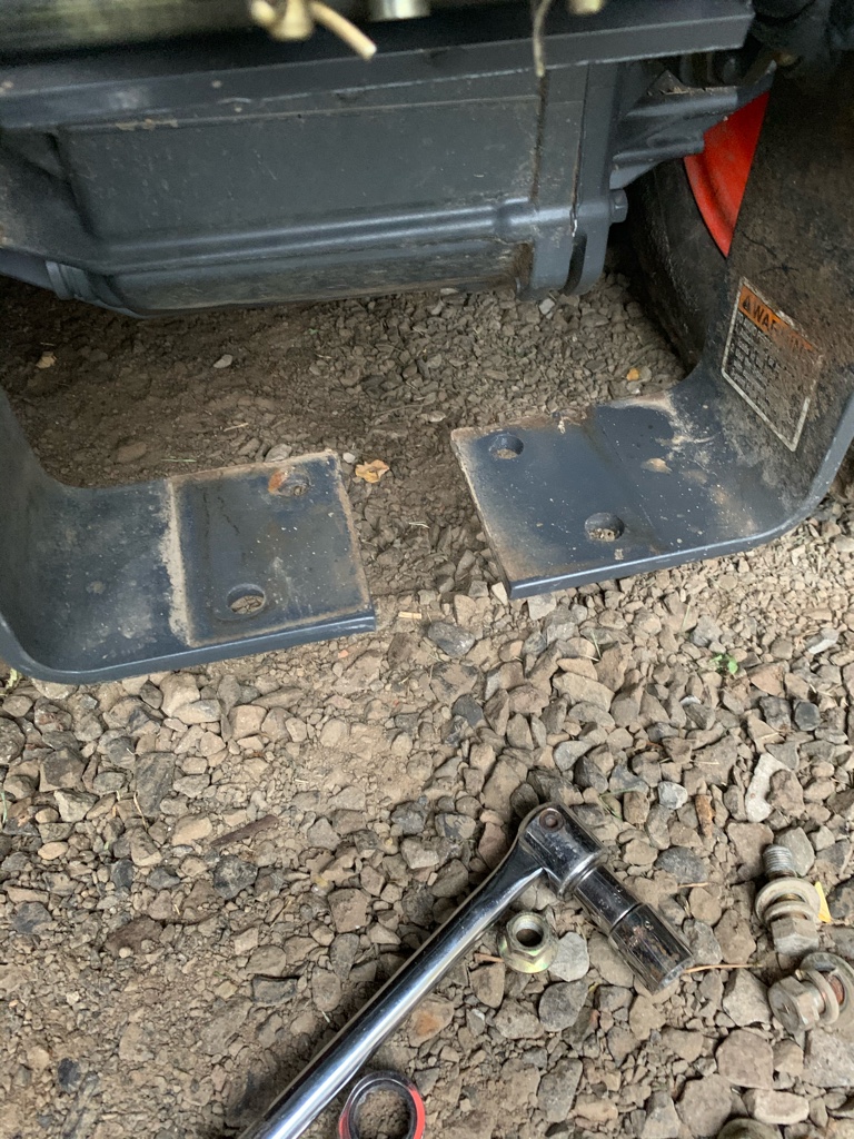

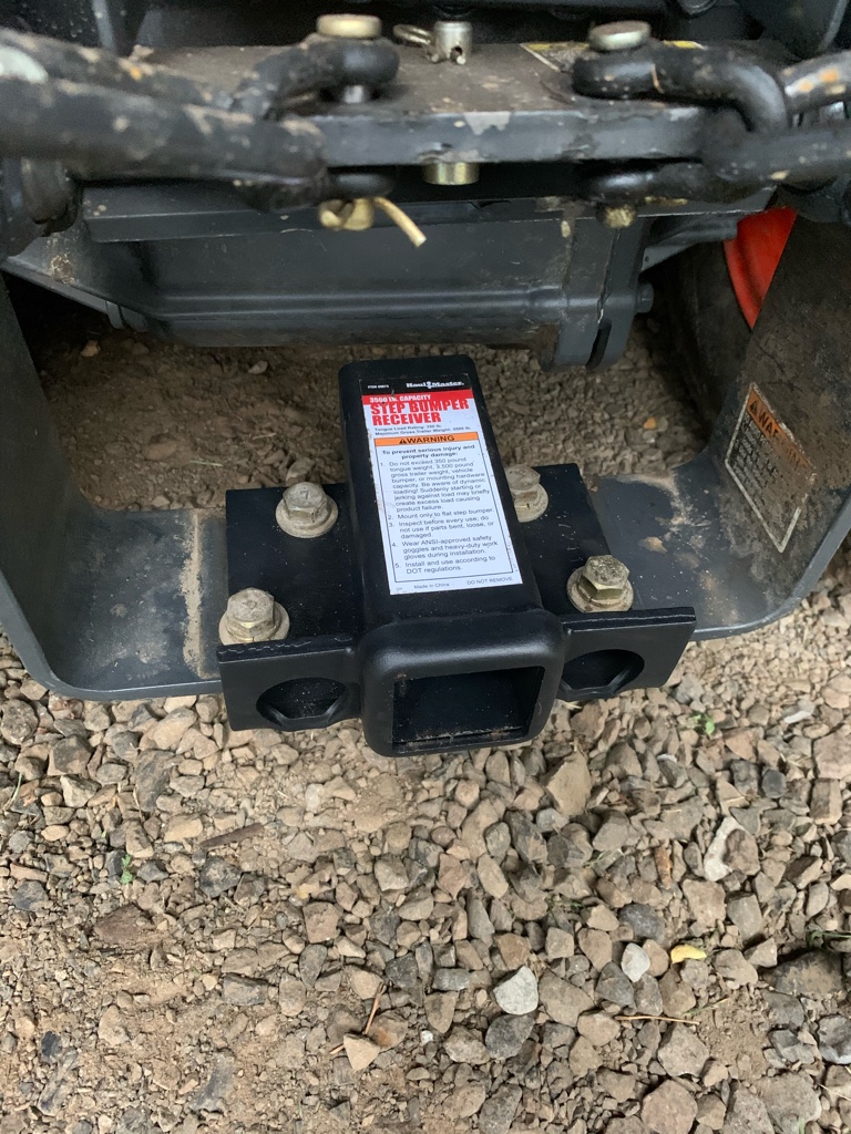

I modified the Harbor Freight step bumper hitch to be used as a hitch for my BX. The rear holes lined up perfect just had to drill them out to the next size or two larger. Front holes didn’t match up, so had to drill new holes. I see these for sale $60 and up, this cost me $17.99.

I did the same thing. You need to be very careful of tongue weight. I could not move a 20' travel trailer, front wheels came off the ground. Had to put 500# of weight in the FEL and it still was squeezy. Devise a hitch on the FEL, put 400# of suitcase weights on the rear QH. Worked great plus I found pushing rather than pulling is far easier parking it where I want. I even use that setup to move my 5000# capacity dump trailer full of gravel and my 16' lift bed machinery trailer (it weighs at 4,000 empty).
