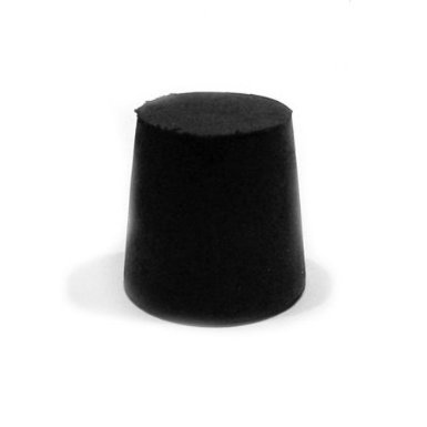

A picture is worth a thousand words.....BX22 strainer screen.
All hydraulic oil drained out when screen was removed have catch pan ready.
   / BX Transmission Filter Change #28
A friend of mine changed just the spin on hydraulic filter on his bx and the only fluid he lost was the fluid in the filter. No vacume cleaner was used, no jack stands and no jacking the tractor up on one side. He just spun the filter off and spun the new one on. No mess no fuss.....I know I was standing beside the tractor when he did it.
Pulling the suction screen is a whole different ballgame. I you pull the suction screen with out draining the fluid before hand you will have a huge mess to clean up.
   / BX Transmission Filter Change #29
You won't lose much fluid by just changing the filter, especially if you're prepared and make reasonably quick swap.
On the screen, being prepared with a 1" tapered rubber stopper plug and you'll lose only an ounce or two of fluid. Just another option to the vacuum method if you don't have a helper or shop vac. These cost only a buck or so at your local hardware store. You can pull that screen and clean it whenever you wish with no meaningful fluid loss.
Most all this is just a matter of being prepared to do the job.
   / BX Transmission Filter Change #30
You won't lose much fluid by just changing the filter, especially if you're prepared and make reasonably quick swap. On the screen, being prepared with a 1" tapered rubber stopper plug and you'll lose only an ounce or two of fluid. Just another option to the vacuum method if you don't have a helper or shop vac. These cost only a buck or so at your local hardware store. You can pull that screen and clean it whenever you wish with no meaningful fluid loss. Most all this is just a matter of being prepared to do the job. <img src="http://www.tractorbynet.com/forums/attachment.php?attachmentid=464587"/>
Yes the cork works great. Just be ready.
