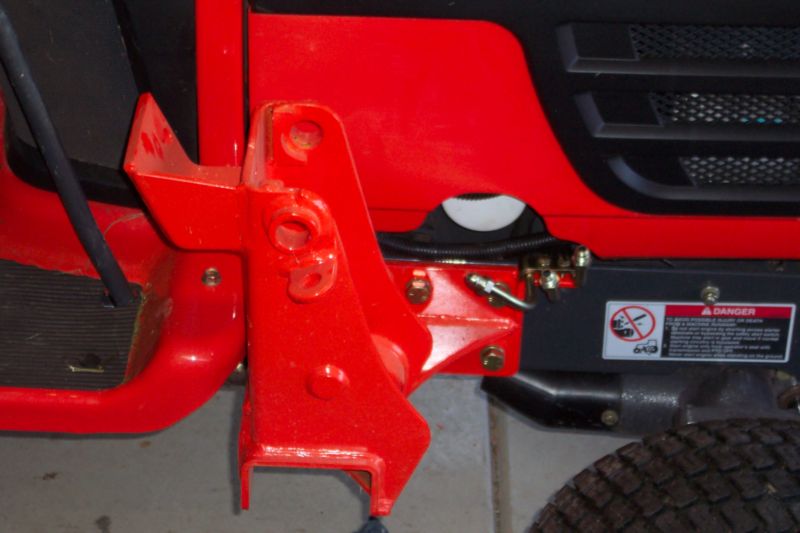

I then installed the second set of lines that connected to the first set right below the engine.Once I figured the lines all out I then installed the right side mount.

   / BX1500 FEL Questions and Idle Questions #12
Your garage is WAY TOO CLEAN!
Ron

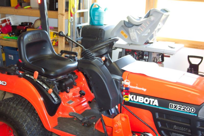

Now it was time to mount the Joy stick controll which was all assembled from the factory.This was just a matter of bolting the hole assembly on and attaching the hoses to the lines I had run. Thank you Ron, give me time I just had the home built so we have'nt been there a year yet /forums/images/graemlins/grin.gif

   / BX1500 FEL Questions and Idle Questions #14
The last step was the fun part putting the arms on and attaching the bucket. I will admit it was alittle trying to get the loader on and off the first few times,but now it takes me under 5 min.
   / BX1500 FEL Questions and Idle Questions #15
I hope this helps Apollo I know I had fun doing it and I would rate this project a 4 on the scale of 1-10 for difficulty.Someone earlier said for $250.00 have the dealer do it, but don't foget you have to load the machine up and drop it off of at the dealer and the go pick it up too.Unless the dealer does this free I think it was easier to just do it myself.The only hard part I found was when running the steel lines the instructions were very vague and it was a little confusing on what line to put where.But don't worry it's nothing earth shattering
#16
Man oh man now that was some excellent detail and explainations!!!!!!!!!! Thank you.

   / BX1500 FEL Questions and Idle Questions #19
Apollo;
Did you have to add extra oil to make up for the extra line capacity?????
Yes the dealer GAVE me a gallon of super UDT fluid I think it took about 1/2
As for the valve:
While shopping around I learned that there was a 3 position and a 4 position valve that came with loaders. The Blower NEEDS the 4 position valve.I was also told that all new loaders came with the 4 position now. The valve assembly is it the joystick set-up and comes with the loader, so I don't know what happens if you buy the blower first with a valve and then get a loader.You better check this out carefully with the dealer.
As far as the lines went It was trial and error for me.I did it wrong the first time and when things did'nt line up I took them off and got lucky the second time.If you decide to do the yourself I will take pictures of the lines under my machine so that you can follow them.
Good Luck
Rich
