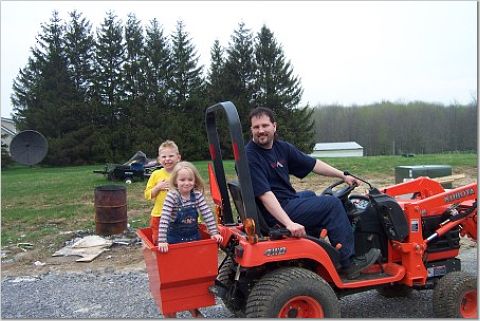

I got one. You can see it's not so deep. This holds up to 300# and I found 3 bag of sand 70# each is plenty of ballast for most things except maybe boulders which probably don't belong in there to begin with.
