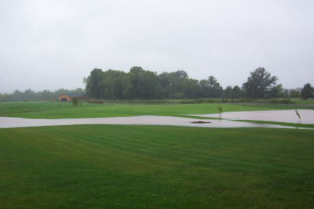

I also did not have any weight on the rear of my BX2200 when I installed the loader.It took me about 1 hour of real FEL work to realize I had to get some weight.I pondered the question of having the extra weight all the time or have it removable such as a 3pnt hitch set-up.Well I looked at them big Ole turf tires and decided they were just too darn wide to make ruts so I filled the tires.I feel that if the ground is wet enough to make ruts with them big wide tires that maybe I should be parked in the garage and not mowing grass.Kinda like the pic shows.This was my back yard for a week this summer.I needed Pontoons /forums/images/graemlins/grin.gif
Just go do it,Fill them tires. /forums/images/graemlins/smile.gif
