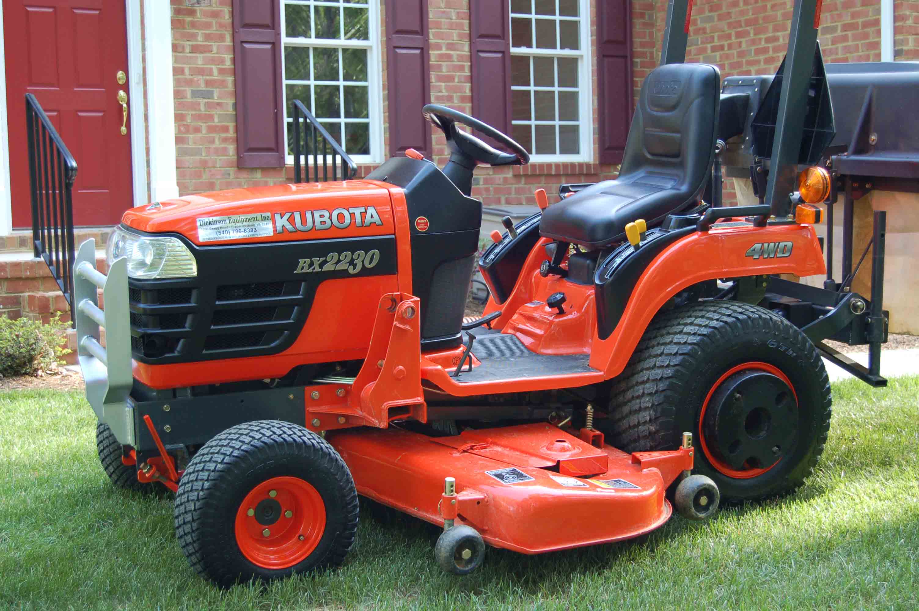

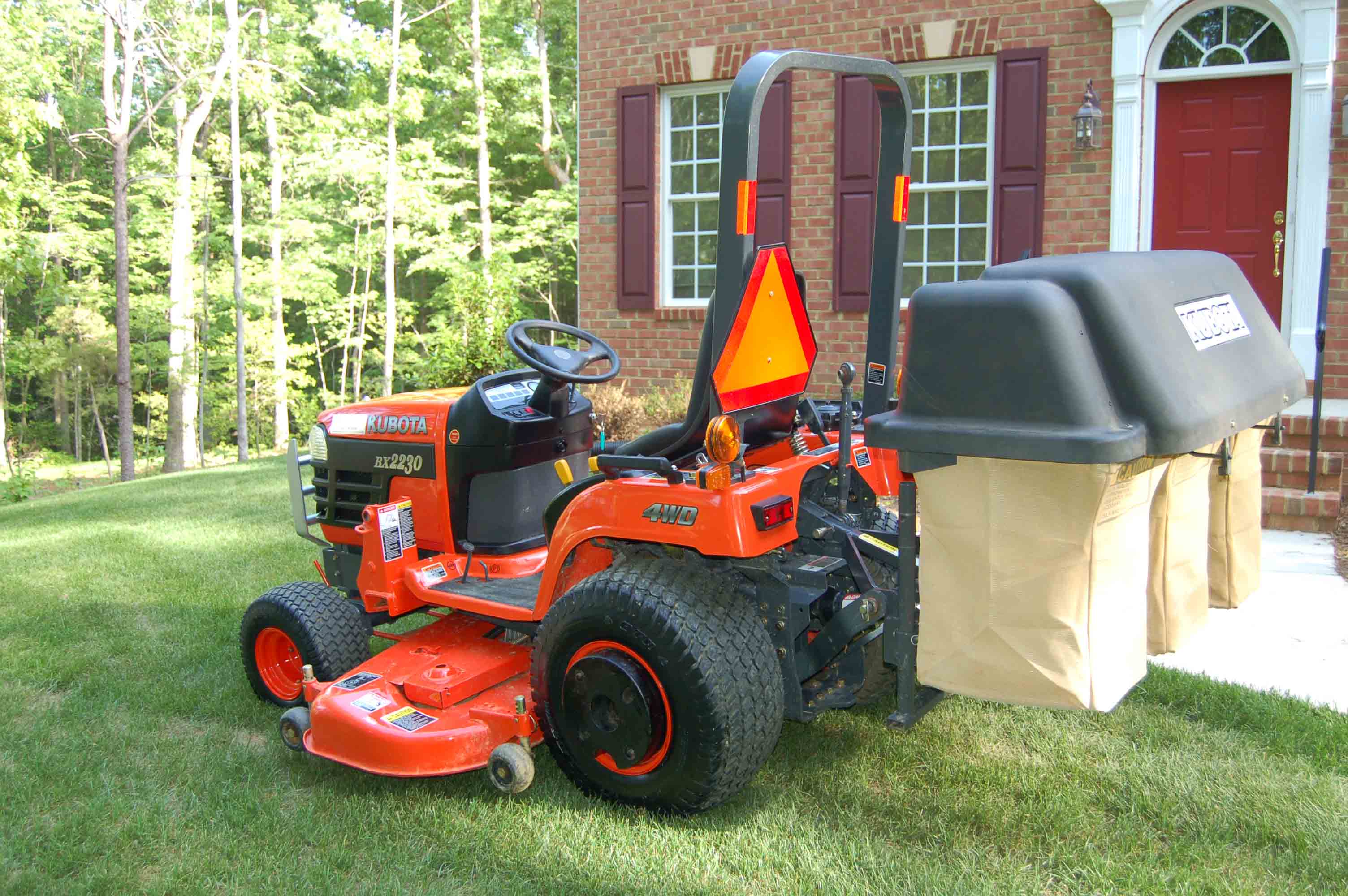

Attached are three pictures that show the wheel weights. They attach to all-thread studs that are jam-nutted to the rim. They do protrude a couple inches from the rim, but I honestly never know they are there...that is unless I take them off!
They sure make a big difference to the overall feeling of stability, especially when doing FEL work without a ballast like a BB hanging off the back (when I have my hitch attached, for example, when clearing the yard or doing mulch work). And I think they add more weight than filling the tires. Guess you could do both, but I didn't want to mess with fluid unless I had to. Sure it's easy, but anything 'special' will end up being a pain sooner or later.
Just saw kwolfe post...as I mentioned, I don't TRY to rely on them exclusively, but I find myself in a great many situations where my 3PH is being used for something other than holding ballast.
The tractor actually came with the weights. My dealer doesn't sell BX tractors any other way and they were baked in the price. Unfortunately, I can't tell you how much they were or who makes them. They fit the rim bead PERFECTLY, but that could be just since it's a pretty standard rim and you can get these things most anywhere.
