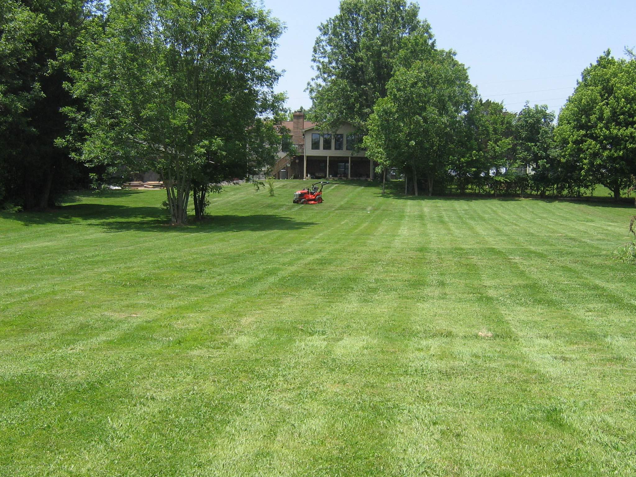

I've been running GB's on the 60" MMM on my BX23 for 6 seasons now and I like the results quite well. I ran the OEM regular lifts for the 1st season then switched over to the GB's ever since. This season I switched over to the hi lift 3-N-1 fusion mulchers and it appears they do have more lift over the std GB's. I mulched up my 1st batch of leaves for the season yesterday and they shredded the leaves up quite well. I bag all my leaf cuttings and every other finish mow for my yearly compost pile and so far it seems that these newer blades slick & dice finer as I'm not having to make as many trips back to the compost pile to dump the CR.
When I don't bag I mow each row in opposite directions and get a sort of stripeing effect.
To be truthful, I've run the GB's for so long that I can't recall what it was about the std blades that drove me to seek different blades but I do know I'll stick w/the GB's :D
Dave
