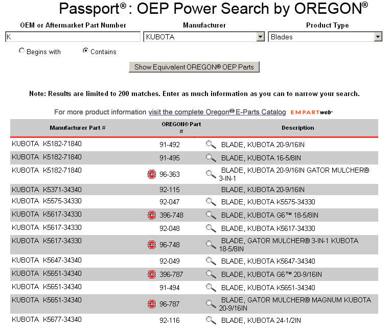

Hi,
I have a 2010 Kubota BX1860 with a RCK54-23BX mid-mount mowing deck. This is the same deck used with other Kubota BX series tractors as well, including the BX2360, BX2660, and BX25.
I am looking for a Gator Mulcher blade for this deck. I have not been able to find one that matches on your site, and a search via Google shows others having the same problem.
The blade on this deck is an 18 5/8" long with either a 7/8" [0.875"] or a 29/32" [0.906"] center hole diameter.
In order to use Gator Mulcher blades on this deck, many folks have had to either drill out the center hole in a non-compatible, smaller diameter center hole blade, or make bushings from a Cat1/Cat2 adapter to fit a larger diameter hole blade.
See also:
http://www.tractorbynet.com/forums/kubota-owning-operating/173853-bx1860-54-mmm-rck54-23bx.html
and
http://www.tractorbynet.com/forums/kubota-owning-operating/171351-bx1860-54-deck-gator-blades.html
What Gator Mulcher blade fits on the RCK54-23BX deck?
Thanks for any help.
Regards,
TBN user wrooster
   / BX1860 54" MMM RCK54-23BX -- What hole size /or/ PN Gator Mulcher blade? #12
Has anyone found a different or newer Gator P/N that works stock without having to modify the deck?
   / BX1860 54" MMM RCK54-23BX -- What hole size /or/ PN Gator Mulcher blade? #14
I just wrote to Oregon Tech and got this back.
Could you please give me the Oregon blade number for a
Kubota RCK54-23BX mower deck? Thank you.
The part number would be 396-812. This is a new addition to our offering and will not be available until later this month.
Thanks,
Dennis Wainwright
Manager, OEP Technical Service
Oregon Outdoor Equipment Parts
Kansas City MO
Phone 800-743-3150 Ext 307
Cell 816-591-3304
