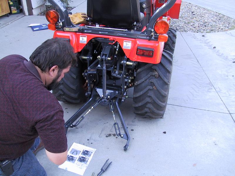

David,
I got my BX22 yesterday. Henry delivered it and spent about 3 hours showing me how to remove the backhoe and assemble the 3 Point hitch. It was so hot that he drank about a gallon of my ice water. As to the 3 way valve. I spent 3 hours moving dirt and rocks with the loader. I can't imagine wanting the bucket to drop any faster than it does. I don't think I will ever need a 4 way valve. No snowblower and I can use the box scraper easier than a blade on the front. I think it is a great toy (tool). I told my neighbor that came to drool, it was a tractor, dunebuggy or a Harley Screamin' Eagle Deuce. The Harley's are all sold and I have lots of yard to play in. I'm Happy, hope you get yours soon.
