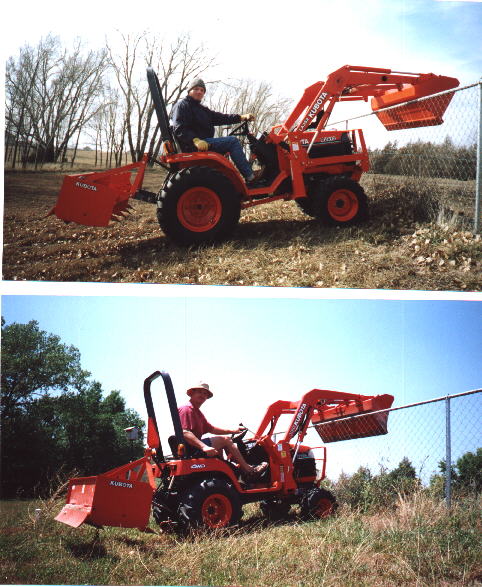

How important is postion control? Dealer says you can do it on the BX just not accurately or repeatably. Need to maintain a small minibike flat track, smooth out ruts, level, etc... Also, I need to remove/move basketball size rocks and smaller a lot. Will the BX do it?? I'm leaning BX but need a push. Also about a 1-2 acres to cut, up a down hills. About 1-2 mi. of wooded trail maintenance, etc.... Thanks in advance. First real tractor.
   / BX22/B2410? Help me get off the fence #2
Either will do the job you have described, with the 2410 probably able to do them a bit quicker. You need to consider whether the extra size of the 2410 will work against you though. Sometimes larger is not necessarily better. The BX has a definate advantage on hills due to it's lower center of gravity, and it has other advantages as well, especially the MMM mower. Sounds to me as if the BX will do the job just fine, but if you want bigger, the 2410 is a fine machine too....
   / BX22/B2410? Help me get off the fence #3
yeah, you can bump the 3-point lever but it is kinda diffucult to get exactly what you want. PC is way better. I do not see though from your description why that might be absolutely needed. Now the trail thing? what is it with these trails you guys all have anyway. I have seen trails a goat could not walk much less a tractor so I cannot advise you. The BX has somewhat lower ground clearence than the 2410 so that could be a problem on your trails?--maybe not. The BX on the other hand could manuver better in places and get under things better. Both pull small discs, boxblades, back blades, harrows, chain harrows, spreaders, rakes etc. J
