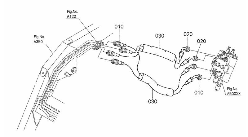

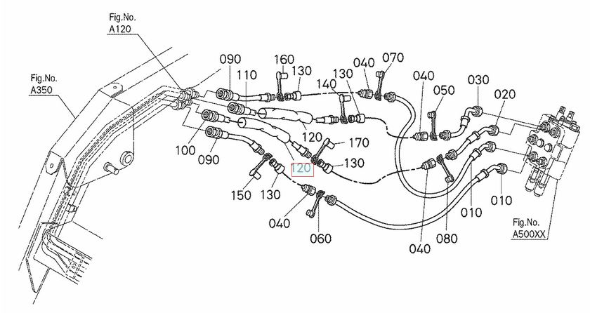

A little background. I recently acquired a slightly leaky BX22 and assuming I had a 3 way control valve on the loader i ordered all new hoses coming out of the control valve from the dealer. When I went to install I realized hoses are all different and that is when i went back to schematic and realized i had a 4-way C/V. I know, dumb of me not to even click on that pic to compare earlier but here I am. After examining everything I decided to use these hoses to connect my 4-way valve onto the loader as i couldn't find a difference in the schematic below other than quick-disconnects on the 4-way one for installing something other than the loader. See below pics, no difference. And as a tip for anyone looking for new hoses for their LA210 loader, you should be able to use the ones from 3-way control valve as they should be cheaper by a good margin avoiding all the quick disconnects and extra hoses.
3-way C/V hoses:
4-way C/V hoses:
I got all the hoses hooked up and paid special attention to make sure I connected the right control valve outlet to the right color rigid hose on the loader as they were before. As I was doing this, some fluid leaked out from lines and the right cylinder on the boom of the loader compressed a bit (but not my left one) causing the loader to sit crooked so I couldn稚 put the loader back onto frame properly. I figured, that is fine and I will just hook up hydraulics, run it and compress both cylinders all the way and then pull them back out. So my left cylinder was out while my right one had compressed a bit, I figured from some fluid leaking out while changing out the hoses. I finally got all the hoses and quick disconnects back together and got the tractor close and connected hydraulics and ran the tractor for a little while to get the pump running properly and pressure in the system up and hopefully work out any air out of the system (hopefully that is how that works?). Then using the control lever I compressed both cylinders all the way in, motion to lower the loader arms. To my surprise when I pulled lever the other way (motion to raise the loader arms) to pull them both out, only my right cylinder is coming out (one that was originally compressed), while my left one just sits there in the closed position. I still can't get the loader onto the frame of the tractor because now the left one is all the way in and that is making the angle of the loader arms impossible to properly seat onto the frame.

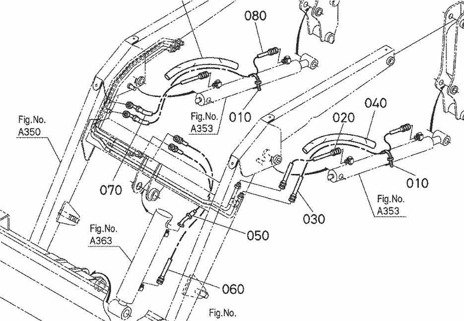

Here is schematic of loader rigid lines, sure looks like same lines feeding both cylinders (20 and 30), and I only replaced the soft rubber ones coming out of the control valve. The other lines (50 and 60) feed the bucket control cylinder. So if one cylinder is operating the way it should, leads me to think i did connect all lines properly and instead something went wrong with cylinder itself. Could there be air in the system not getting purged by the pump or something? ugh, so frustrating. i thought i was finally done fixing up and ready to work and now this...

Those cyl are supposed to be in parallel, and they should both work together, however, one cyl may offer less resistance and retract the other.

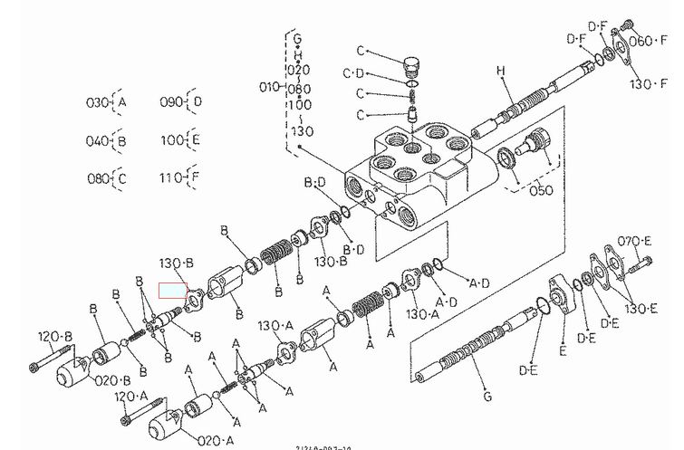

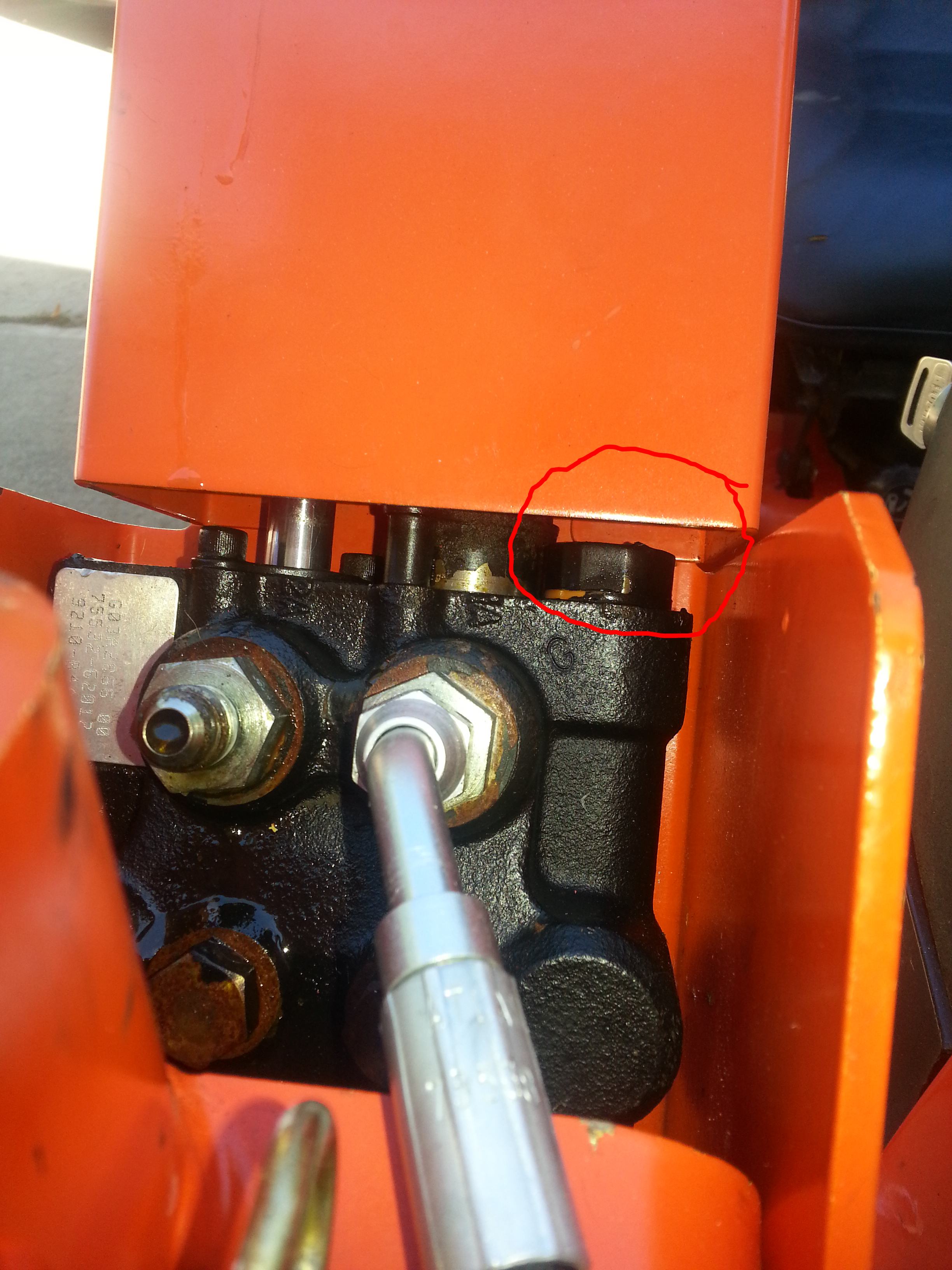

Now, just as I thought I could go and get some work done, a new problem cropped up. the bucket will not raise, only dump. It will not raise even a little bit. So as I was messing with it, little by little, now it is in the all-the-way dump position and will not come back up at all. And I know my bucket worked just fine before, whereas i cannot guarantee my loader cylinders worked in sync before (it only seemed like they did). And my loader control valve when running tractor and trying to move loader is leaking a ton of hydraulic fluid from what looks like the relief valve on top and it is running down the back of the control valve and coming down onto chassis. Could my control valve be clogged up somewhere inside? not allowing any fluid to one side of the bucket cylinder and creating excess pressure resulting in relief valve leaking from the top?
Although i thought I read somewhere these units don't have a relief valve on the loader control valve, only the main one over by the main hydraulic pump under the seat of the tractor. And now looking at picture of Husco 9210 from their site, what they say is relief valve looks nothing like the one I have. Everything else looks the same, but where they say relief valve is - it is a lot shorter and kind of looks sealed on mine. Soooo. what the...

In that picture it looks like the o-ring has blown out under the plug.

so just took kid to soccer and got a little bit of time away from all this to clear my head. gonna take a break for the night and tomorrow again take apart the control valve setup and hoses off of it and see what's up. ozley - you might be right, that may be a blown o-ring. This is my C/V:
The "Shut Off Assembly" is part number 50 so that piece that fits under the nut could be the issue. That would explain leakage from up there and could be responsible for some pressure loss in all this, but I don't see how it may be related to my bucket not lifting up. Unless someone else has some suggestions, after I take apart tomorrow, clean (again) and put back together hopefully it will work. If not, I may look into sending this C/V for a rebuild - found a place up in Akron, OH. New one is $800, so hopefully these guys will rebuild it for significantly less than that if I end up doing that. Fingers crossed for a miracle overnight :/

I could be wrong, but that hex nut assembly on top by the spool shaft looks like a plug that they use when that valve is used in a closed center hyd system, otherwise, no relief
Most open center valves have a working relief.
I see no shims or adjusting nut.
Now as far a rebuilding that valve, you can get a new loader valve with float and regen from Surplus for about $241 and you will need the PB adapter also.
Surplus Center - 2 SPOOL COMPACT 10 GPM JOYSTICK CONTROL VALVE
Surplus Center - BRAND POWER BEYOND KIT
Surplus Center - 2 SPOOL 14 GPM PRINCE LVR JOYSTICK LOADER VALVE
Looking at this PDF, it looks like you have what is called a SHUT-OFF plug instead of a relief valve. A direct acting relief valve will have some kind of adjustments. Read the PDF and you will see the relief valve you should have.

The BX22 has no pressure relief valve in the control valve. The PRV is in the side of the trans inside the right rear wheel.
Parallel cylinders almost always move separately when they aren't attached. The one with the least internal friction moves first. If you continue to extend, the other will "catch up" when the first one hits resistance or the end of it's stroke. They are doing equal work when attached to the loader as the friction difference is negligible in operation.
I don't have enough info to guess why the bucket won't curl other than the possibility that the lines are connected incorrectly.

Ok, just got around to doing some work today. Took hoses off the C/V and put it on a workbench. Replaced the shut off valve that seemed to be leaking, and when taking off the old one didn't really notice anything wrong with it, looks weird in that pic because the black paint that was over it was chipping. That had me thinking - oh ****. Then poked the c/v outlets responsible for bucket with a skinny hex thingy. then cleaned and re-assembled it back onto loader and reconnected all hoses. If this didn't work my next step was to call the dealer to come pick it up and figure it out.
Fired it up, got it warm, increased the RPM's raised the boom and (after saying a prayer) curled the bucket. Couldn't believe it. Works just fine now. And with replaced hoses and shut off valve, no more leaks either. I was so happy, took it for a ride around the neighborhood.
