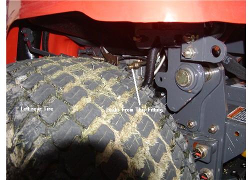

Just wanted to update you on the leak. I've been waiting for the dealer to get the parts in for the faulty "sending wire" for the fuel guage then the oil leak will be fixed.
It is definitely hyd. oil. The leak has gotten 100% worse since I first noticed it. The reason: I have not used the 3 Pt. hitch for any rear implements yet until now. The slower leak was a result of the up and down of the MMM. The use of my new post hole digger had it squirting out. There was/is a loose fitting on a solid hyd. line on the inside left tire just under the fuel tank, where it looks like it joins the rear trans/upper arm lifts. There is a set screw there as well.
I cannot get it tight enough to stop it from leaking out even though it was very loose. The fitting looks as thoughit has a crush washer on it. Well that's the story for now. I'm sort of glad I know at least. I'll feel better when I get it fixed. Long winded sorry 'bout that.

This is a picture from farther out to give you an idea of the location. The next picture is closer in.

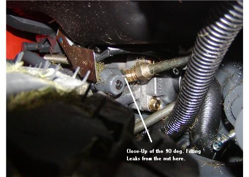

Close-Up of 90 deg. fitting.

Well the part finally arrived and I got the tractor fuel guage fixed and the hyd. oil leak taken care of this past week. The float in the tank seemed to be the issue with the gauge and the leak was an o-ring. I was out digging holes with it this weekend and everything seemed to work fine. That should do it for now. Thanks for all your input.
