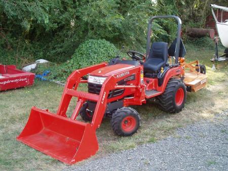

   / BX23 Attachment questions and advice wanted. #24
Here's a picture of my BX with the mower deck raised to full height. It's hard to see, but hopefully will give you an idea.

#26
Thanks Greg,
It looks like about 6" lift under the mower deck, which seems to be pretty decent clearance all things considered. Depending on how steep the ramps are for the trailer I might have to load with the trailer on a slope? Time will tell I guess.
Scott

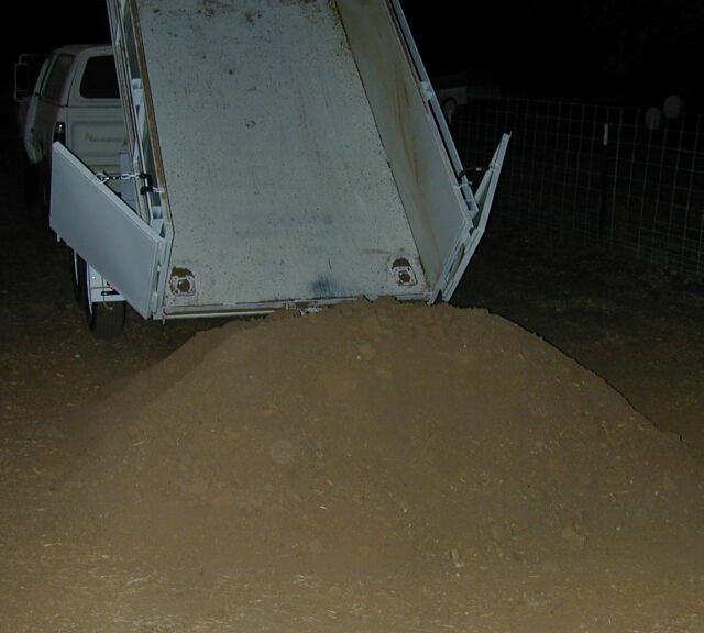

   / BX23 Attachment questions and advice wanted. #30
LB, why NOT a dump trailer !?!? Can't imaging being without one. Try it, you'll like it /forums/images/graemlins/grin.gif
