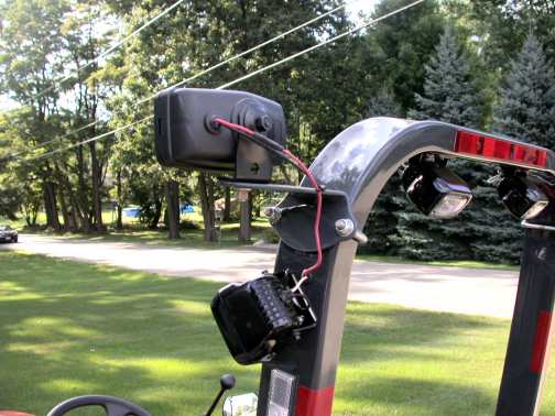

I also wanted to add more lighting, I wanted a set for the back and a set for out front and a set for lighting up the front tires and mower deck edges. This is what I came up with. All three sets are 55 watt each and run on seperate fused circuits connected to the battery. I also drilled my ROPs but only small holes and taped them for 10-24 screws to hold two sets of lights. I made brackets that mount with u-bolts for the last set of bigger lights (after reading about not drilling the ROPs) and I did install the alternator upgrade.
Scott
