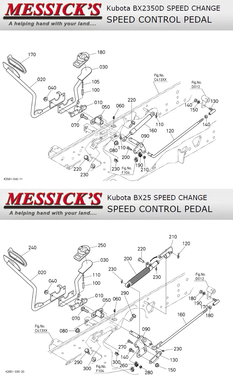

No matter who did what and with which and to whom; is there a work around solution ? like adding a bigger return spring?
   / BX2350/BX24 Abrupt Reverse Stop
#34
... is there a work around solution ? like adding a bigger return spring?
The attached image shows the old and new damper assemblies (I hope it's OK to use the Messick's part diagrams here). Here is a list of the BX60 series parts that would be needed to convert the BX50 series (# in diagram, description and Messick's price):
200 Kubota 32721-43350 DAMPER, HST $91.25
210 K2651-42132 STAY, DAMPER $6.72
220 05112-50825 PIN $1.67
230 K1211-91120 RUE RING COTTER $0.88 (x3)
090 Kubota K2651-42044 LINK, HST PEDAL $16.22
130 Kubota K2651-42140 ARM, DAMPER $8.49
160 Kubota K2651-42172 ROD, SPEED CHANG $12.14
140 Kubota K1122-91332 BOLT (SHORT SQ. $0.88 (x2)
150 Kubota 02751-50080 NUT, FLANGE $2.52 (x2)
I'm tempted to do this but I think I have to resolve another issue first, in that the swashplate in the HST exhibits some friction in returning to neutral. I say its the HST and not the pedal or linkage needing grease since it is perfectly smooth when the engine is off.
Several people over the years have come up with great ideas as to how to fix the problem and as of this date none of them have came back with an actual "I did it" and how I did it and fixed the problem (mistake).
As of this date the only ones that have said I fixed the problem have fixed it the same way I did, they got rid of their 50 series BX.
