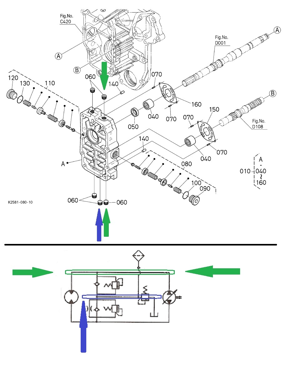

The attached image shows what I have planned. It shows both the part diagram for the "ASSY COVER PORT BLO." and the hydraulic schematic of the HST courtesy of Oldnslo. The colored arrows show the areas on each diagram which I think match each other.
Unfortunately, the problem with just rigging up a needle valve between the green and blue ports is that they are right above the mid-PTO. Having fittings hanging out of them would prevent the mower shaft from being attached. I may temorarily just test my theory first without the mower attached. If it works, and I can identify an actual orifice size, I may try to drill an orifice into the forward check valve.
Good luck with this. I worked on this problem on and off for a couple of years but did not want to ter the tranny apart due to warranty concerns. Could you install a fitting with orifice Vs the needle valve. This would give you a better idea of the orifice size but would require more work to adjust the size. I would guess that .020 would be the smallest diameter i would consider.
NOTE: This will detract from your top speed since you will always be losing some flow across the orifice which will also add more heat to the tranny.

I completely agree. That is actually why I was hoping to see a copy of the BX25/xx60 hydraulic schematic. I have the one for the BX23 which has orifices forward and reverse and does not have the problem, then they removed the forward one for the BX24/xx50 series and started having the abrupt reverse stop problem. Then they did something for BX25/xx60 to resolve it.
The thing that makes me hesitate to add the orifice is that while it would likely ease the problem, it would certainly bleed power like you mention. I'm wondering if that is why they removed it for the BX24/xx50 series to begin with. I'm very curious to see the BX25/xx60 schematic to see if they simply added the orifice back in and ate the power loss, or if they did something else with some kind of control valve that doesn't flow under normal forward motion. The parts diagram doesn't look any different though so I doubt its anything that fancy.

I believe the actual fix is in the linkage and the hydraulic damper on the foot control. The 50 series slowed the return from the forward position only. The 60 series slows it from both forward and rearward positions.
There are lots of different parts in the linkage. I would guess they would retro-fit.
After all my jabbering about this, I realize now that you are right. I've compared the HST hydraulic schematics for the 50 and 60 series and there was no change. I also did a "push test" on my BX2350 and a new BX2360 in the showroom and that suggests that a flow restrictor was not added to the forward circuit like I mistakenly thought (i.e. in high gear you can push the tractor forward, but not backwards).
I then noticed the enhanced pedal damper you mention. The new model does dampen from reverse to neutral whereas mine does not.
Using the Messicks parts diagrams I ID'ed the different parts. They are about $140 altogether. I'm not sure it is worth that much to me.
