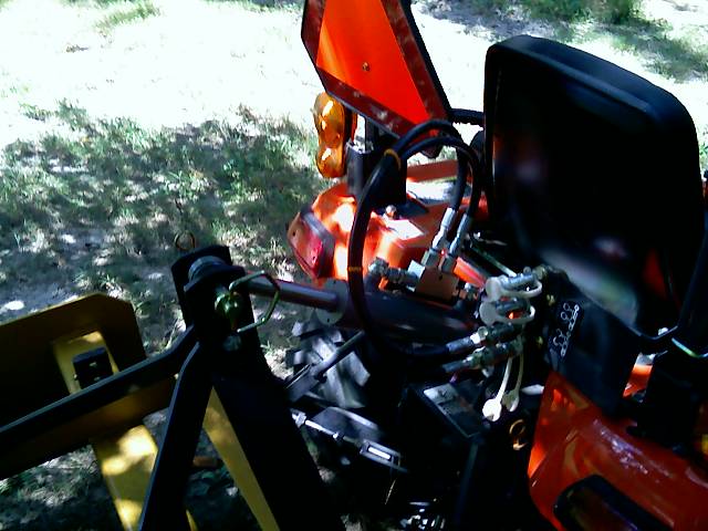

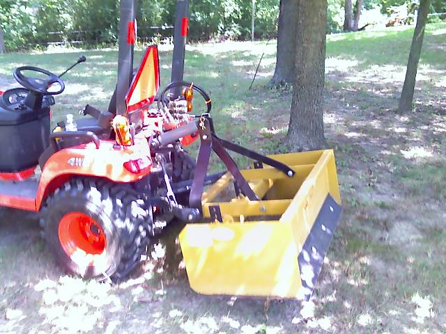

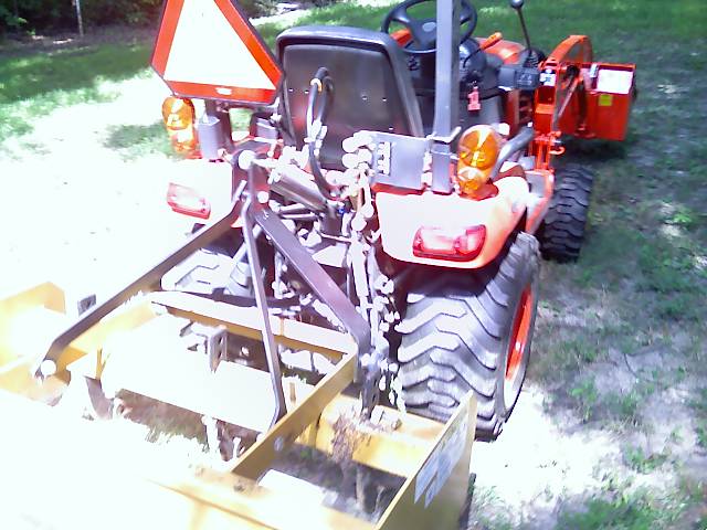

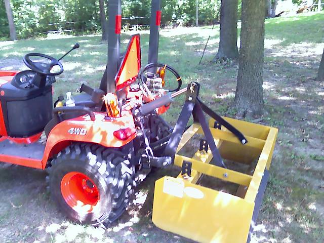

I installed my new CCM top link cylinder a couple of weaks ago. I have to say that a hydraulic top link is the way to go when using a box blade. Adjustment at you finger tips brings box-blading to a new level. CCM is great to business with and the cylinder is of the highest quality. The cyl. I ordered is 14.5-20.5 stroke seems to be the perfect length so far with all my attachments. Here is some pics. with BB.

I made the hoses myself at work. They are 1/4" Parker hoses with male 1/4" NPT ends, the cylinder end I used a straight swivel, the QD end I used just a plain straight. Total length from fitting to fitting is 30". I changed the fittings on the check valve from male 3/8" NPT to 1/4" female NPT using a Parker adaptor I don't remember the part number for this but the threads in the vale are SAE-M (I think). The QD's I order from Snap-tite's web site. Part #72N4-4F they were $5.87 each.

I used Teflon-tape on QDs only, I put the tape on the male pipe threads one thread back from the end and 2 wraps of tape. All the other fittings are flared or o-ring they do not require any sealer.
Crows feet are open end wrenches that attach to a 3/8s drive ratchet extension. Line wrenches are kind a like a box end wrench that is open enabling it to slip over the steel tube and grab the fitting allmost all the way around makes for a firmer grip on the fitting compared to a standard open end wrench. You can find them at Sears. I ended up using a combination of both, plus standard wrenches and line wrenches.

The link is 14.5" retracted and 20.5" extended center to center. So far it has worked well with all my impliments. Only the box blade binds a little when fully retracted with the three point fully raised, extend cyl. just a little and no interferance.

I received my replacement link from CCM. It leaked too. :( So I cranked on the bolts to the point of severely overtightening - All Better!!
I still had the binding issue at the tractor connection when attempting to raise the 3pt all the way up. I reversed the link and it would bind against my Quick Hitch. Also, when raised all the way up, my quick hitch would hit the hydraulic lines as they came out of the rear ports.
I ground the quick hitch to remove the interference. It now works. Also, I added 90 degree connectors at the port-side connection.

Crossfire190 what length cylinder did you end up getting? I have problems with the hoses hitting the back of my seat when fully raised. I just make sure that the cyl. is cocked to the right this seems to take care of the interference problem.
