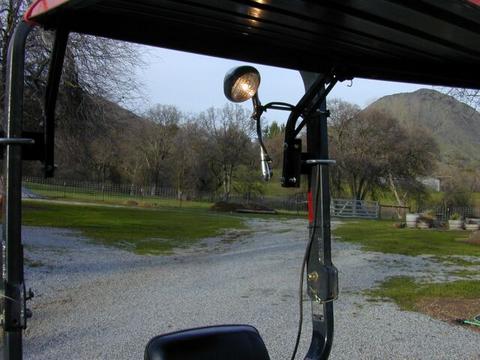

Yup, the BX2350 and BX24 now have the full alternator as standard equipment. I added 4 lights to the ROPS, 2 facinf forward, 2 back. I attached them using stake pockets I bought at Tractor supply and a little foam between them and the ROPS. no drilling. I posted it as a project here some time back...a decent search might find it. Also follow the link in my signature for a couple pics. I would recommend that you use the fogs only facing back, theres a lot of glare from them if you face them forward. I used regular trapezoids I bought from TSC for forward. Tied them to switches I mounted in a watertight box that I attached to the rops where the hazard triangle goes...used some wiring mold to cover the wires. Works Great!!! :)

I used the under seat wiring on my 2350 and mounted the lights to the ROPS using similar magnets from Northern Tool. I wired a 4 prong trailer harness (only using two wires of course) inline with the lights. Out of the way and still a quick disconnect.
