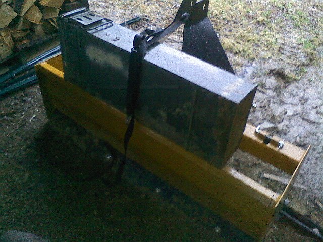

Sorry about the phone pic... but this ammo box cost me $15 at a flea market and it holds about 300lbs of lead in the form of wheel weights that I melted down and poured into forms.
It would be compact weight for you if you rigged a way to attach it to your 3ph. It's just sitting there btw, I set it up there yesterday for a test, but that little strap isn't going to do the job.

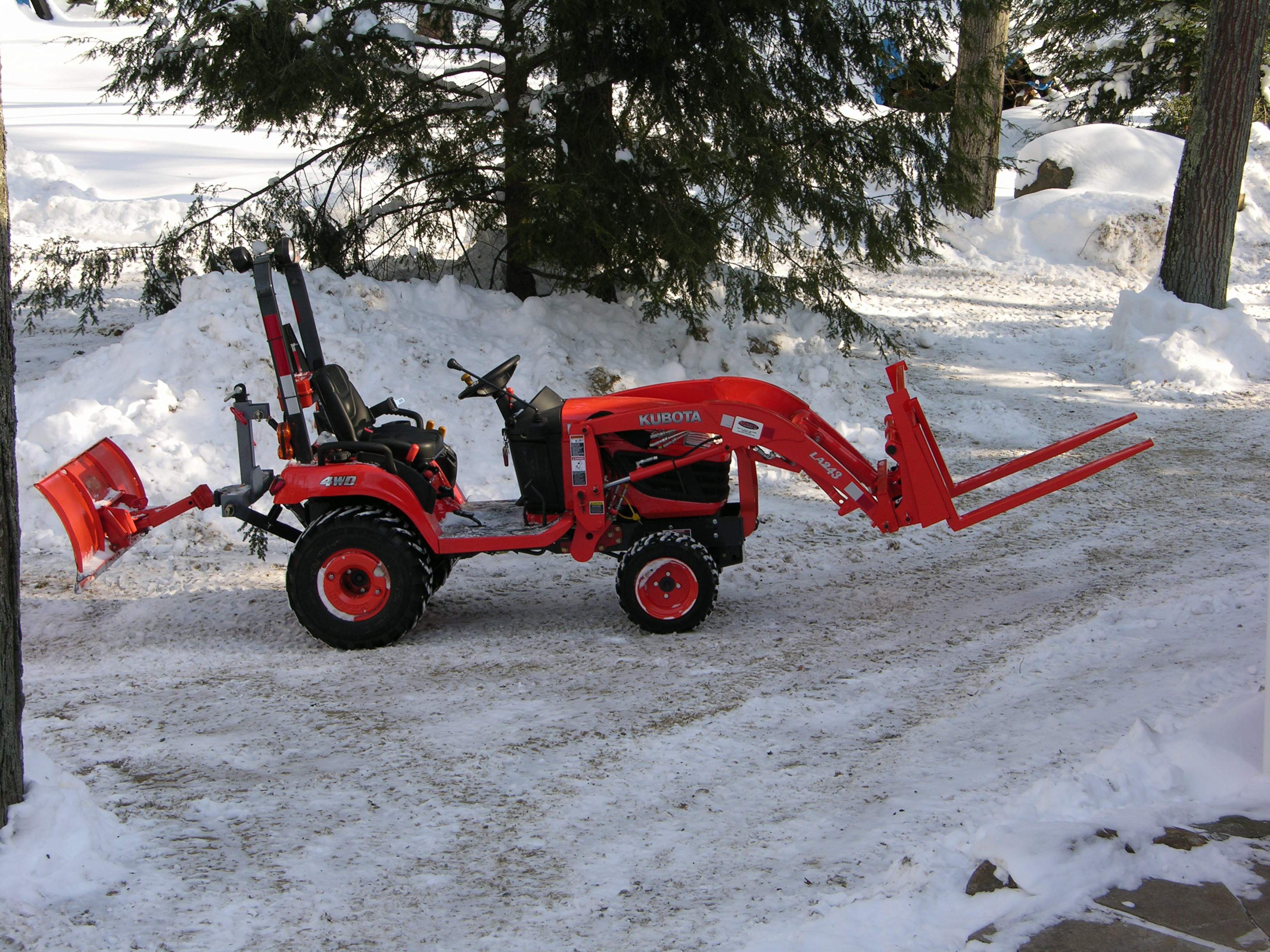

I have foam filled tires as well as wheel weights. between foam and weights four hunderd pounds. but I can put six hundred pound on the forks and not have a problem. the rear end does get light. but if I need ballast I can added more to the 3 pt hitch.
so the better you balance your tractor the safer it will be and less pucker time.
