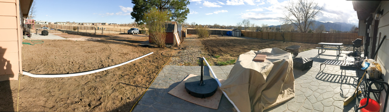

I bought the BX2370 predominantly to build / rebuild a bunch of privacy fence. Thinking post-hole digger and a powered wheelbarrow. Also wanted to address several landscaping / deferred maintenance issues.
It's been great in that regard. Discovered a bunch of uses for it that I'd hadn't anticipated. Also realized some things are a lot heavier than I would have guessed. Weight matters.
Wishing it could lift more, I'd been glancing at specs and comparing the 518lb (500mm, max height) on the BX2370 -vs- 948lb (pivot pin, max height) on the B2601.
Got me thinking I could get nearly twice the lifting ability for not a lot more money. I finally wrote some numbers down so I could see things side-by-side.
Not as much difference as I thought.
