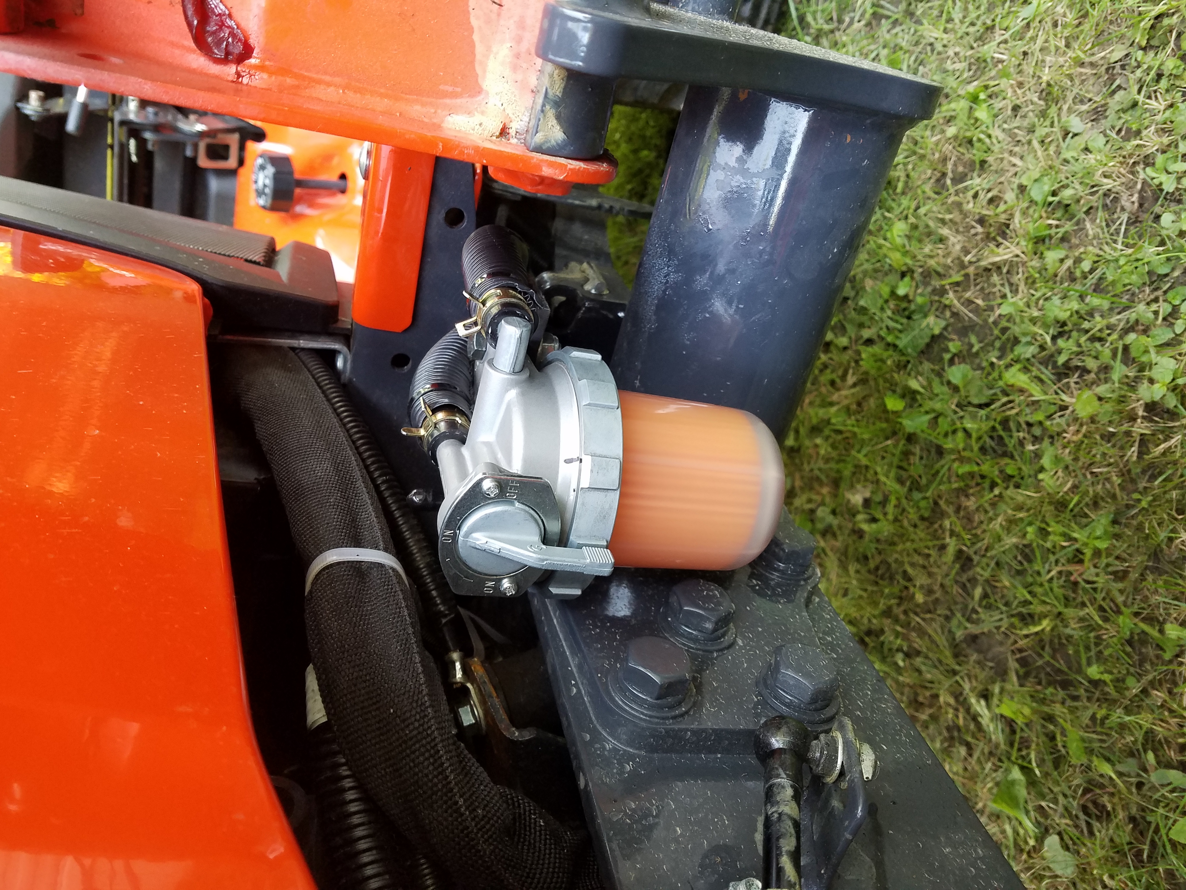

If you`re referring to me, mine is not glass, its plastic.
As for the bowl getting hit, no, i`m not concerned about it, i built a heavy duty metal guard that protects the bowl.
The filter looks great. Do you have a picture of this guard yet?
Thank you...!
Unfortunately i dont have a picture of it yet, as i didnt like my first guard, so i`m making another one, then has to go to powdercoat shop.
When i get my updated guard finished and mounted, i`ll post a picture of it.

Please do... been staring at my BX for awhile now and contemplating how I might fab a guard.
/ BX23S - Should i keep the fuel filter
#64
Will do dragon... it`ll be awhile, but i wont forget ya.

I`m building it to swing out of the way to access the filter assembly.
The material will be 5/16th plate steel, hinged with a spring loaded locking pin.
I`m looking to utilize the 2 large 22mm FEL frame bolts just ahead of the filter to mount the guard.
Some people build their guards and bolt them on, i would like quick & easy access.... time is not my friend.

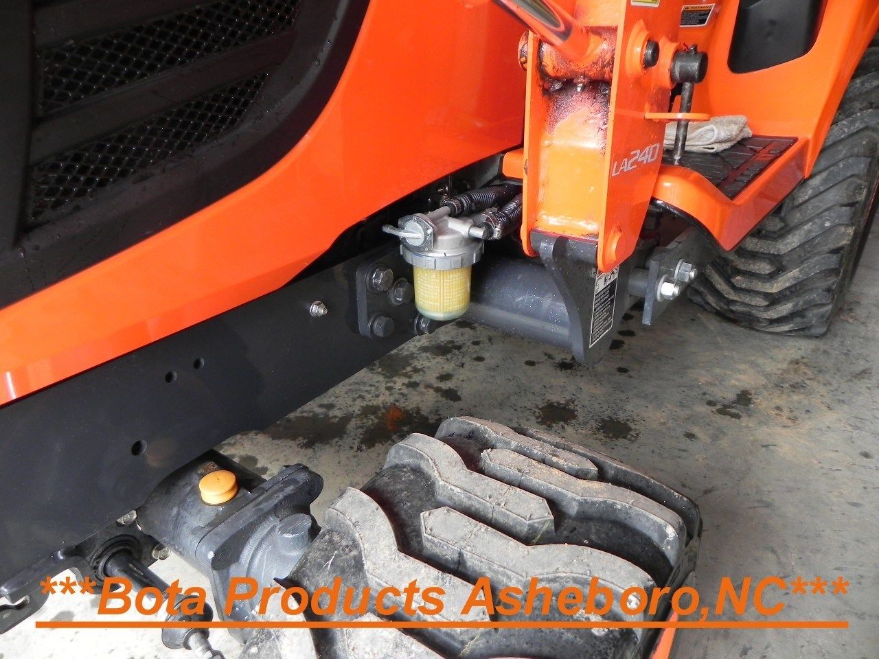

Ron,
your right, your dealer has no idea because i bought the complete kit off from ebay for $175 (ebay name: botasandy)
The folks i bought the kit from actually build the kit... The filter assembly itself is genuine kabota item and the dealer can get them.
The filter assembly is actually made for the M5700 kabota tractor #15521-43015 (costs around $50 to $60 just for the filter assembly)
These folks make up all the correct hoses`s & brass fitting`s to do the complete install. Their work is absolutely stunning.
They send VERY detailed instructions on how to install it. It also comes WITH the special built mount to install it on the BX tractors.
I will try to post it in here where i bought the kit.
Kubota BX Fuel Filter relocation kit BX237,BX24,BX25D,BX23S FEL L24,L243,L34 | eBay
This kit DOES come with only one filter cartridge, the cartridge itself is only $3.90 when you buy one from the kabota dealer.
I just got one of these kits last week after it being out of stock. The price goes up every time they run out; I paid $189.95. Just installed it today and it is a well-designed kit. However, I was unable to route one of the fuel lines through the HST driveshaft tunnel per the directions, so it loops under the left frame rail which I'm not real happy about. But, I used plenty of zip ties to try to get it up out of the way and it won't be in the way of the MMM. I also had to grind the mounting bracket for the filter itself so it would sit level. Fired it up, ran great, then quit. Oh, great. Churned it, and then realized I'd shut off the fuel shutoff on the filter. Turned it back on, let the fuel pump fill it up, and away it went. Time will tell how it works out, but after seven years of BX ownership I'm not unhappy about not having to change that little filter under the tractor again.

It WILL go thru the tunnel, but its a bear to get it thru there, there is only one small space for it to go. Yeah i see the price jumped $10 higher than what i paid, but regardless, its well worth not having to deal with that tiny filter under the tractor, especially if it freezes any water it catches in the winter. Biggest 2 reasons i bought the kit; 1)can see water in the reservoir quickly and remove the water 2)wayyyy easier changing out the cartridge than crawling under the tractor.

Well, routing the fuel line under the frame rail won't work, because if when you lift the mower it'll pinch the fuel line and guess what? Back to the drawing board, I guess...

Correct, thats what i saw when installing mine. So i worked pretty hard to get it routed per the instructions.

Well, I finally threw in the towel and picked up a replacement piece of fuel line that was about two inches longer. Complete difference. Slipped into place, tied everything up, everything's good. Glad to finally have the thing installed.

Same thing happened with me too George, at first the hose was to short, until i figured out that i had run it in the wrong spot... once i frigged around getting in the right spot, the length was right on the money. So, i`m thinking you didnt get it routed in the correct location under the floor pan (???) Hopefully, if you have a mower deck, that everything will clear ok for you. There`s nothing worse than buying a kit, and then have to go chase down more parts just to make it work.
