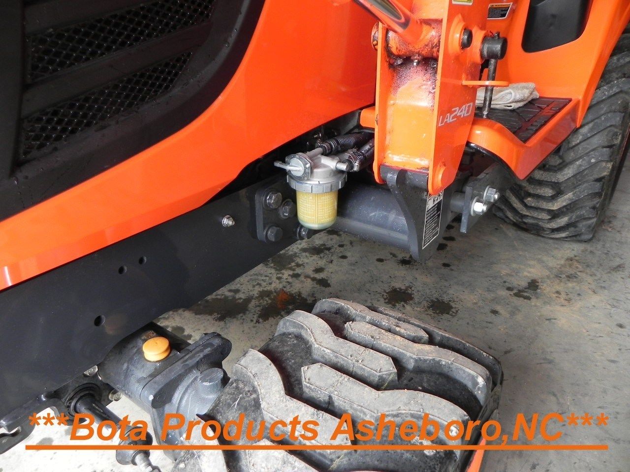

My BX plugged the rear filter 2 or 3 times, always in the winter. It didn't reallly looked gelled, I'd cut them open and they looked OK, but would be almost 100% plugged. I installed a Racor but the kit posted above looks nice. I spent a lot of time getting mine hooked up and mounted. Protecting the engine? A BX is probably pretty forgiving, indirect injection, lower pressures, so not a huge deal but the plugged filters suck.

Ron,
your right, your dealer has no idea because i bought the complete kit off from ebay for $175 (ebay name: botasandy)
The folks i bought the kit from actually build the kit... The filter assembly itself is genuine kabota item and the dealer can get them.
The filter assembly is actually made for the M5700 kabota tractor #15521-43015 (costs around $50 to $60 just for the filter assembly)
These folks make up all the correct hoses`s & brass fitting`s to do the complete install. Their work is absolutely stunning.
They send VERY detailed instructions on how to install it. It also comes WITH the special built mount to install it on the BX tractors.
I will try to post it in here where i bought the kit.
Kubota BX Fuel Filter relocation kit BX237,BX24,BX25D,BX23S FEL L24,L243,L34 | eBay
View attachment 513329.
Looked at the web site; where this is mounted I would rip it off in a heart beat working in the woods. I am trying to find a system I can mount inside the frame where I can install a guard or above the aftermarket skid plates.
Ron

You can get the same filter housing for about $55, I mounted the $40 B series filter on my BX2230 and G2160 using a part of a flat bracket, I bent in a vise and it is mounted on side of engine by the injection pump, with the fuel in, out and bleed return lines hooked up so it self bleeds. No brush can get to it and is easy to drop bowl and dump water out.
Cost was less then $60 each and even used Gates Barrier fuel line. Left inline filter before electric pump but as everyone knows they can pass water and that is where the B series filter traps all the water in the bowl.
Ron
I checked it too... no more presently available. I have done most all of my woods work. Probably could fab a shield if you think it necessary. Having had to replace the lower filter twice in 200hrs, I like the idea. Probably time to replace the lower one again!

Ron,
No rules apply to mounting it, as you can put it where ever you like, as long as it sits lower than the fuel tank.
You could make a shield to protect it too if your handy. I work in and around big rocks and dirt everyday,
havent had an issue, and i dont even have a protective shield around the fuel filter assembly.

Dragoneggs,
They`ll have more kits very soon. I personally know these people that make the kits, you`ll get an outstanding kit from them. I do know they are on vacation for a couple weeks right now, so check back with their ebay auction. I know once you see their kit, you`ll be VERY impressed. Super nice people too, they stand behind their BOTA products. If you ever need help or have a question, they are right there to help you in a heartbeat, but i doubt you`ll need to ask for their help because the kit and the instructions are excellent. They have excellent pictures and arrows (with captions) pointing to everything within the installation instructions.
Though the kit is expensive, the hard work is already done for you. No hunting down parts, no running around wasting time to figure out what you need. I will always gladly pay extra so that i dont have to fry my brain to figure out what i need, not to mention all the running around. The kit came to my door in 2 days from NC to NY.
