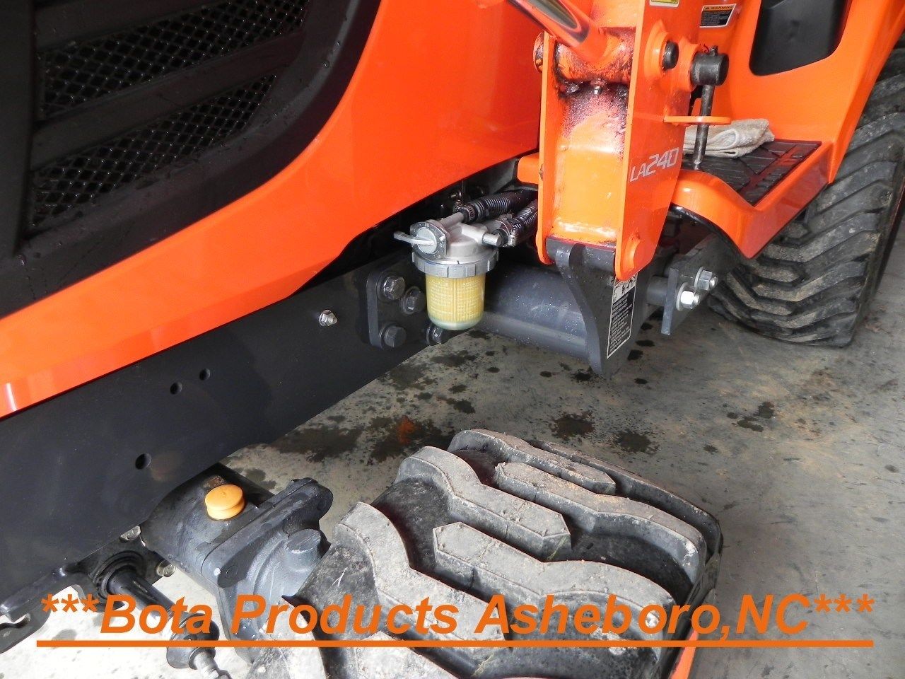

Good plan. And I would loose the OEM filter. There is no need to keep it after installing the new and upgraded fuel filter assembly.
I was thinking of keeping it in the tractor but relocate it closer to the new filter kit so that it would be easier to change out.
But the more i think about it, i dont think i really need it at all, as this new kit is superior over that little OEM canned filter.
   / BX23S - Should i keep the fuel filter #12
That is just what I was trying to point out to you. ;)

PaPow, can you provide the Kubota part# for the kit? My dealer has no idea about it. Some pictures of the kit and your install would also be nice so we can visualize the system.
Ron
Ron,
your right, your dealer has no idea because i bought the complete kit off from ebay for $175 (ebay name: botasandy)
The folks i bought the kit from actually build the kit... The filter assembly itself is genuine kabota item and the dealer can get them.
The filter assembly is actually made for the M5700 kabota tractor #15521-43015 (costs around $50 to $60 just for the filter assembly)
These folks make up all the correct hoses`s & brass fitting`s to do the complete install. Their work is absolutely stunning.
They send VERY detailed instructions on how to install it. It also comes WITH the special built mount to install it on the BX tractors.
I will try to post it in here where i bought the kit.
Kubota BX Fuel Filter relocation kit BX237,BX24,BX25D,BX23S FEL L24,L243,L34 | eBay
This kit DOES come with only one filter cartridge, the cartridge itself is only $3.90 when you buy one from the kabota dealer.
