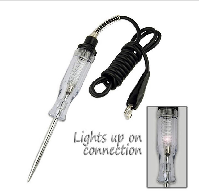

Apart from telling you to remove the ground cable from where it attaches to the engine block and polishing the cable and block surfaces to ensure a clean connection, you need to invest $10 to $15 in a cheap multi meter so you can take some meaningful measurements.
https://www.amazon.com/Etekcity-Mul...d=1&keywords=multimeter&qid=1588635353&sr=8-1
You could haul your battery to an auto supply place to be tested.
Also invest a little ina 12 volt test light

That buzzing is probably the starter relay. More than likely a dead battery. I agree on checking all grounding connections.

Charge the battery then take it to a battery shop to be load tested.

There is a much quicker/easier place to start, start so to speak,,, Just use any handy good battery/some other vehicle and jump it with jumper cables. If it is a bad battery the thing will use it's glow plugs and then start normally. If not then you have some other problem. Those symptoms ( in your very good You Tubes) are a little strange (NOT like the common BX series failure to start issue for lack of good 12v at the solenoid trigger) so I vote for a dead battery.

Not necessarily so. Ive tried starting a dead car battery by jumping, and I got nothing until I let it charge while other truck ran for about 15 minutes, and still it did not hav3 a strong start. It might take some time to charge dead cells. Better to swap out to a known good battery totally.

A lot of wasted effort until you have at least tried a simple jump.
