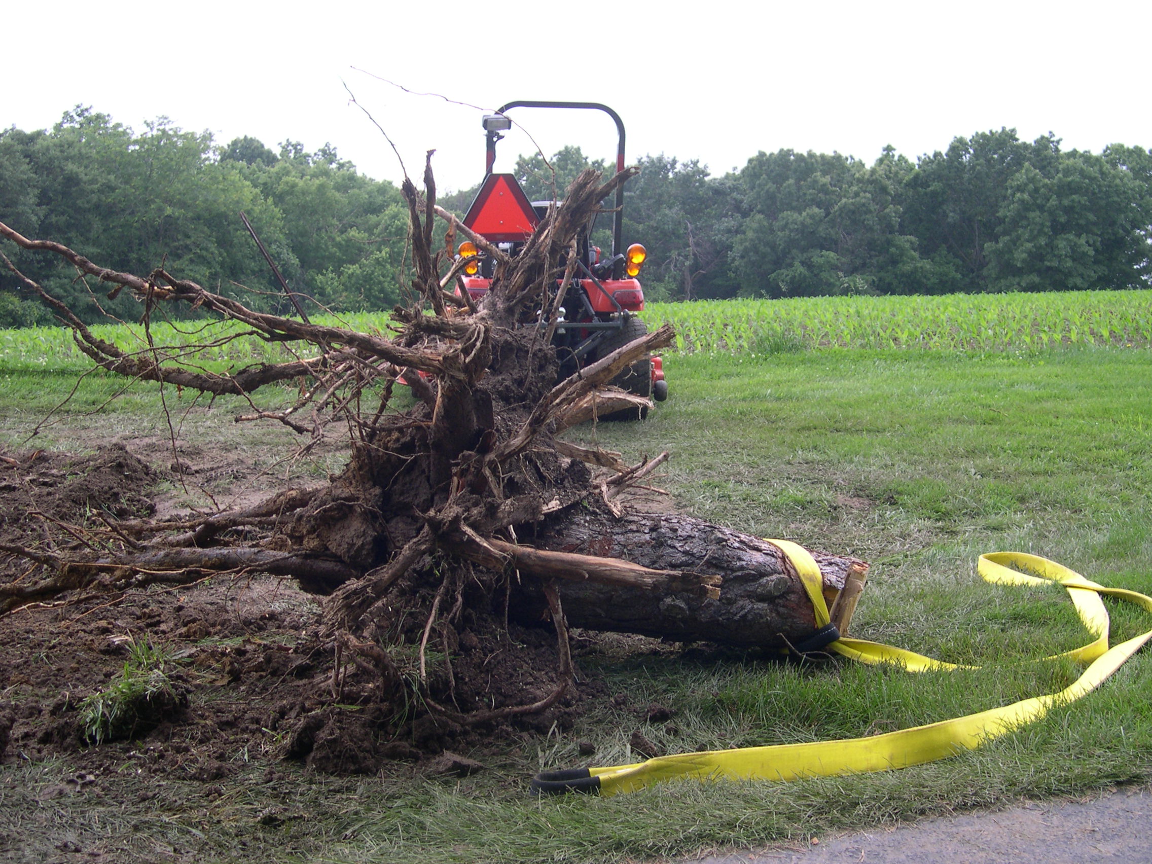

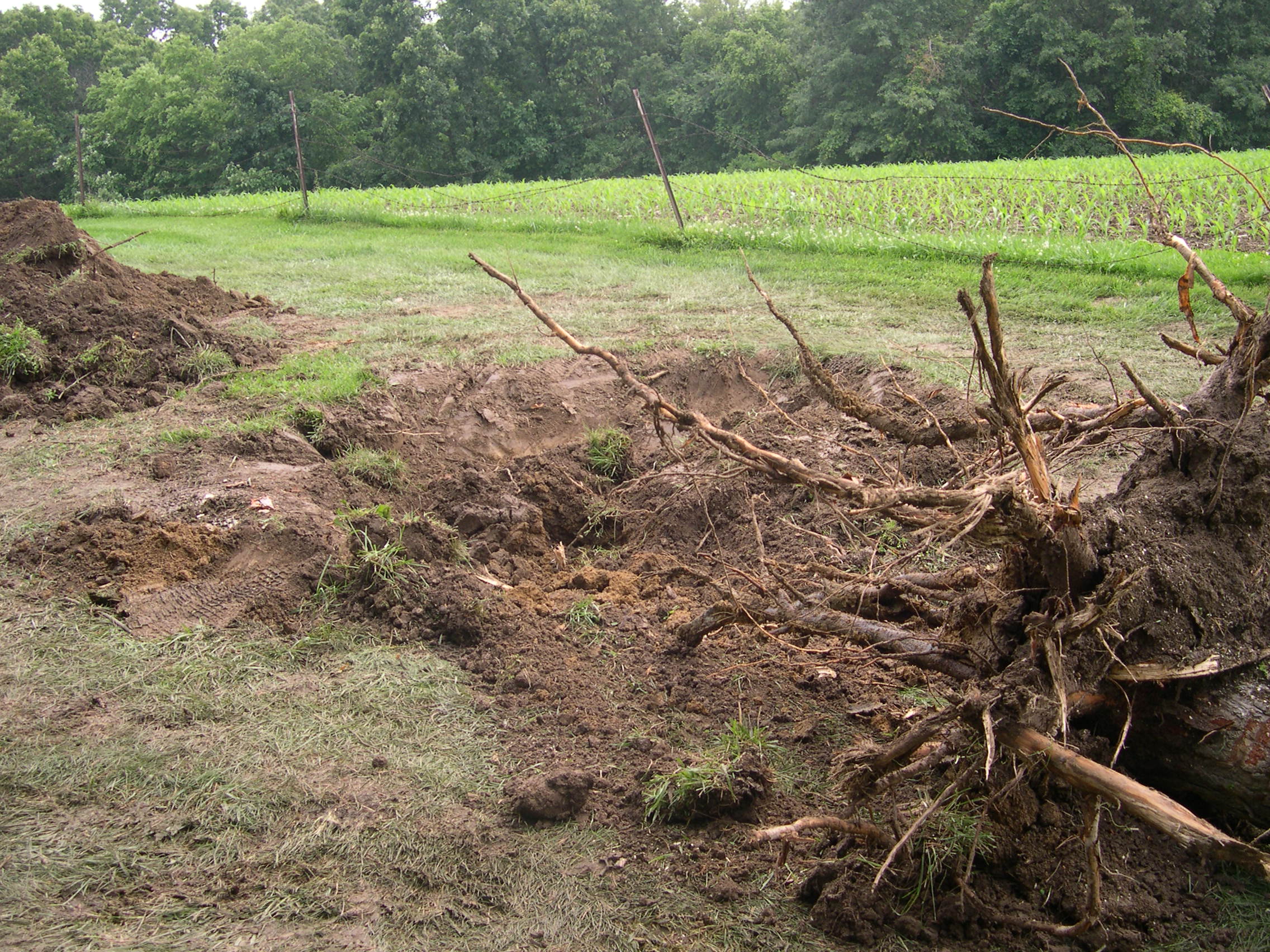

Here are some pics of the stumps I removed in May 2008. The clump of stumps were a large cherry tree and also a tree of heaven. I hate those tree of heavens, they are an invasive species and grow worse then a bad weed!
Took me a while and also even used a come a long to tug on the whole mess.....

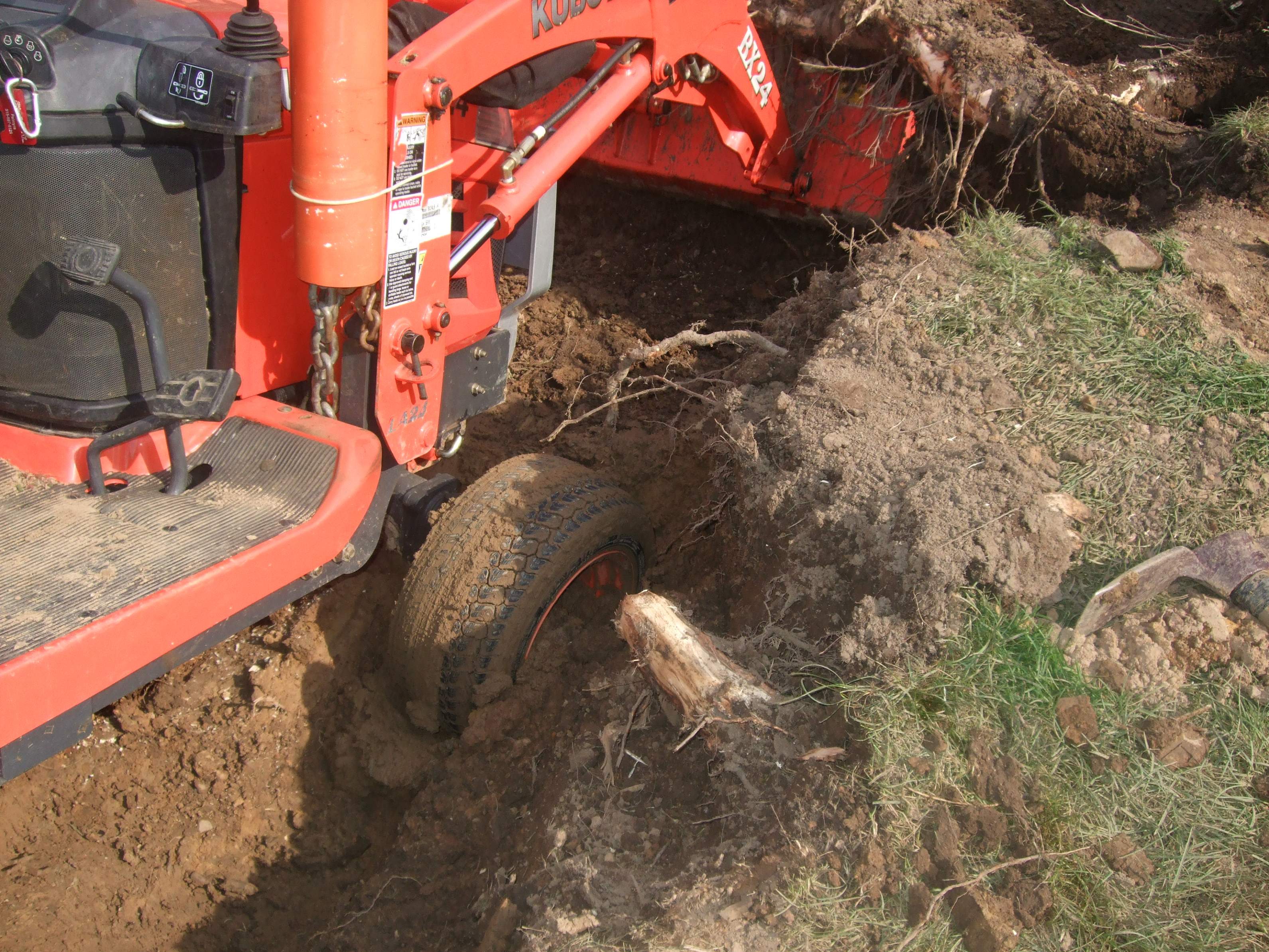

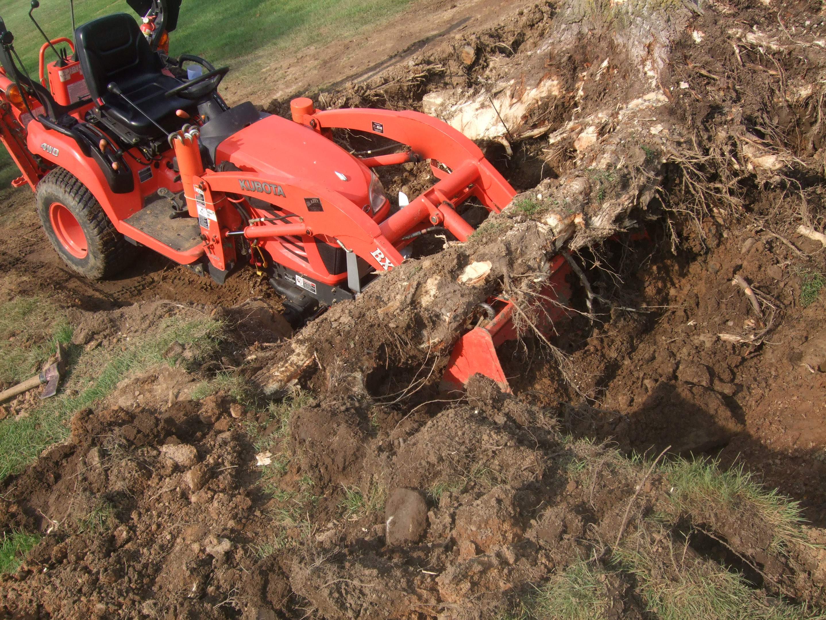

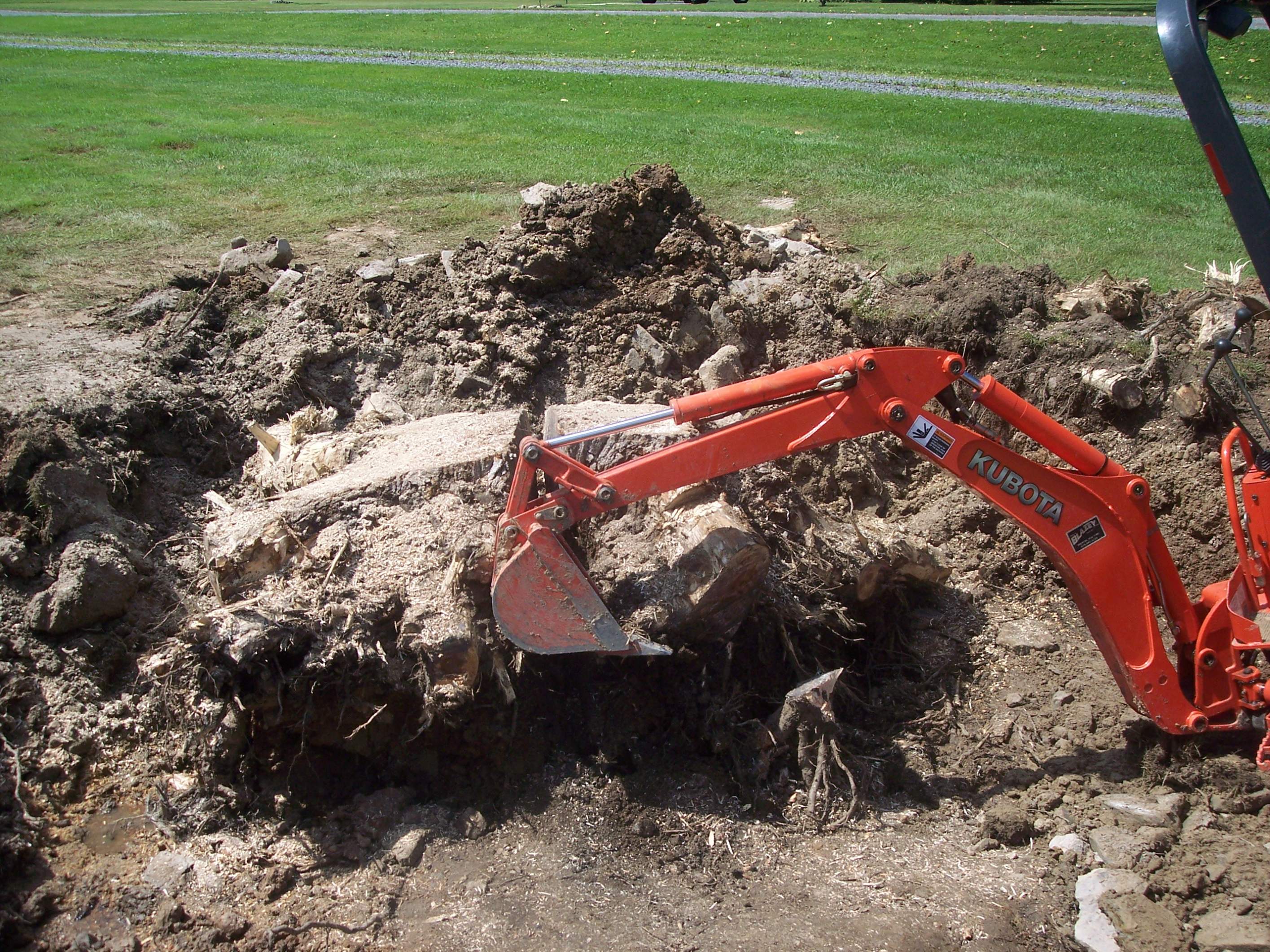

:thumbsup: victory!! stump done and over with!! After cutting stump in half as much I could before hitting dirt, I ended up using bucket to crack it open. I was able to flip both halves unside down and use BH to scrape all the sticky clay off the bottom of stump and now its soo much lighter. The FEL could barely curl one half of stump, so ended up driving backwards all the way to resting place. The other half I could barely lift the stump few inches off the ground and take it to the final rest place.:)
The hole is now filled in and need to let it settle before planting grass. I am hoping we will get the rain on sunday help with settling of the dirt. I packed it down as much I could with every 6 inches of dirt I filled in.

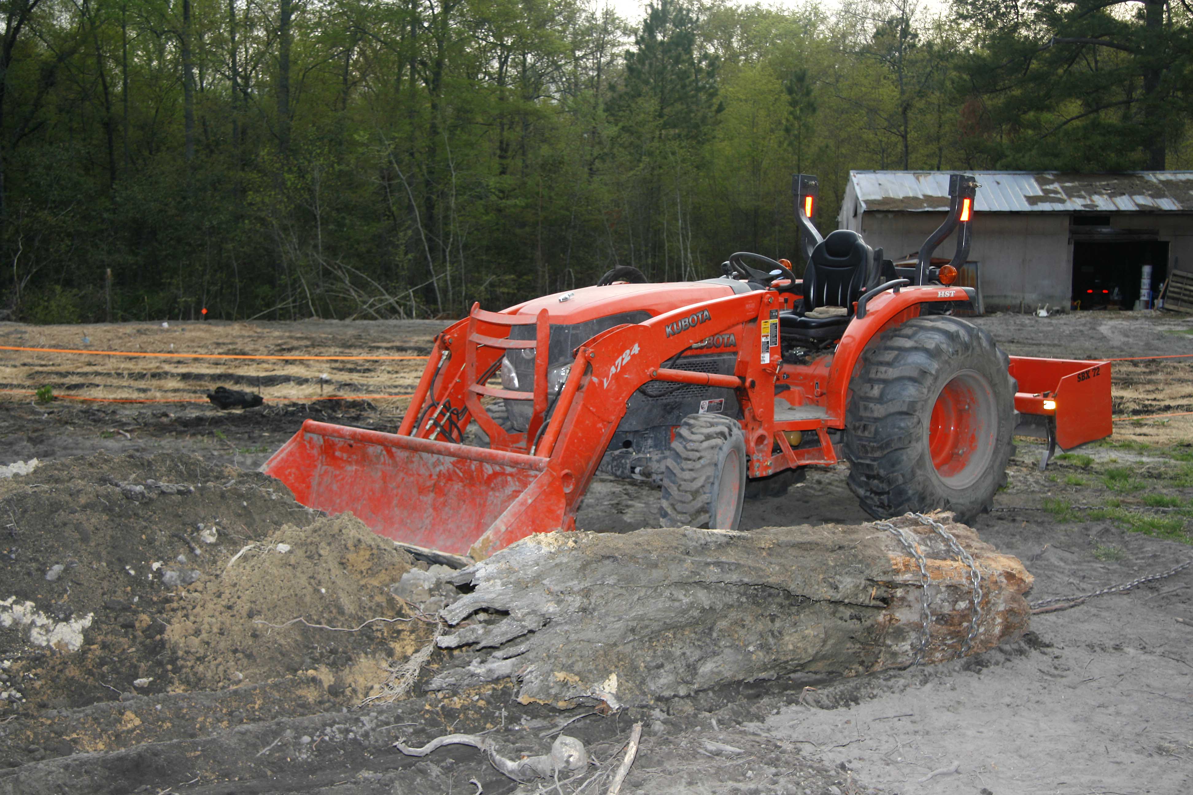

Here's some pics of my Stump Adventures.....Part of me just wanted to see how deep I could dig:laughing:
