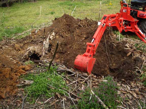

I have had it a week and I removed a 42 inch stump. This stump was all that remained after a tree fell and the tree company wanted $1,500 to remove it all. It was about 3 foot tall. (Tree fell in a storm and I was able to handle the tree with my Stihl chainsaw but the stump was another matter). By reading some posts here I followed the technique of digging about 3 feet away from the stump all around and then going in closer and digging some more. It took about 3 hours of digging and then about an hour of levelling after burying the stump in the hole I dug.

That stump is already partially removed (out of the ground). The one I removed was a bit wider, and still in the ground and it took about three hours. The tree had cracked at about 4 feet above the base (it was one of those double trees). Less than two hours for your stump I would say, after you chain saw the tree off of it. The tree itself will be the bigger problem. The tree will take you a day or two depending on the size of your chain saw and your energy! At least it took me that long. My tree also had my daughter's tree house in it (not attached to the tree but fell with the tree) and that was a lot of treated wood to dispose of .
