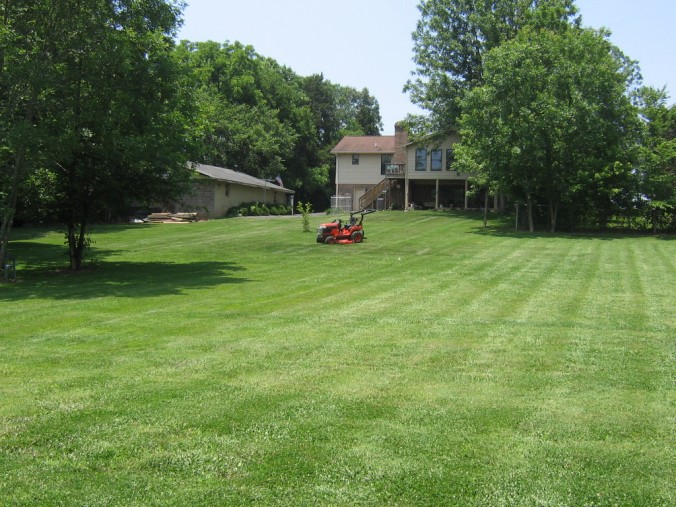

Frank, Are you happy with the way your 60' deck cuts on the BX? Keith
Not Frank but I've been finish mowing alittle over 4 acres w/a BX23 & 60" MMM going on my 4th season and I find the finish quality to be as good or better than any of my previous L&G and lawn tractors. I'm using gatorblades now which has improved the cut and shreads the clippings finer than the OEM std blades. The OEM blades did provide a good cut also btw. When asked, I recommend the BX w/a 60" MMM :D

I've had no problems todate towing my BX23TLB on my little used 6x12 3500lb single axle trailer for short distances (15 miles and less). If I were to regularly tow I'd go w/a minimum of a 6x14 7000lb dual axle w/electric brakes.
