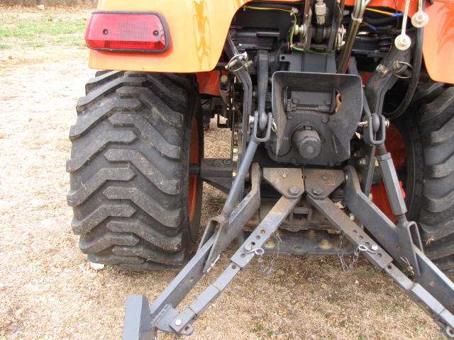

Here is a pic of my QH, the holes are 2 1/4" higher so I get 2 1/4" more of drop.

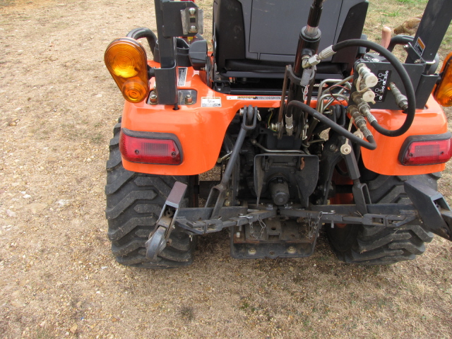

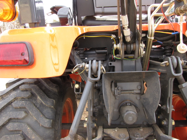

I'm going to post some more pictures in the next post and try and show you what I had to do to make everything work the way it should.

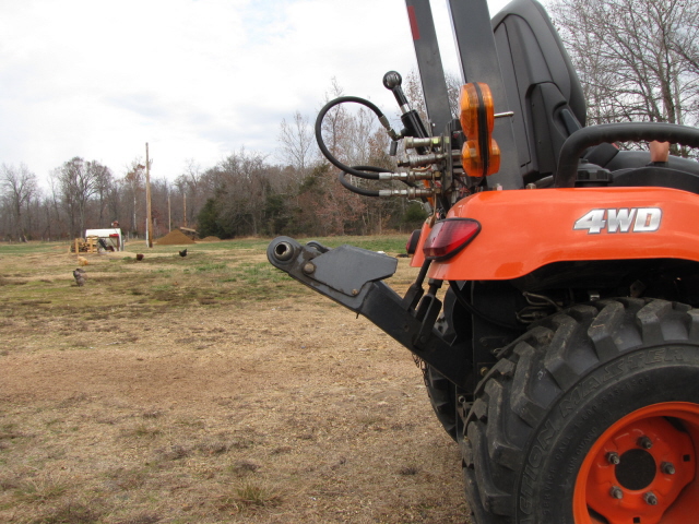

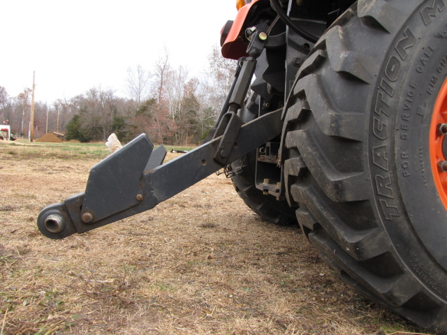

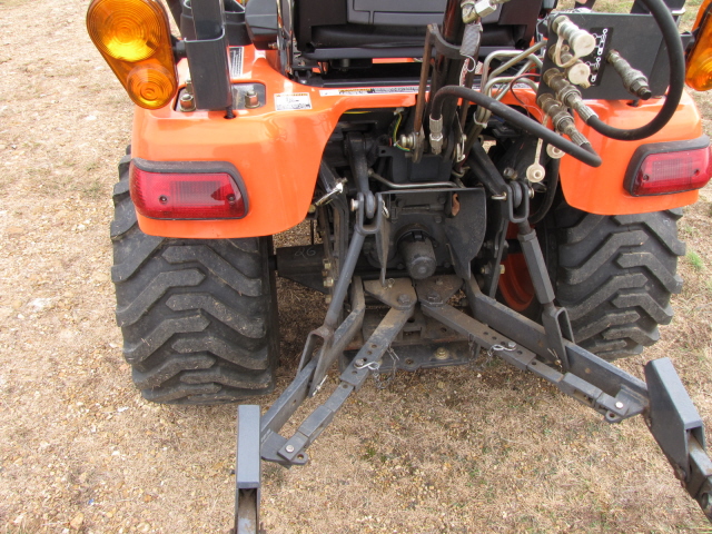

In the 1st pic. look at the left arm and see the U shape part of the lift link. It's right in the middle. In the 2nd pic. you can see the lower U hook up and it's right in the middle and they stay in the middle all the way up and down. You can see at the bottom where I done some welding and looks almost like the right link. What I had to do was cut it turn 180 deg. and move it right to edge of the U part. What was go on, as it went up and down it was bending both U brackets. This was done with lower link arms 26" apart. That is what a std. cad 1 hitches should be. As you go up and down now with yours the lower links want to move in and out without anything on them. Maybe with the check chains it's OK. Good way to tell if it's trying to lockup, see if you can move the lower links side to side when all the way up. Mine moves.
Hope this helps or give you some ideal what to look for.
